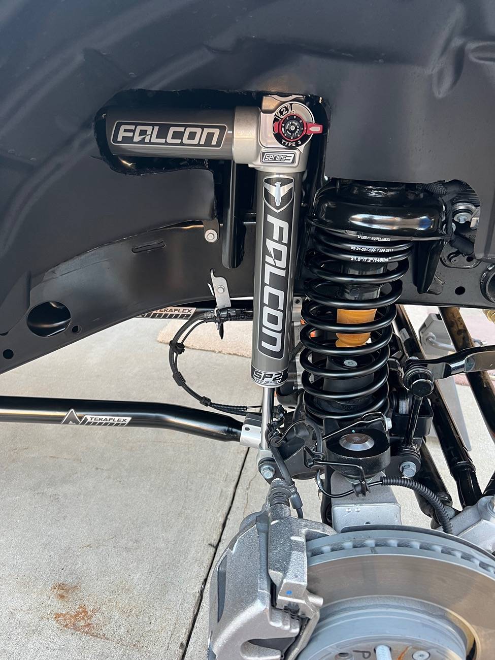

Yes!!!! on one of our Jeeps we run Teraflex Falcons and Teraflex long arms and we are 100% happy with their customer service and performance.
I went with Tera Flex and Falcons also... have been Very Impressed with how they have performed and held up. Have had them through very narly places. 32K & 1 yr on em so far ..no complaints .
