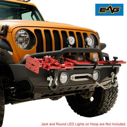

Picked this up today on Amazon $320 ...EAG version of XRC Gen 2.... same unit with Jack mounts and $350 less! @steffen707

Any idea the weight?

yeah isn't that missing from the amazon ad?
Shipping weight was 110 lbs so I would imagine the bumper is the same 81 lbs as the smitty bilt and off brand unit were... Same exact bumper.... I' ll weigh it when it arrives 7/30 and let you know.... saved enough to buy a winch!

EAG stubby front bumper (smittybilt XRC type )arrived today. First impressions.. well built and same style as the XRC... much better price! The actual bumper weight is 77.6 lbs plus about 5 lbs of hardware for mounting... 81 lbs is a good estimate.... @steffan707
