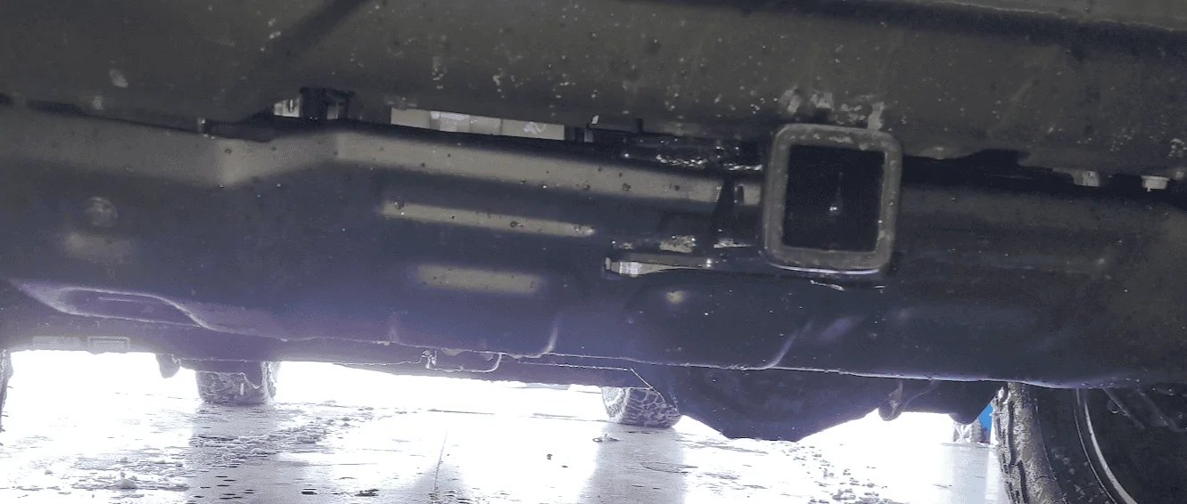

I have a 21 JTRD with the Curt one... I had to cut a notch in the skidplate... I'll try to find some pics for you.

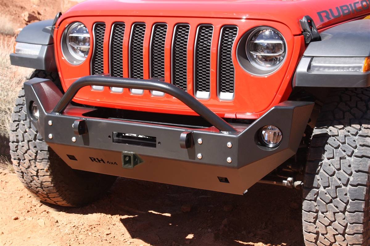

I had a similar problem with my Mojave. Ultimately went with a rock hard bumper with a receiver built in. Bolted right on super easy and had an integrated winch plate and bull bar which were upgrades I wanted.

What is the Rock hard p/n? Looked at there web site, it shows a bumper that says hitch receiver but pictures do not show it.
