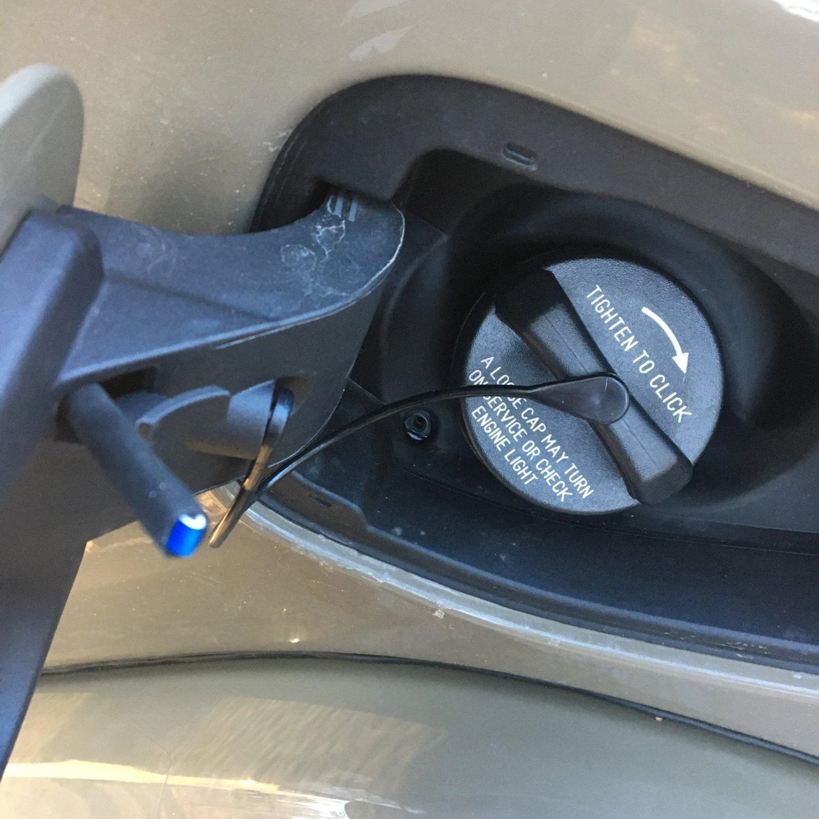

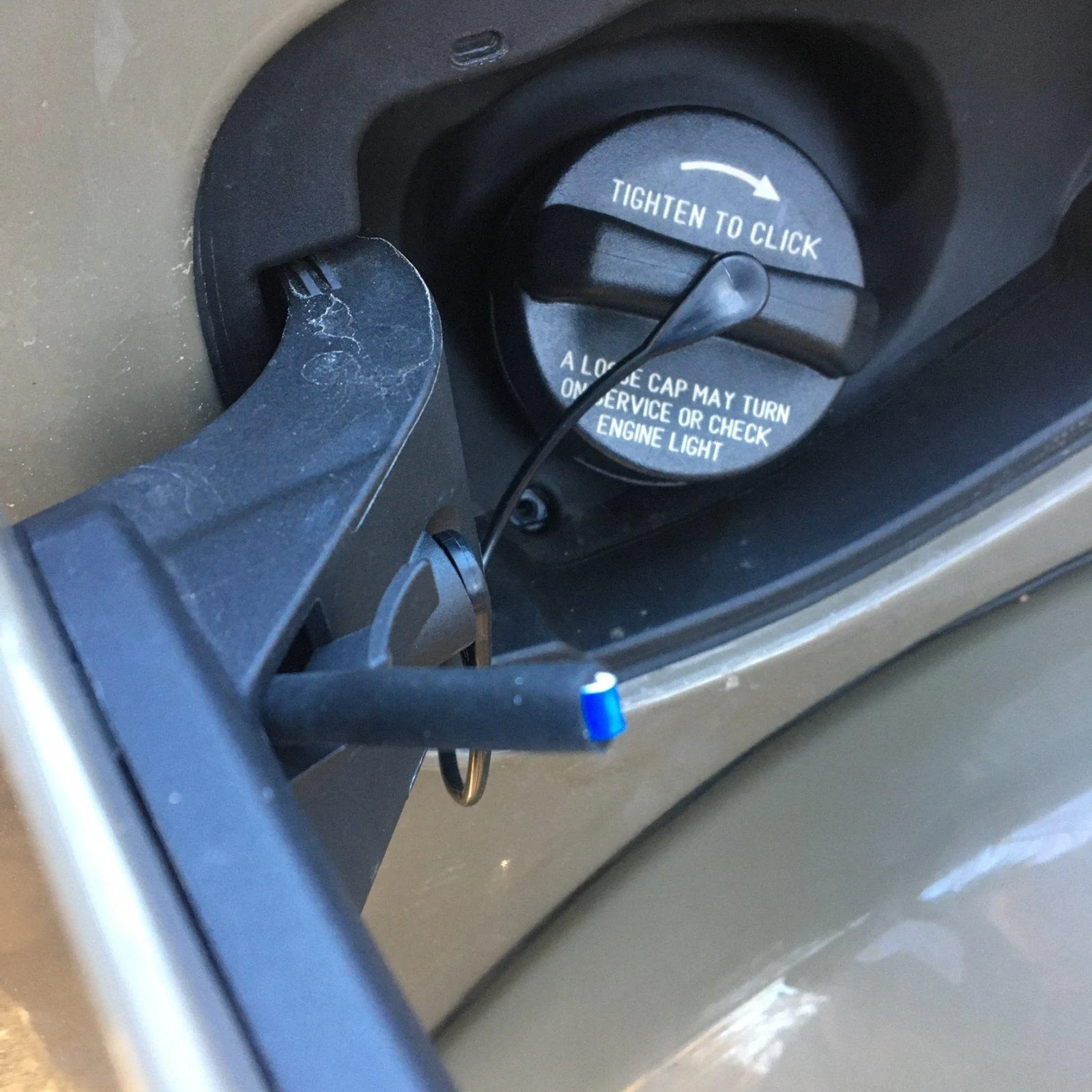

How are you supposed to hook the cap to the door? It looks like there's a place for the strap to go but it never stays there for me. On my bmw's, there's a peg on the bottom of the cap that then sits into the gas door so it's not flopping against the paint.
Something I had done earlier after installing the fender welting was to take a 6” pc of the welting, cut a pc of the hotel key I used to poke the welting into place and stuffed it into the end of the 6” pc just to stiffen it up, then pushed 4-5” of that 6” pc into the gap on the fuel filler door above the cap hanger. The loop holding the cap is too stiff to stay over the hook and tends to let the cap drop onto the fender. Now when I hang the loop over the hook I tug the welting down beside the loop, wedging it into place on the hook. No more banging on the fender!
But I like to bang on the fender... Oh, not a guitar reference? But I'll hang the cap and let it rest against the fender.

@Gatorized Did you use Jeep's gas cap solution to jerry rig your own? Lol.
