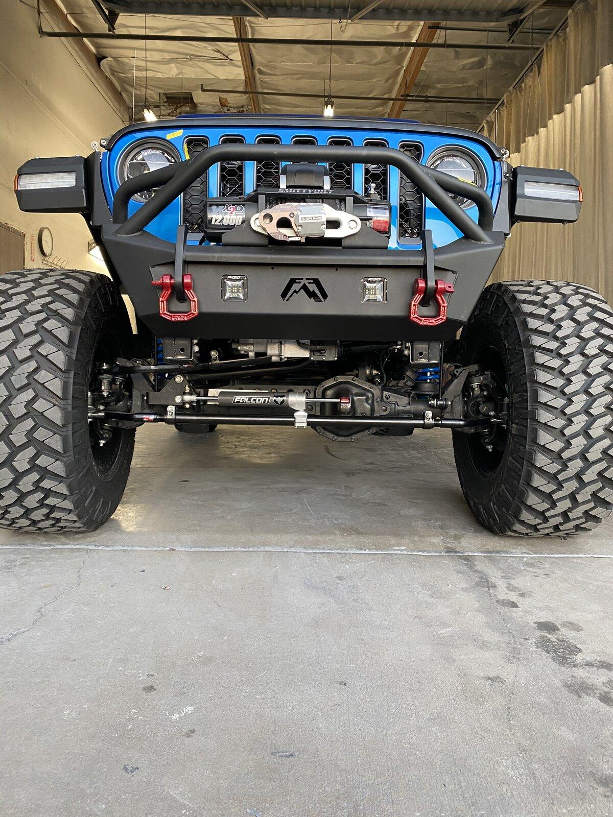

Hello All,
I have been in the diesel world before Diesels where even cool.
With that said i was a avid Cummins guy just sold my completely restored 1997 12V 4x4 to buy a new Rubicon Diesel.
My order just came in WHite Rubicon Loaded with everything you could get.
Took it home pulled all the stock suspension out and replace it with a 3.5 TeraFlex IR Full system.
Went with Nitto Terra Grapplers 37/12.50/17s
Here is my Question:
I want to regear to bring it back to stock
From what I know 373 gear needs to come up to a 410 gear to offset the 285/70/17 difference of the 37/12.50/17.
I want to know if anyone has regeared a Diesel JT or JL yet.
Before anyone says you don't need to please don't. I know to get it back in its TQ curve it needs more gear.
Thank you for your help
V/r JC

Well it's time for an Update, All is doing really well the 410s seem to be a good swap.
I wanted to use all my gears, again that is why I wanted do the swap.
I agree do you have to regear, NO is it best for the Jeep to add larger tires and not regear??
This is why I did what I did
LOL I have read through all these posting I don't criticise others for stepping outside the box and trying something new.
I have been building Diesels for years, I think I know what I am doing.
Thought we could be OPEN Minded here and post back results.
If it wasn't for people trying different things, where would we be now, Food for thought
If anyone wants to know more please ask.
I know a guy that went 456s he is happy taching 2K at 70mph,myself I thinks that's to much RPM on a diesel.
Getting ready to run down/over to Fort Bragg to se my Son, I will post some 70MPH average MPG
as of right now 60MPH is netting mid to lower 20 MPG. and we have nothing flat here so time will tell.
