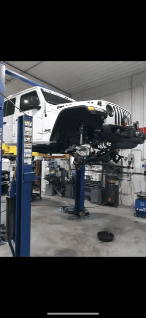

JTRD...Low 20s mpgs at fwy speed on 40s with 4:88 gears. Will swap axles in next year. Used tazer for adjustments.

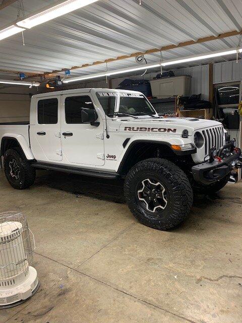

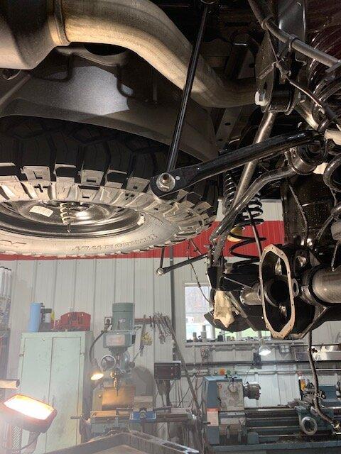

Well it's time for an Update, All is doing really well the 410s seem to be a good swap.
I wanted to use all my gears, again that is why I wanted do the swap.
I agree do you have to regear, NO is it best for the Jeep to add larger tires and not regear??
This is why I did what I did
LOL I have read through all these posting I don't criticise others for stepping outside the box and trying something new.
I have been building Diesels for years, I think I know what I am doing.
Thought we could be OPEN Minded here and post back results.
If it wasn't for people trying different things, where would we be now, Food for thought
If anyone wants to know more please ask.
I know a guy that went 456s he is happy taching 2K at 70mph,myself I thinks that's to much RPM on a diesel.
Getting ready to run down/over to Fort Bragg to se my Son, I will post some 70MPH average MPG
as of right now 60MPH is netting mid to lower 20 MPG. and we have nothing flat here so time will tell.

How has this held up for you over time? Did you swap axles or stay with this? I have the diesel with 40x15.50r20 tires and I’m try to decide what to regear to. Are the RPMs too much with 4.88 for the engine?
