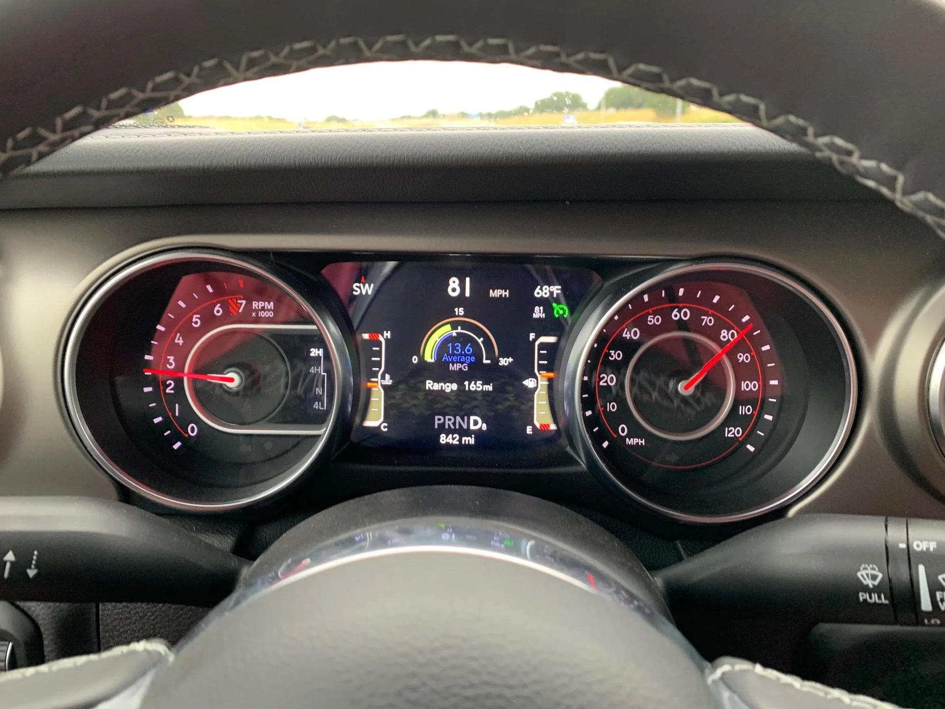

Not 75, but 81mph was around 2600rpm.... I have the Tazer and made the corrections. GPS app confirmed MPH is right on.
That is perfect. thanks ! Note: my Rubicon JT is 2500 rpm at 85 mph (4:10s) and manual tranny, so, 6th gear is .72 while the auto tranny 8th gear is .67 , so, yours is perfect. I will go with the same diff gears.
