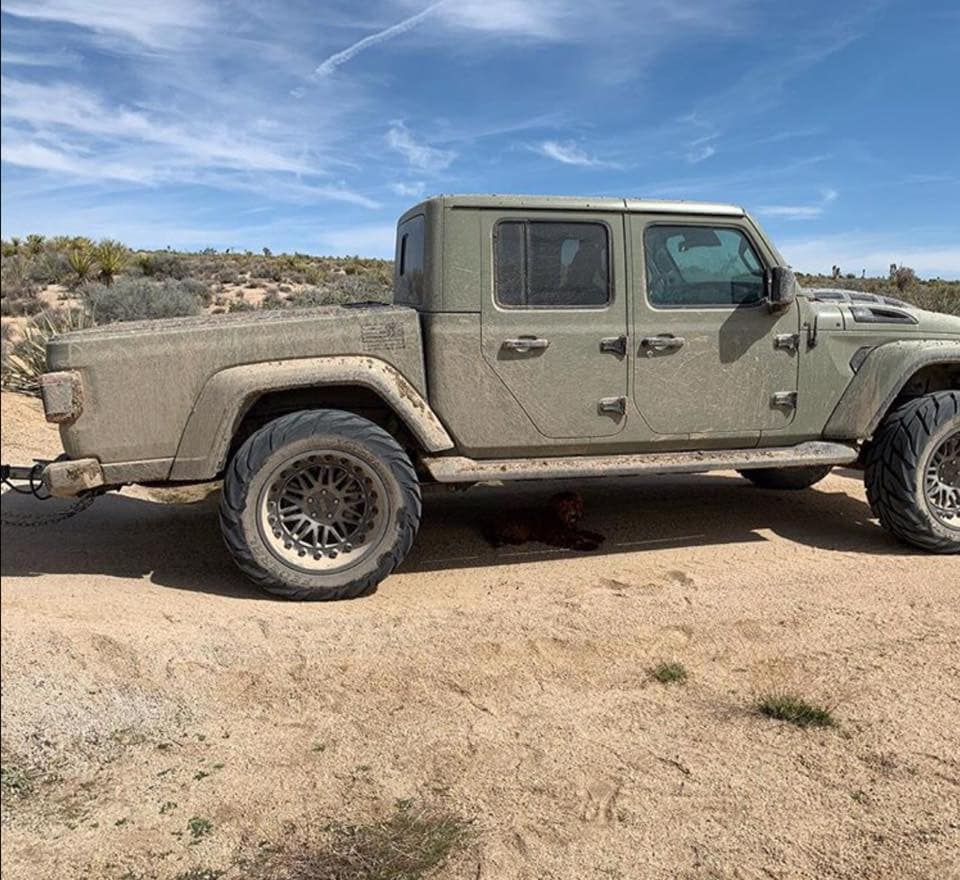

Bigger wheels didn't help any.
Looks like "Federal" on the tires - what tires are they?
Also, in this pic it's hard to tell what's going on with the hitch. It almost looks like a bumper hitch? Or maybe he could have been running an extension in the receiver hitch - can't really tell but based on the bent frame, and the wheels and tires there's likely a LOT more going on with this Gladiator. #notgladiator

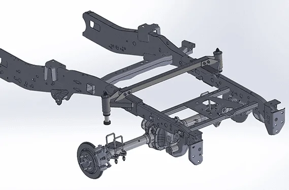

Just like with the Raptors some company will come out with a kit that will bolt to both sides of the frame rails. These worked on the Ford Raptors. They are simply plates of steel cut to the contour of the frame rails then bolted to the frame rail one kit even had a metal bar from one frame rail to the other. The install looked clean and they worked and they were not expensive, under $500 if i remember right.

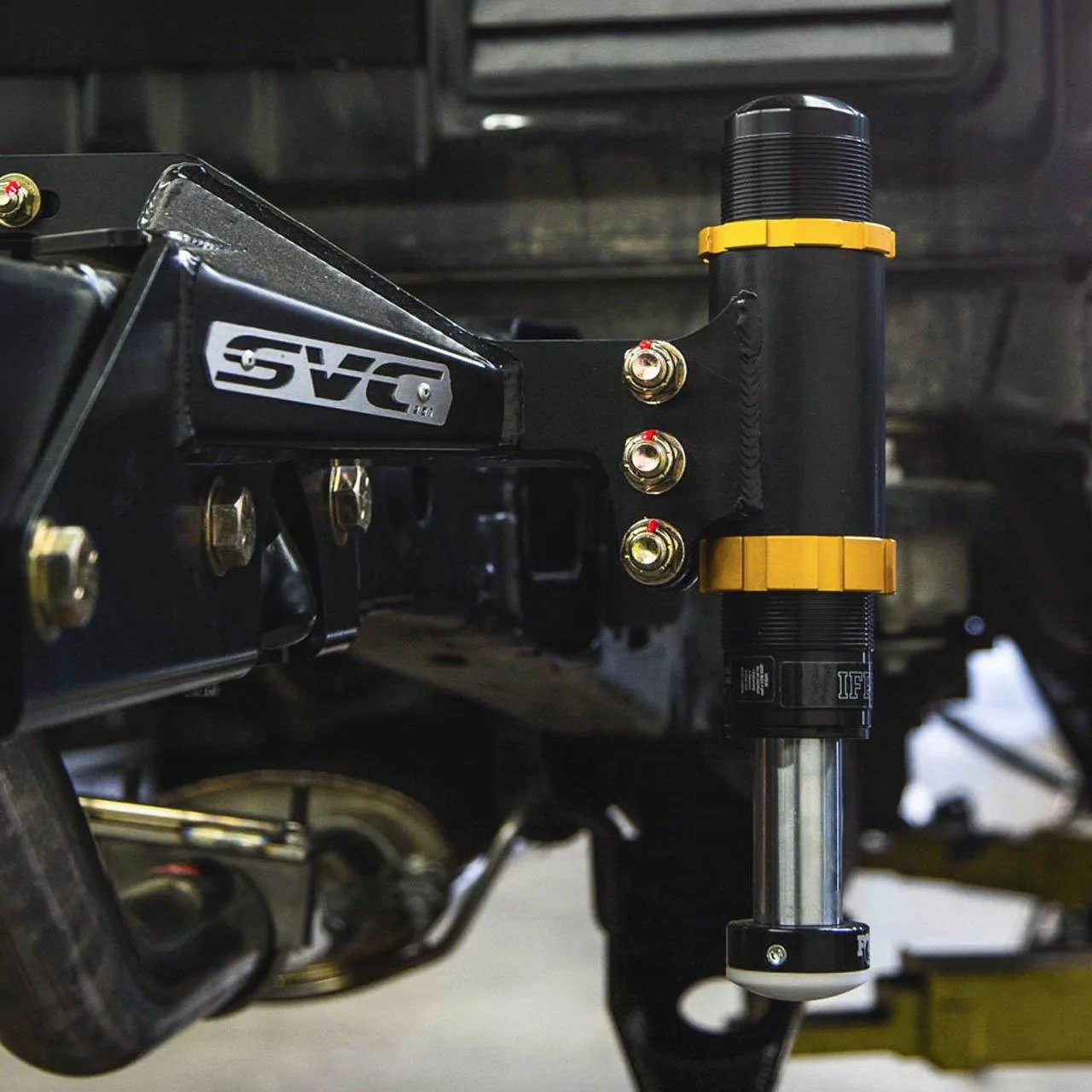

Good systems for the Raptors start at $1,000 and go way past there...

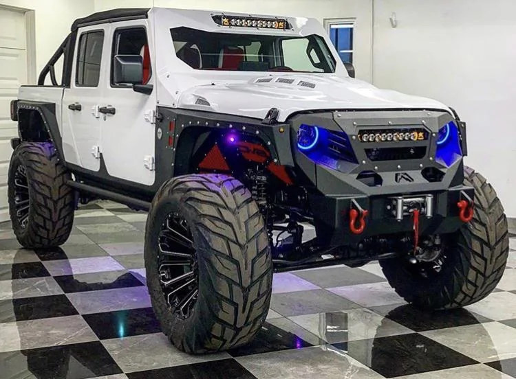

Has anyone noticed the different hood as well? It looks somewhat like the new Mojave’s but I’m wondering if there has been an engine swap or something else to give this truck more HP....
Based on the tire and wheel compo I think this JT was modified by South Florida Jeeps and that is one of there hoods. May or may not have an engine swap.
