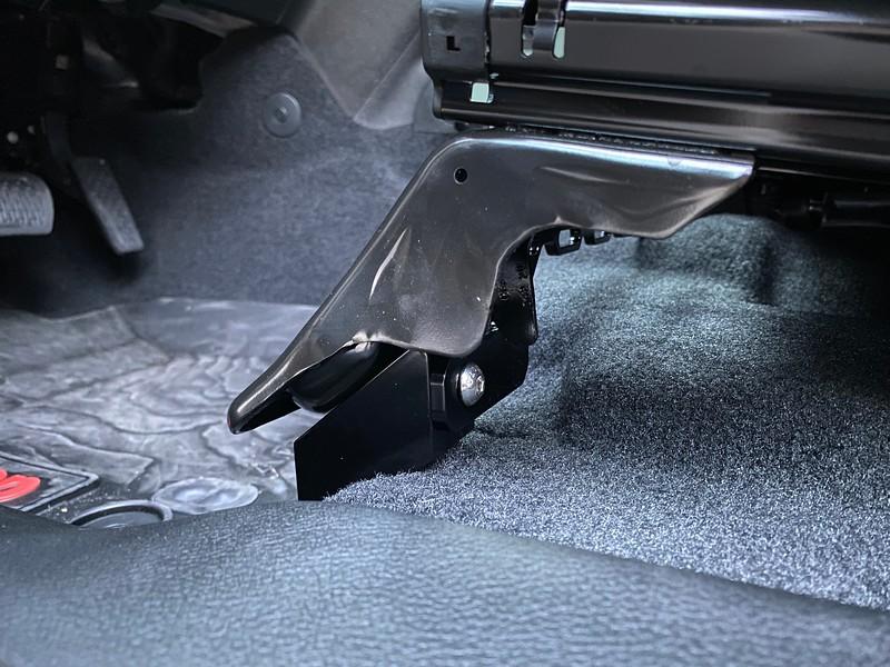

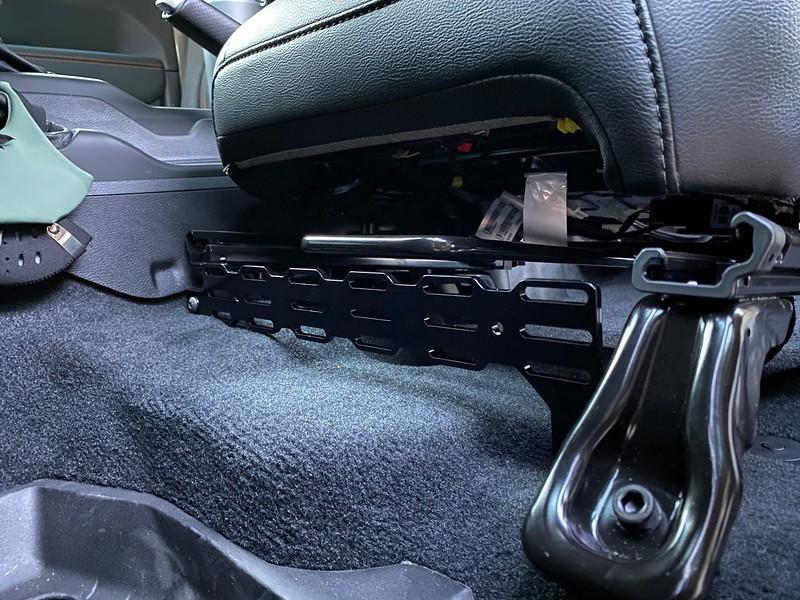

I fitted the desert does it kit this evening on my JT.
It was a bit tricky keeping the spacer blocks aligned while I was trying to torque them down into place, they kept sliding on me. I then fitted the molle panel which kept both of the blocks aligned so it was easier that way.
I do like the seat base angle now, should be good on a longer trip.
I guess I will get used to it, but it does look a bit awkward when you open the door and see the spacer block.
Just for anyone searching on this, you need an E12 torx female socket to remove the stock bolts.
