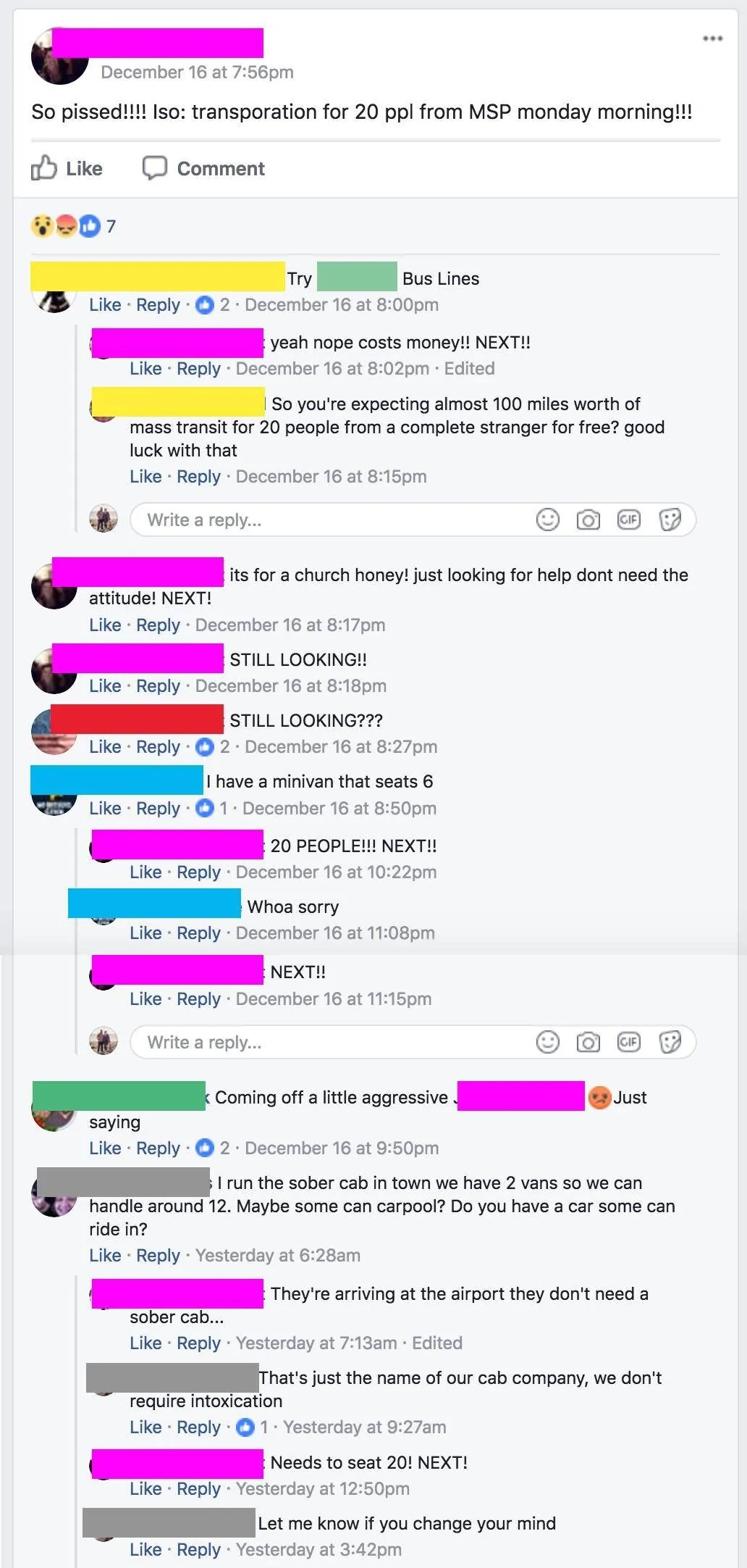

This whole thread has "NEXT!" vibes. Person asks question, people give answer, OP responds "No".
For those not as versed in internet memes as I am, here's the reference:
Jeep Gladiator Gladiator vs 1500 MPG NEXT
