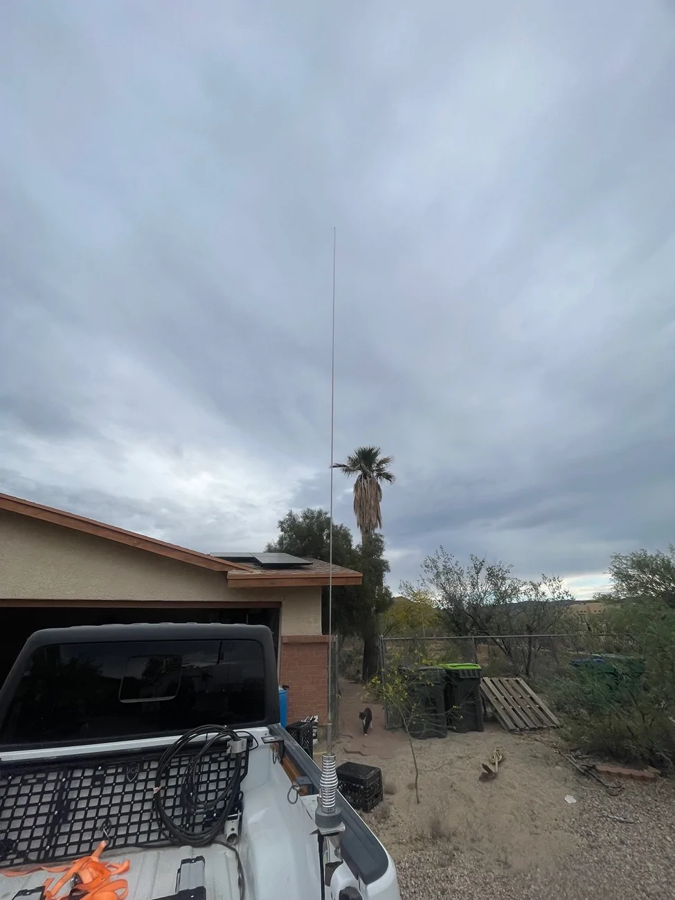

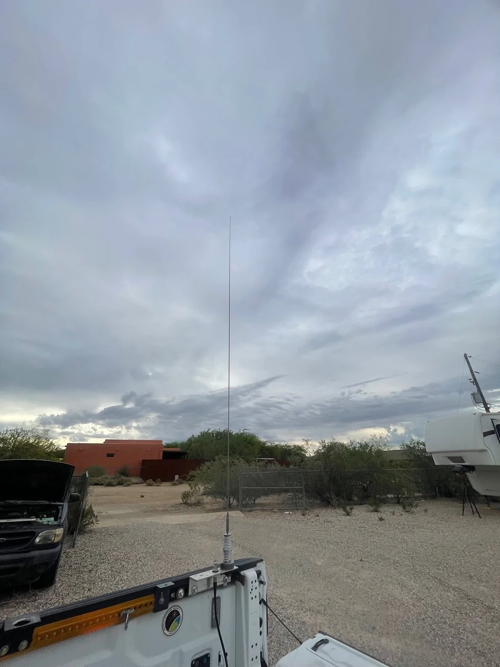

vicsvx
Jul 11, 2021
491
434
Arizona
2021 Gladiator Sport S 3.0
My group uses CB. But I carry starlink if there's an emergency
