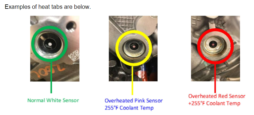

Your service advisor should really keep their mouth shut and any unsubstantiate opinion out of this. They just need to document what they found and let the adjustor for the MOPAR extended warranty come to their own conclusions.
Too bad the factory original installed OEM engines do not come with overheat tabs like the replacement rebuilds do as it would put to rest any overheat question. For all we know the engine block had a casting flaw that finally propagated to being a problem in normal use.
It is easy to be pessimistic and say they will do anything to get out of honoring the extended warranty, but I am not in that camp. If you can show normal maintenance, they should honor it.
Overheat tabs?
Hootbro
Apr 13, 2019
10,185
19,954
2025 Gladiator Sport
Overheat tabs
Installed on rebuild/reman or service designated replacements generally where the freeze plugs go. Shows if the engine has overheated and to what degree.
Jeep Gladiator Got the bad news today image004
