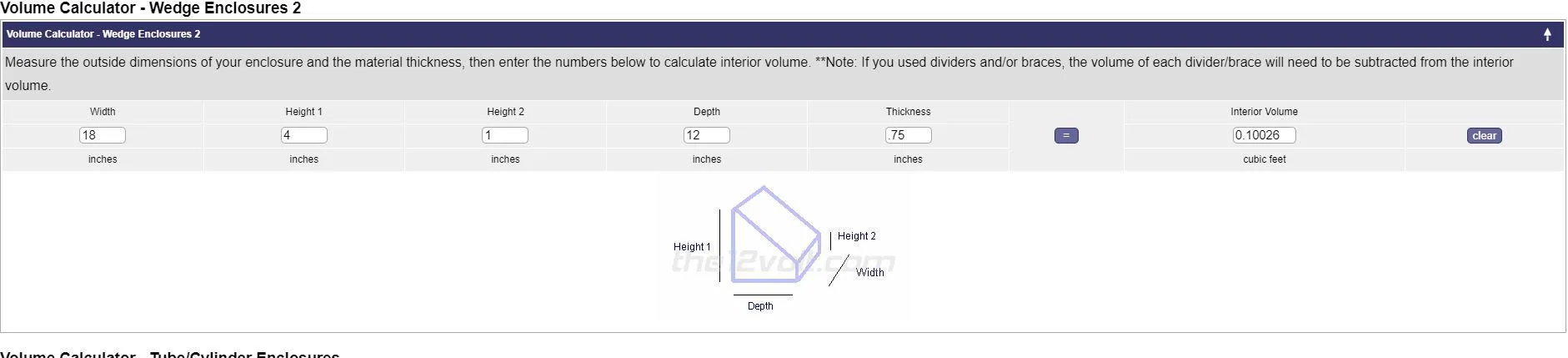

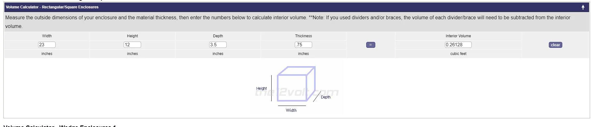

CAD is worse than a foreign language to me but here's the pic... So the blue will be a wider channel for the airspace. I plan to separate the box in the middle with a 1" channel to be able to feed/hide wires behind the amp mount. the little red rectangles are my amps, I was trying to see how they'd fit in the space between the subs.
Using these subs: https://www.crutchfield.com/p_13692188/JL-Audio-10TW1-2.html?tp=68872
running 1ohm 500watts total or 250 to each sub. https://www.crutchfield.com/p_20647KEY50/Kicker-47KEY500-1.html
The box gives me a bit more than the required airspace which should make up for bracing.
