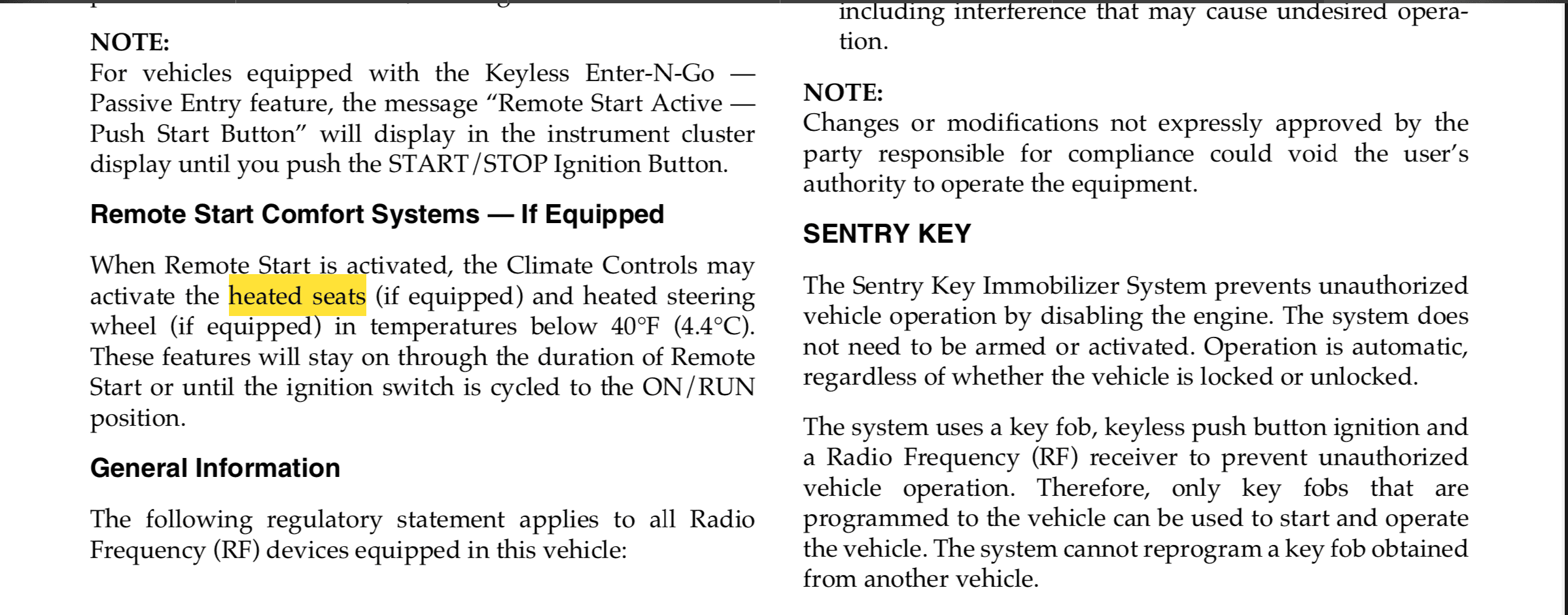

There is a setting for that in UConnect and it triggers at 40F outside. Maybe the temp sensor is faulty?
Didn’t know that but I don’t believe that’s the issue. That specifically says for remote start. And honestly I wouldn’t even mind it in that case cause odds are if I’m remote starting it’s cold outside. Etc.

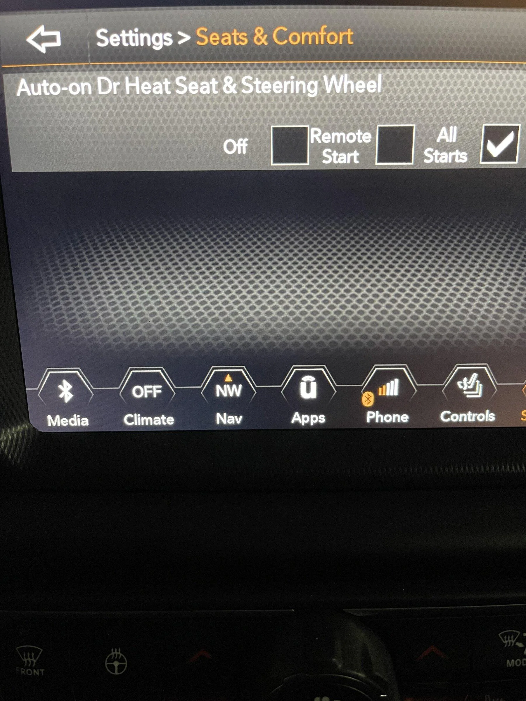

That does show for remote starts, but in uConnect there is an option under (settings>seats & comfort>auto on Dr Heat Seat & Steering Wheel) that has options for: off, remote start, all start. I'm guessing yours is on all start. I have an unheated garage in Montana and have had some cold days keep enough heat to not engage the heated seats on a remote start.

Ok at this point I’m still confused. Cause 1, I don’t ever really use remote start as I said. It does it on normal starts secondly I never changed anything in Uconnect.
update: checked Uconnect settings it was set to all starts. (Which I never set nor changed) but regardless it never did it on all starts. It was very random. I’ve turned it to off so Hopefully this works nonetheless.

This is actually one of the things that my dealer went over when I picked up my truck. The "All-Starts" setting is the default setting and will only apply if the temperature is 39 deg or lower, If the temperature is above 39 deg the seats and wheel will not turn on. We have had some crazy temperature swings in last 2 weeks since I brought my Gladiator home and mine has worked according to the way it was explained.
If you are parking in a garage and the outside temperature is below 40 but maybe it is above 40 inside the garage due to radiant heat from the house. I know my unheated garage is usually above 40 degrees unless it is below 15 - 20 degrees outside.
