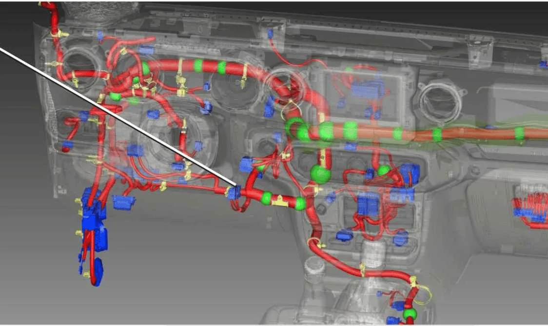

Lets start with looking in this area for these connectors
There are 4 individual small connectors which plug into the HSM
- Benny
