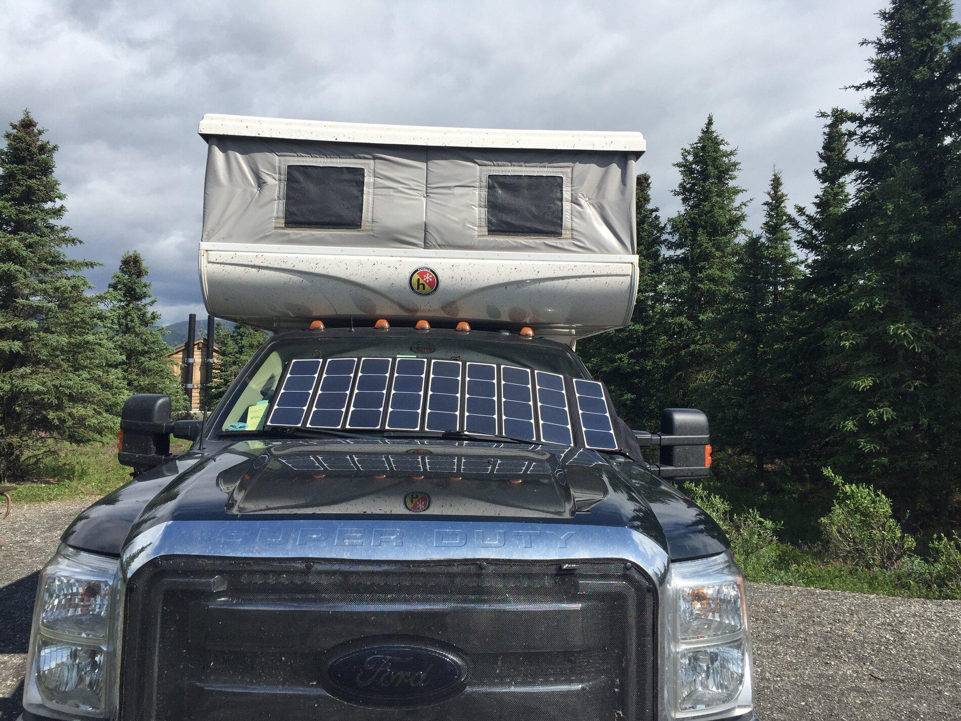

Solar options. Renogy seems to be the best most complete option IMO
https://www.roadaffair.com/best-portable-solar-panels-for-rv-camping/
ā€˜Those types of articles are nothing more than a company buying add space imho. They really arenā€™t a good comparison for what you might need. Having said that Renogy does make good products and I have two fixed panels on my truck camper that Iā€™ll be using for an extended trip in a couple of weeks.
ā€˜The issue (for me anyways) with outfitting my Gladiator is space and those folding suitcases take up a lot of space. We have been using the Overland Solar folding panel that actually takes up much less space .
https://www.overlandsolar.com/collections/overland-vehicle-travel/products/bugout-130-solar-charger
The nice thing about it is that we can hang it from virtually any side of the truck when we stop to maximize itā€™s capabilities. Weā€™ll be using this in our Gladiator build.

Nice set up. What kind of batteries do you run? How much output on that solar panel? Can they be hooked together to get double the output?
That picture was taken at Teklanika Campground in Denali NP. At that time our 2 flexible solar panels on the roof of our camper were dying and thatā€™s the reason we broke out the foldable panel.
Right now we have replaced both flexible panels with 2, 100 watt Renogy fixed panels that charge 2, 100 AH BattleBorn Lithium Batteries through a Blue Seas Charge Controller. With this set up we should be able to charge everything we need indefinitely if we get some sun but will also take the foldable panel as it doesnā€™t take up any room.
