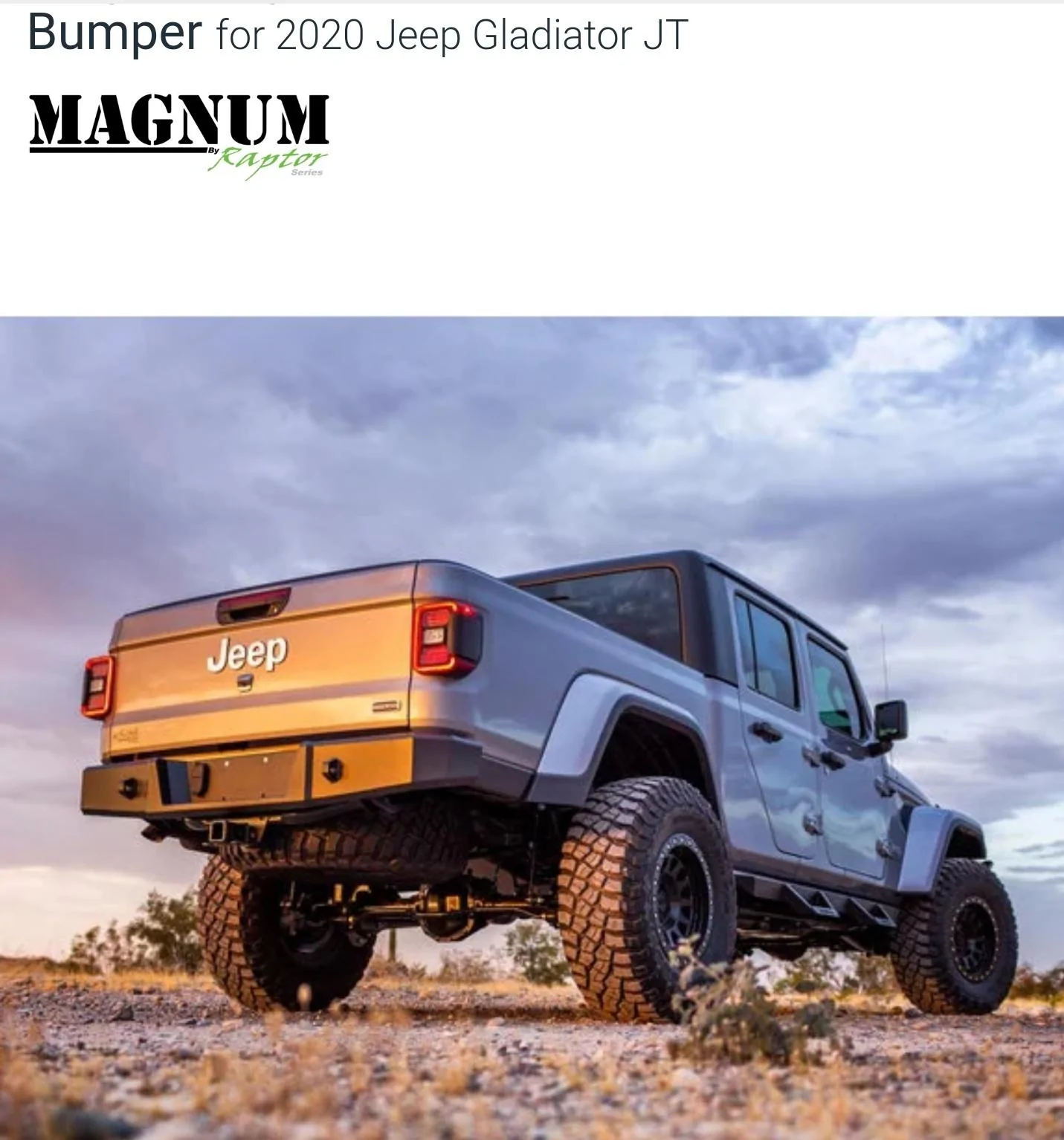

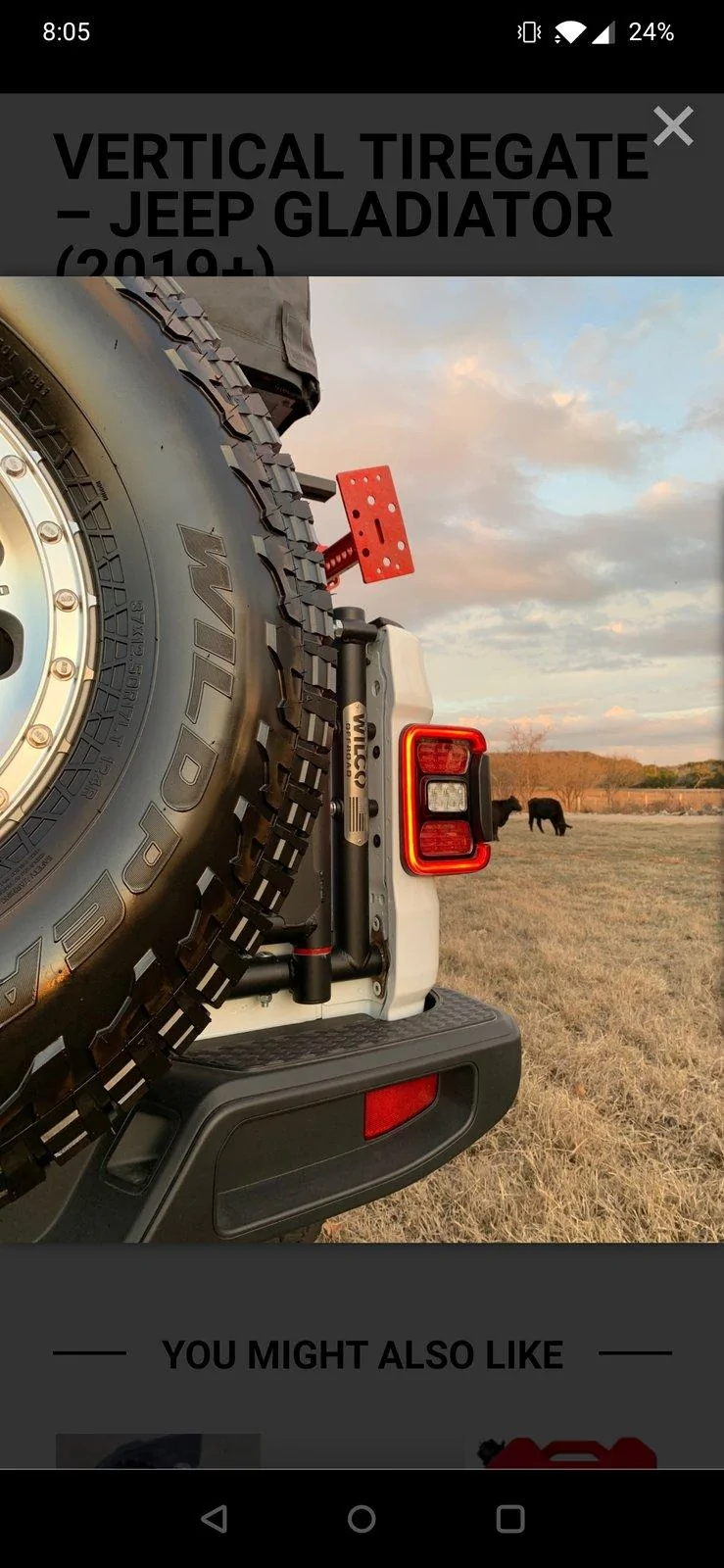

I actually just did it now getting home from work. I decided to just give it a little more force and it gave way without doing any more damage but sounded like a gun shot going off at midnight. Idk how it diddnt wake the kids lol. So I have the magnum raptor bumper ordered and I really wanna get the willco tailgate but it would probably be dumb to put that stuff on before the body work because they will probably need to remove everything again to re paint the bed panel. I'm going to get a 2nd estimate Friday on my day off. Thanks for asking :like:

Im interested in that Wilco gate as well. Would you happen to know how hard it is to switcj back and forth? Id imagine im unplugging the current gate and unscrewing the mounting hardware. Looks like no electrical in the new gate.
Yeah it's seems pretty simple. I'm not sure how hard it is to swing back and forth as I only looked at the pictures. I can't find any videos on it. It sure is expensive though.

I did mess the up the paint on rear panel when I forced the tailgate down but I figured the whole side bed panel from the rear light , baseball sized ding and the ripple is gonna have to be repaired anyway so what's a little more body work at this point. So I guess I'm gonna order the willco gate today and I have the magnum bumper ordered already. I'm going to get a second estimate tomorrow on my shop of choice.

That tailgate is really cool. I wish there was a way that it sealed up.
