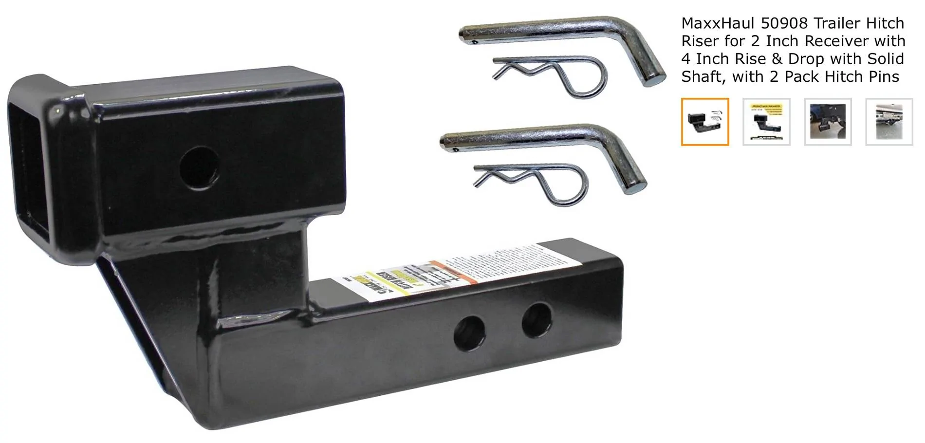

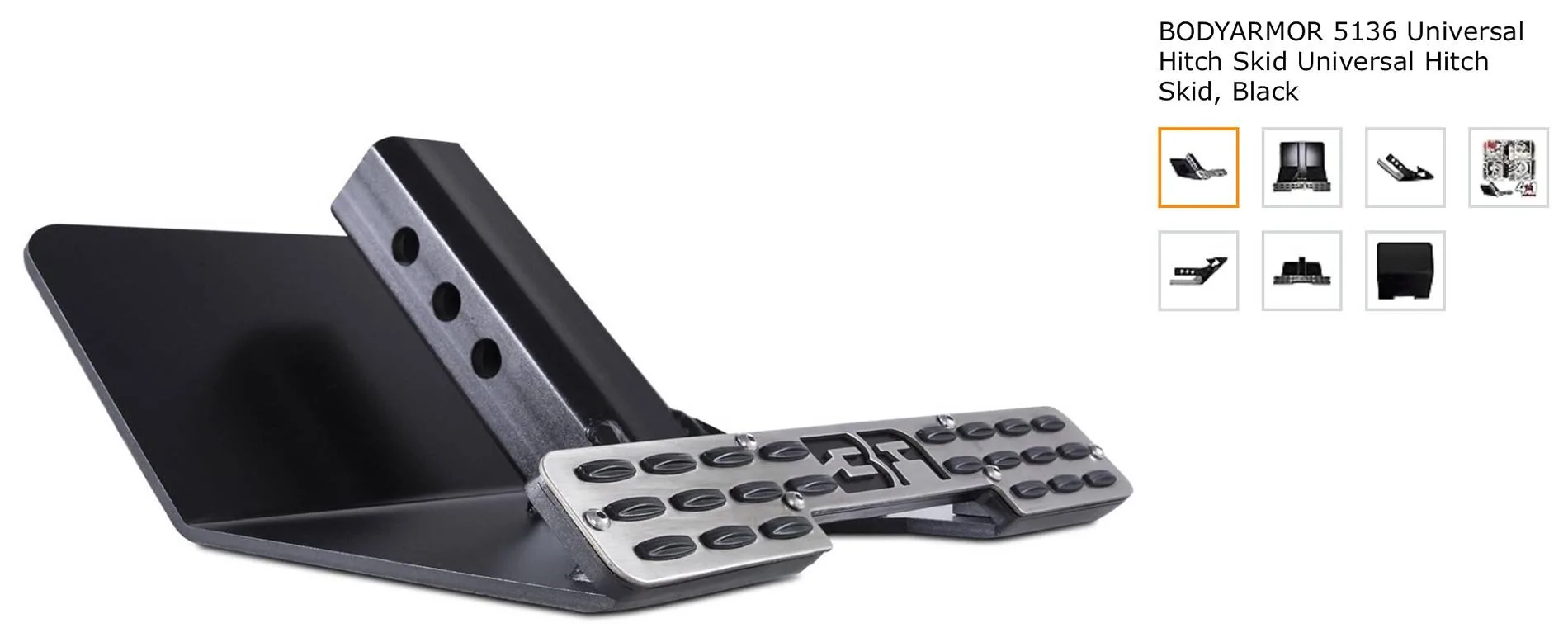

Does anyone make a hitch slider with a built-in riser/extension? I want a slider to protect the OEM hitch but still want to put a bike rack or WaterPORT on my hitch. Raising the bike rack would also help with departure angle.
Something like a hybrid of the two products below:
Jeep Gladiator Hitch slider with built-in extension? IMG_0666
Jeep Gladiator Hitch slider with built-in extension? IMG_0665

I think the piece you are talking about would be a compromise, not a good hitch skid and not the best bike riser. Remember your bumper is above it so the hitch raiser you show would work but the skid would be way back and actually drag and cause problems. I have not seen anything like you are asking for but a weld shop should be able to add a skid to the hitch raiser. I have a skid, bike rack and tow with various hitches, my hitch skid is in all the time unless I need to tow or something else, it is my hitch cover, and first line of defense from bumps in the in the rear and a damn good skid….Jack

I’ve got the BODYARMOR 5136 hitch, it’s an awesome design and a bruiser.

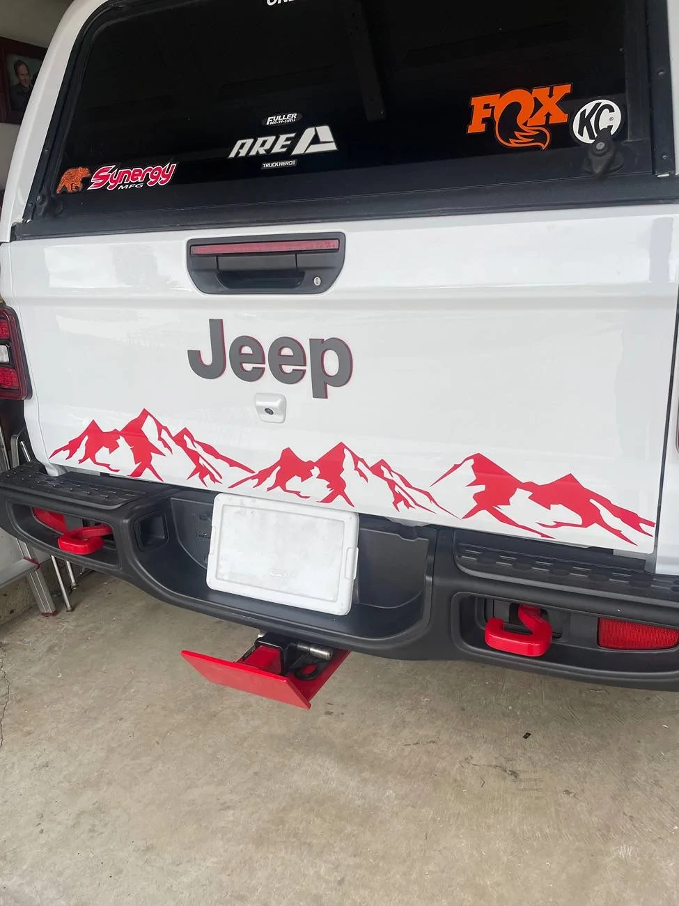

My hitch slider is home made and catches the eye of all the compact rice rockets that tailgate me. They will get a real smack-down.

If you want something there all the time, I really think you need to get a hitch skid drop it off at a weld shop with a Tractor Supply hitch tube and have them make a hitch skid with the receiver just above the step of rear bumper…..Jack
Yeah, I’m leaning towards this. Thanks!
