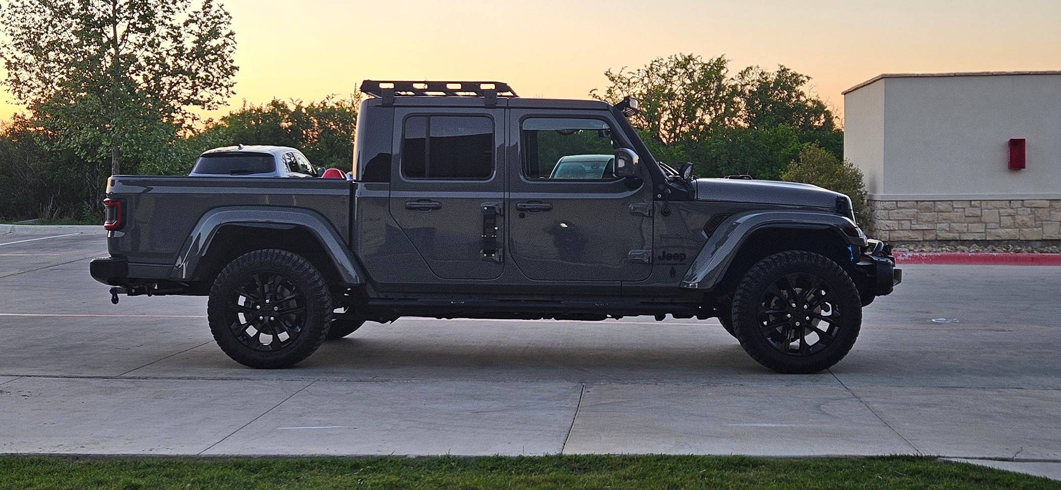

Can anyone tell me if a roof rack for a 2023 JL will fit on a 2023 Gladiator?

Exhaust and rear driveshaft are different, and I think a few things are different in the rear suspension.
