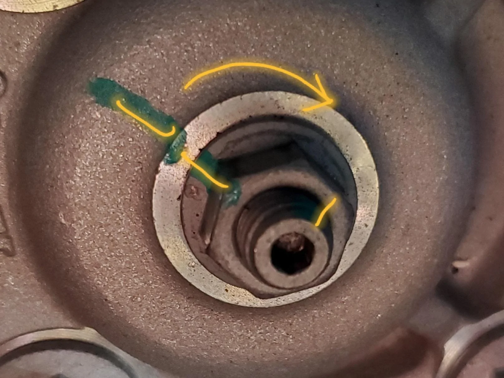

I love how it's a combination of metric and SAE to adjust this...:facepalm:
5/32" is very close to 4mm, which is probably what the socket head set screw is.
4 was sloppy too. My point was if there was something between 4 and 4.5 it would have been nice to have

Did the Allen screw ever "bottom out" and then did you back off a flat or two? The locking nut was tightened with the wrench while keeping the screw stationary if I interpret this correctly.
Watch the video again.
Once you initially loosen the nut with a large 15mm socket. The center set screw, and the nut are a very tight tolerance. Move them apart in opposite directions using the box wrench and allen wrench 30 - 45 degree separation. Once done torque it into place. You should end up like this. If your steering is tight with the truck off. Go back and undo what you did. You must leave a degree in the steering. It will go away once the truck is on. If the steering wheel is tight with the truck off you screwed up your box. Back it off till there is 1 degree of slop.
