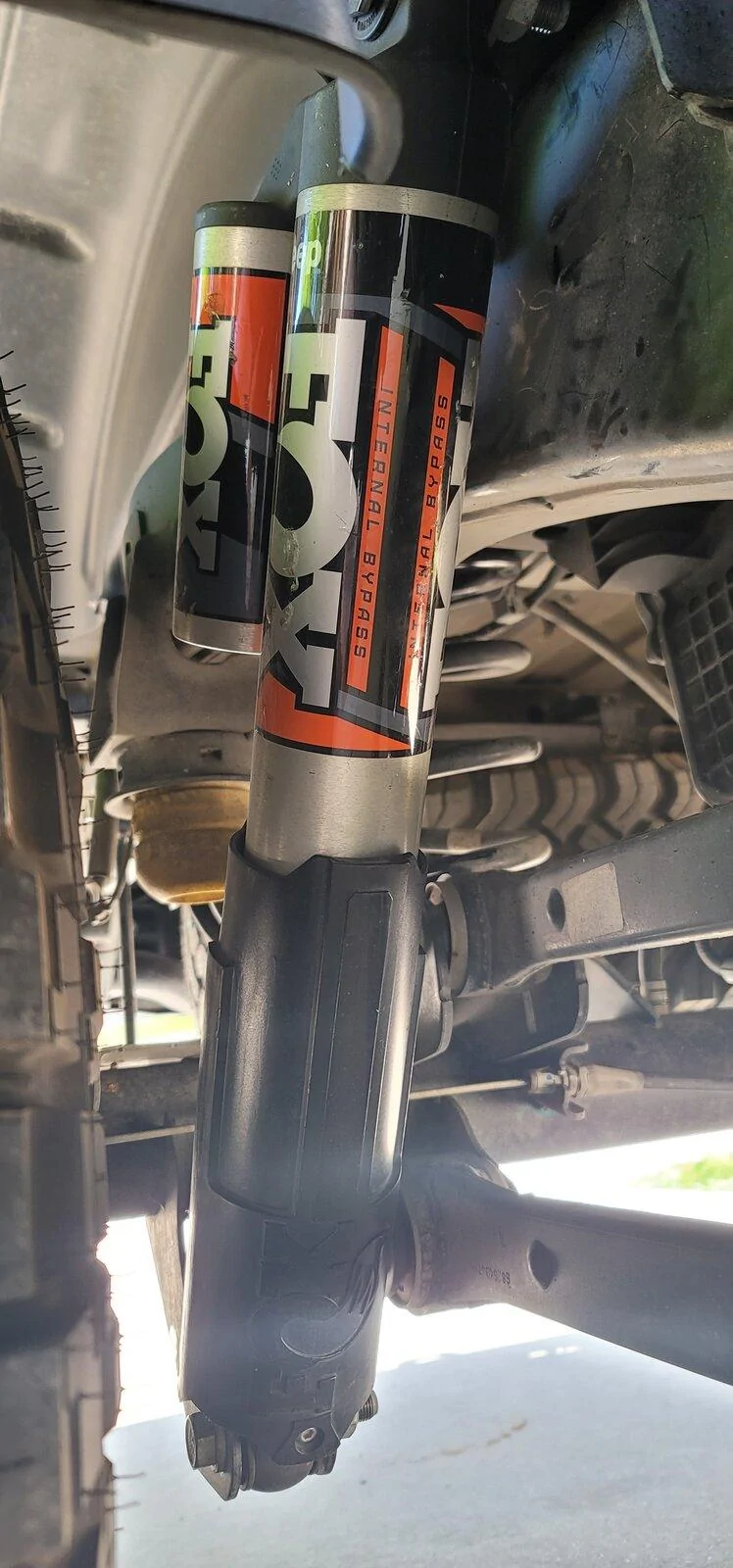

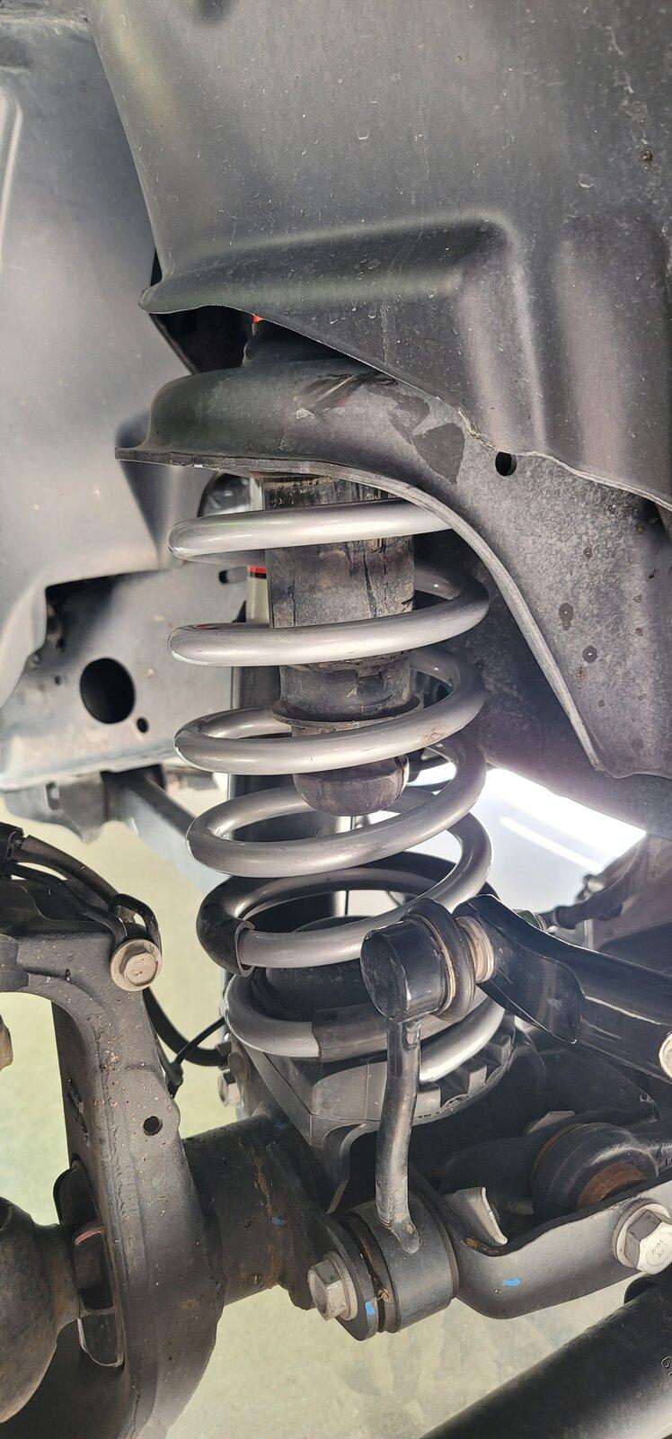

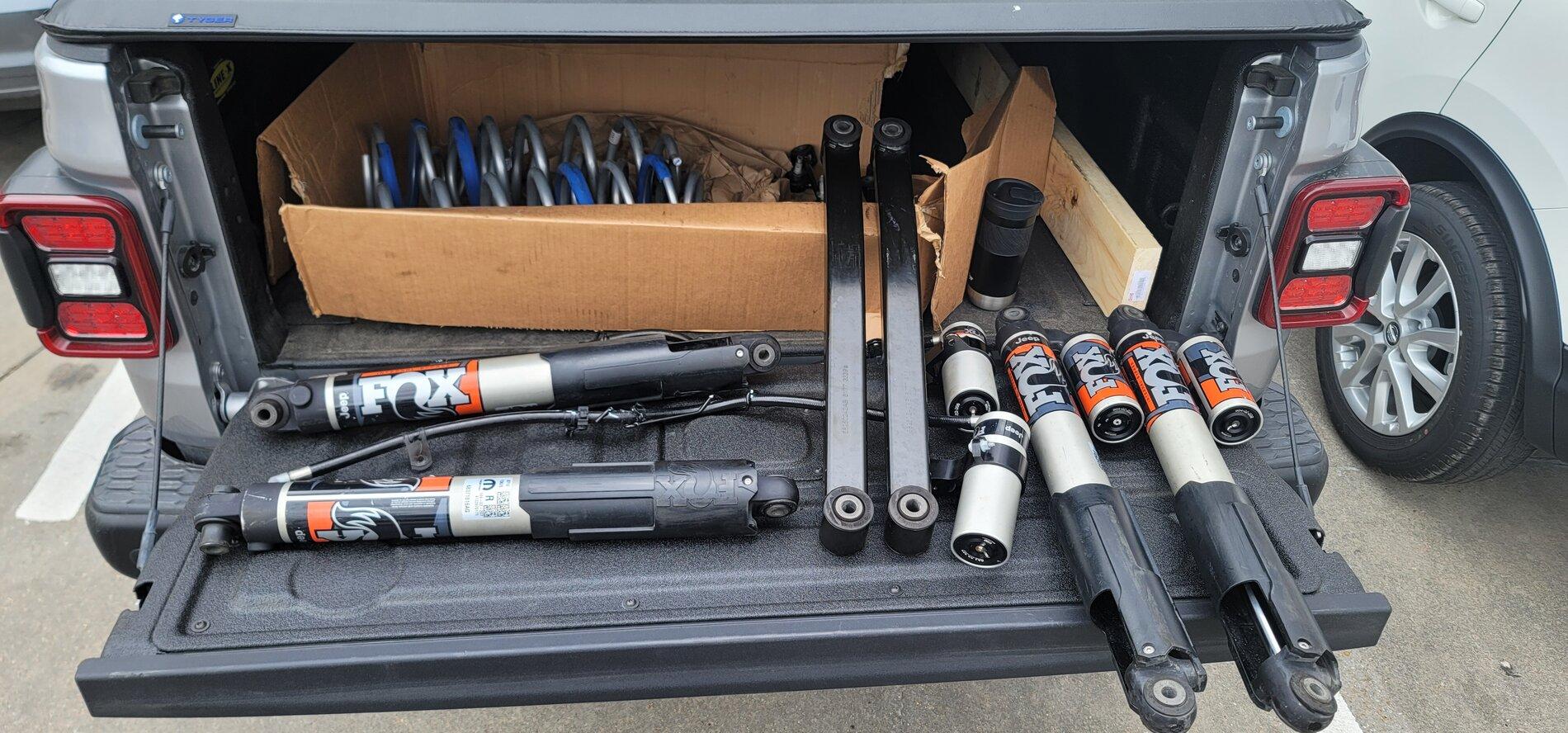

So I found a hell of a deal on some Mojave take offs.. Springs and shocks all for $450.
So I said what the hell.. let's try it!!
Springs and rear shocks are direct bolt on.. Rides like a dream!! Got an extra 3/4" lift on front.. Put the rears on and got my rake back! lol So may install my leveling kit later..
Now to figure out how to mount the front shocks.. The upper Rubi shock bushing fits the Mojave shock so to either drill out the upper mount to fit the bigger bolt or find a new bushing that will fit the smaller bolt..
The lower Rubi bushing is smaller.. so either drill out the lower hole for the bigger bolt or find a bushing with a smaller bolt hole..
So I got the ride quality of the Mojave with the prowess of a Rubicon.. :rock:
I know it's not all that the Mojave has like bumpstops and all that crap.. But not going to do high speed washes anytime soon.. ;)
Fun fun!
