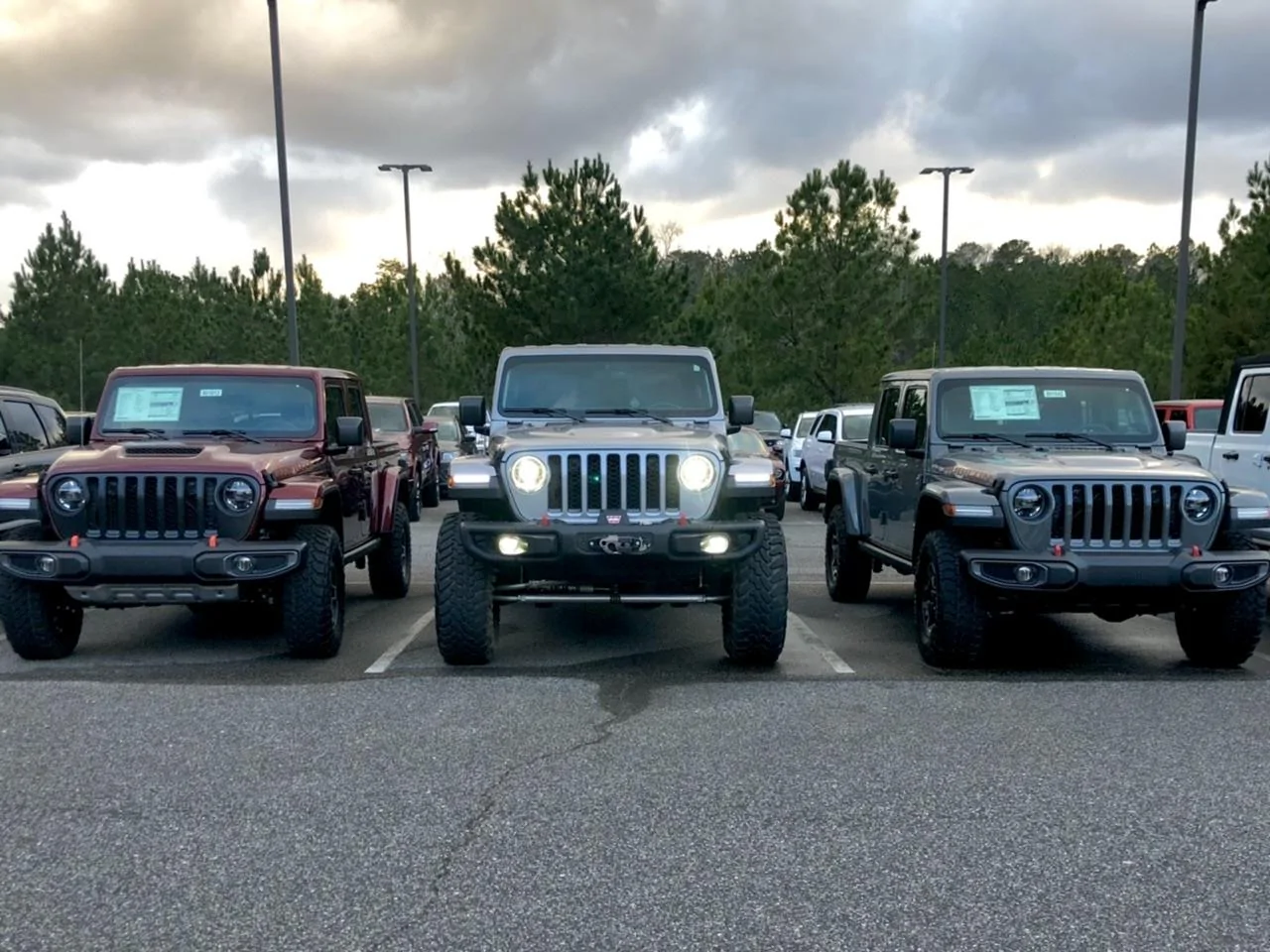

Here’s a pic of the mojave, rubicon, and silvertruck. Just pointing out that where you start with either platform probably isnt where you end up.
Jeep Gladiator How to get best of both Rubicon and Mojave worlds? 10B33E0C-F373-49CD-AE51-0F3730DD7209

Tazer + Fox IBP 3" shocks (10" travel) + fox air bumps + EVO 3" kit (or Currie full kit + evo springs). Done. No cons. All pros. Shocks are adjustable for high speed and low speed separately. It's freaking amazing. Coilovers are not necessary.
I suppose if literally the only thing you're doing is dunes... then maybe still stick with the Mojave due to the reinforcements/etc. If there's any cross over at all though I'd recommend the above approach. No harm in going Mojave otherwise though. Nice to start out with those reinforcements.
