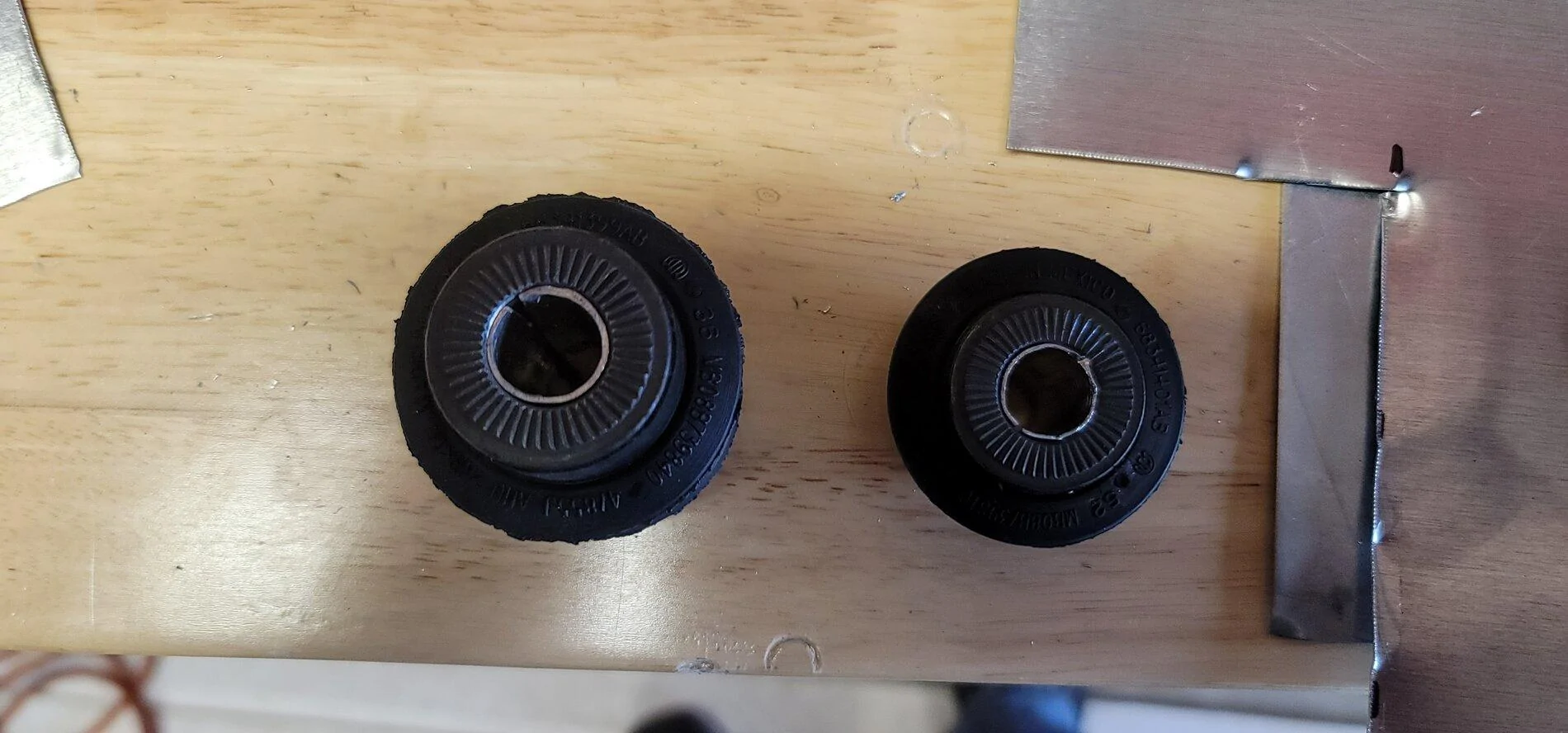

Now to figure out how to mount the front shocks.. The upper Rubi shock bushing fits the Mojave shock so to either drill out the upper mount to fit the bigger bolt or find a new bushing that will fit the smaller bolt..
The lower Rubi bushing is smaller.. so either drill out the lower hole for the bigger bolt or find a bushing with a smaller bolt hole..

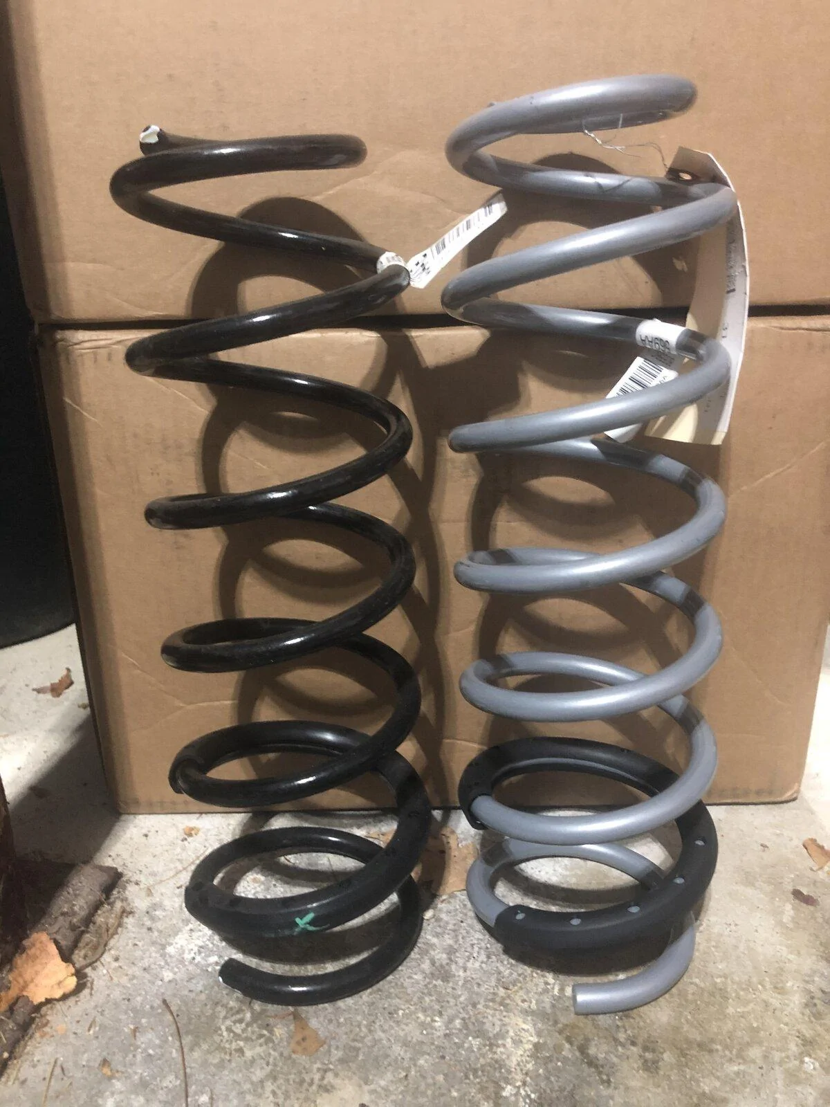

Did you happen get a picture of the previous springs next to the Mojave (both unloaded) to compare height? Or did you note a lift increase after installing the new springs?
I did but don't have it with me.. The springs are the same height.. But the spring rate is different.. The Rubi's are tighter.
I did gain about 3/4" in the front

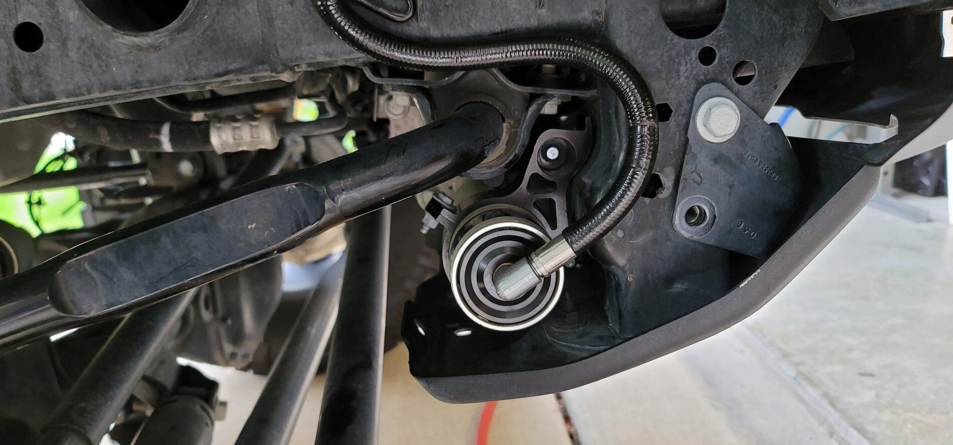

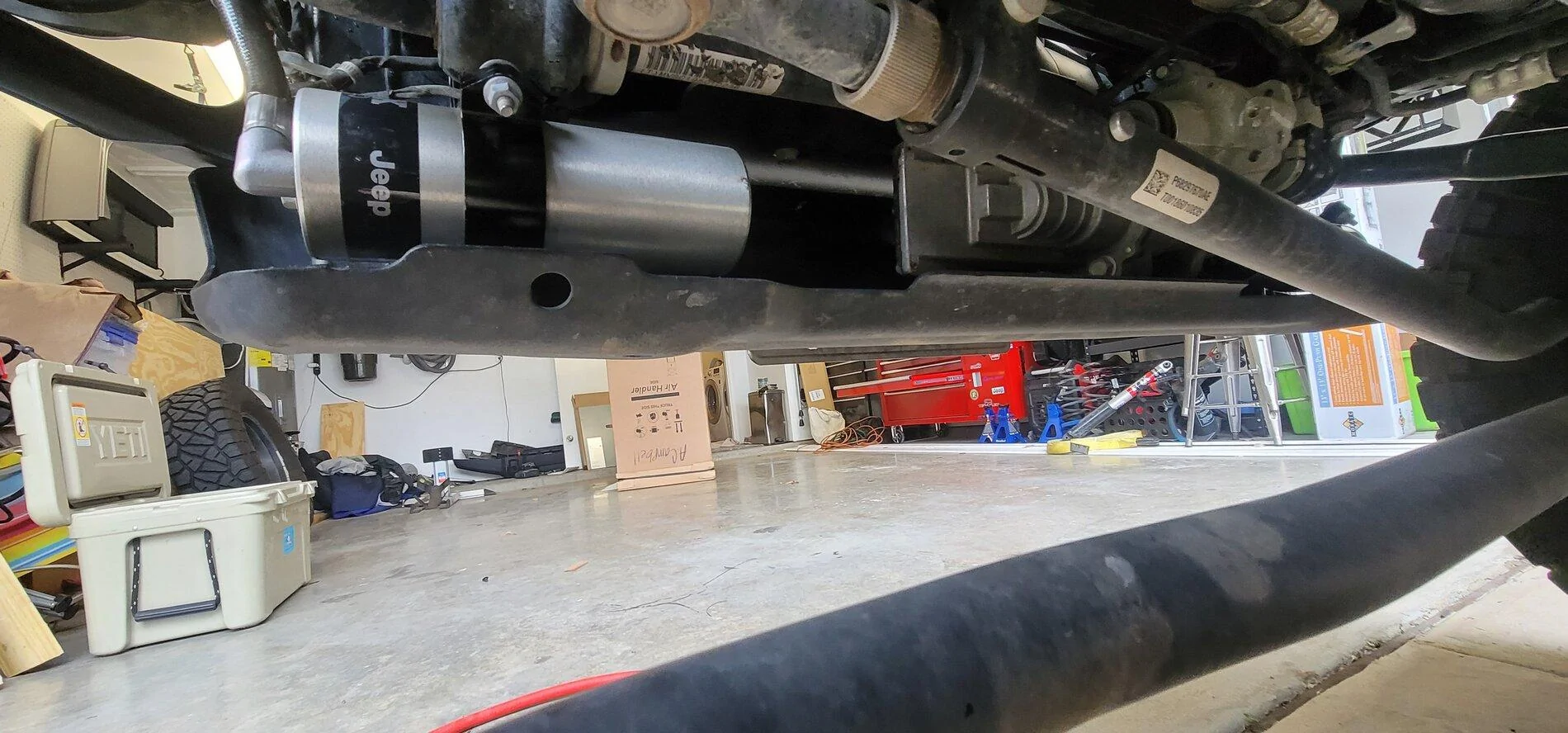

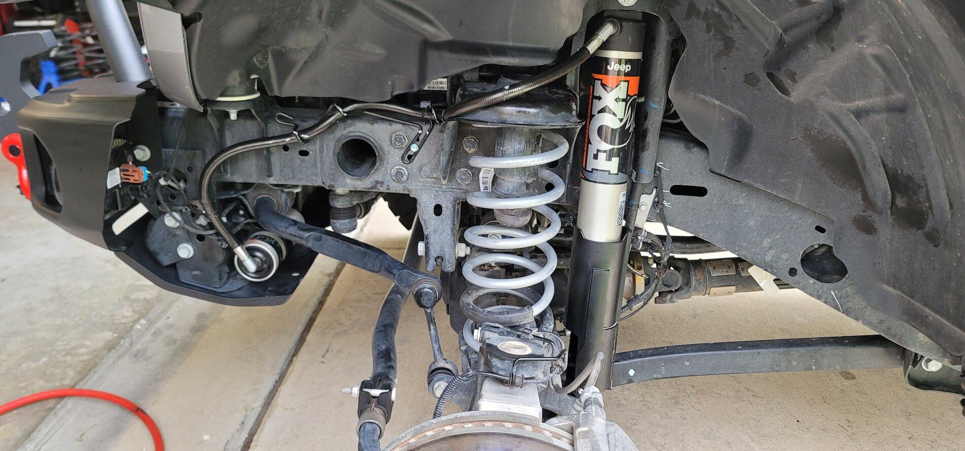

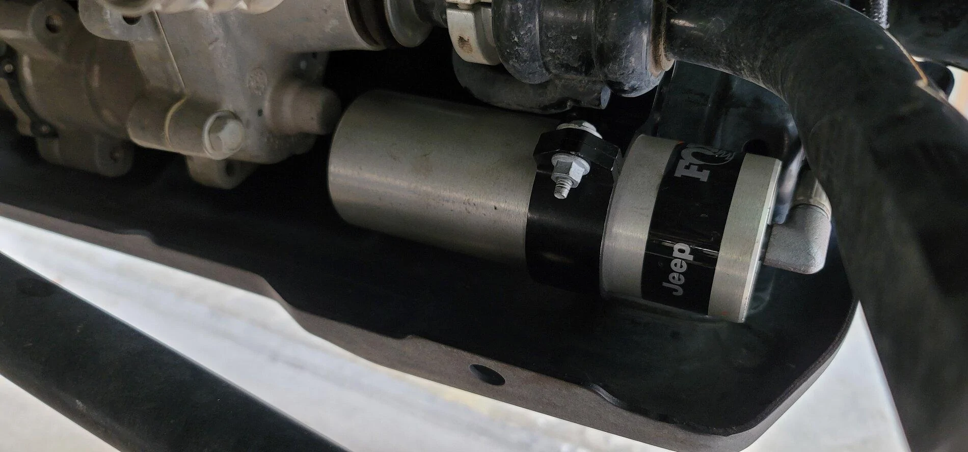

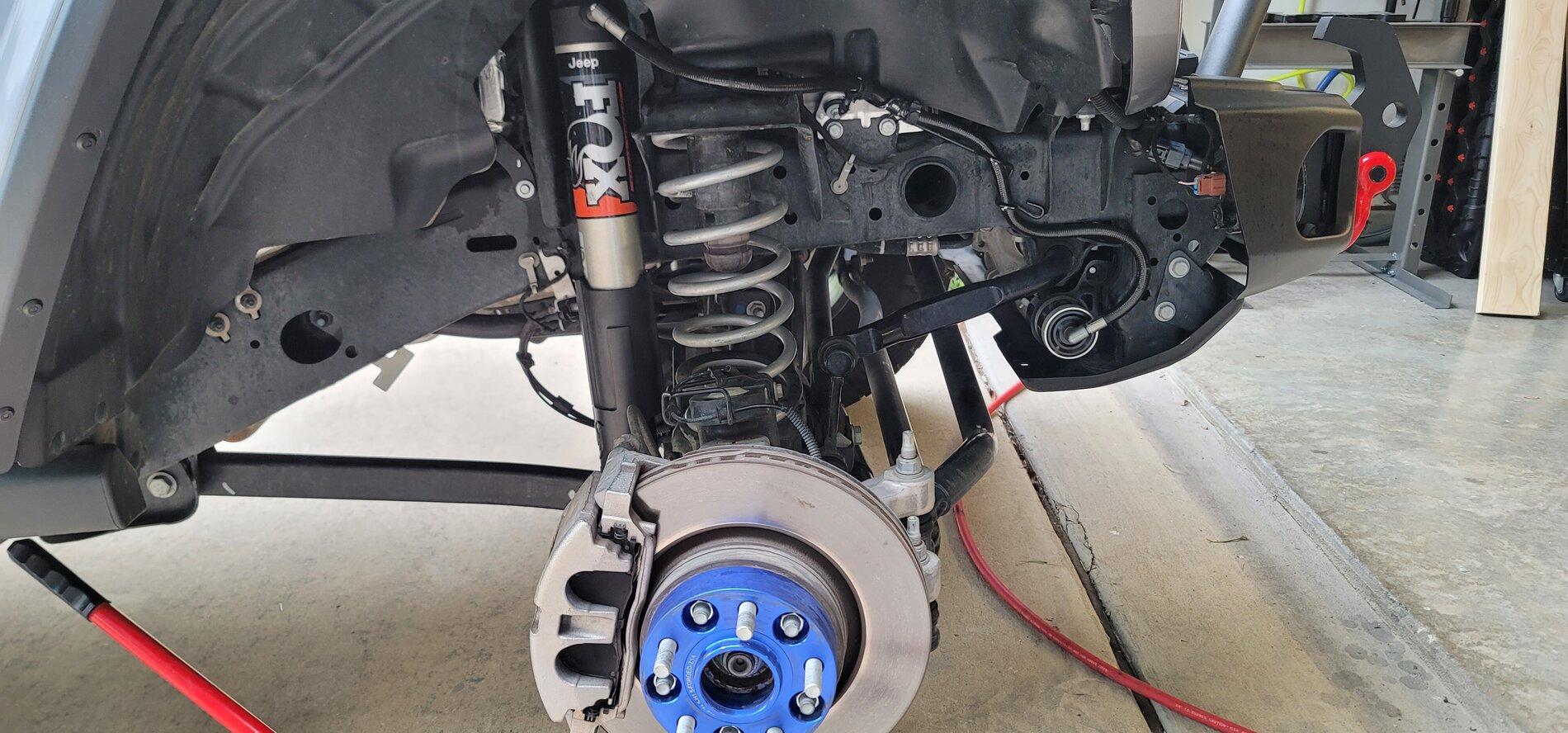

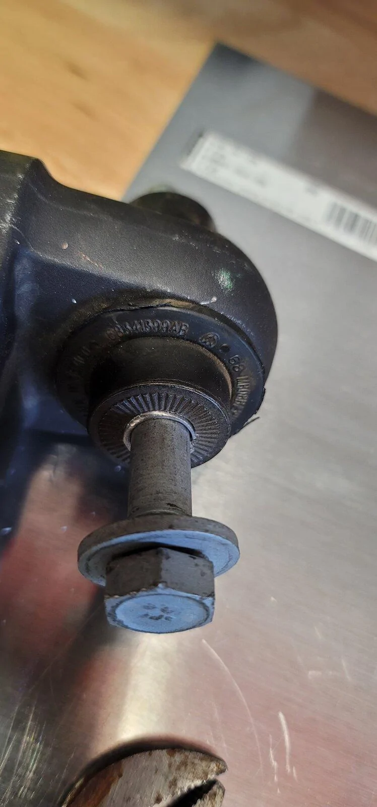

Rubi-Jave is finally done.. Thanks to some help from TXSmitty I made some sleeves to fit the smaller Rubi bolts.. Nice and snug! I have also been seeing posts that the reservoir would not fit due to the electronic disconnect which is not true.. I still had about 1/2 and inch clearance.. Took it out and works great.. Trails this weekend!! :)
Jeep Gladiator How to get best of both Rubicon and Mojave worlds? 20210528_084200
Jeep Gladiator How to get best of both Rubicon and Mojave worlds? 20210528_090831
Jeep Gladiator How to get best of both Rubicon and Mojave worlds? 20210528_100007
Jeep Gladiator How to get best of both Rubicon and Mojave worlds? 20210528_100015
Jeep Gladiator How to get best of both Rubicon and Mojave worlds? 20210528_100432
Jeep Gladiator How to get best of both Rubicon and Mojave worlds? 20210528_102846
Jeep Gladiator How to get best of both Rubicon and Mojave worlds? 20210528_102904
