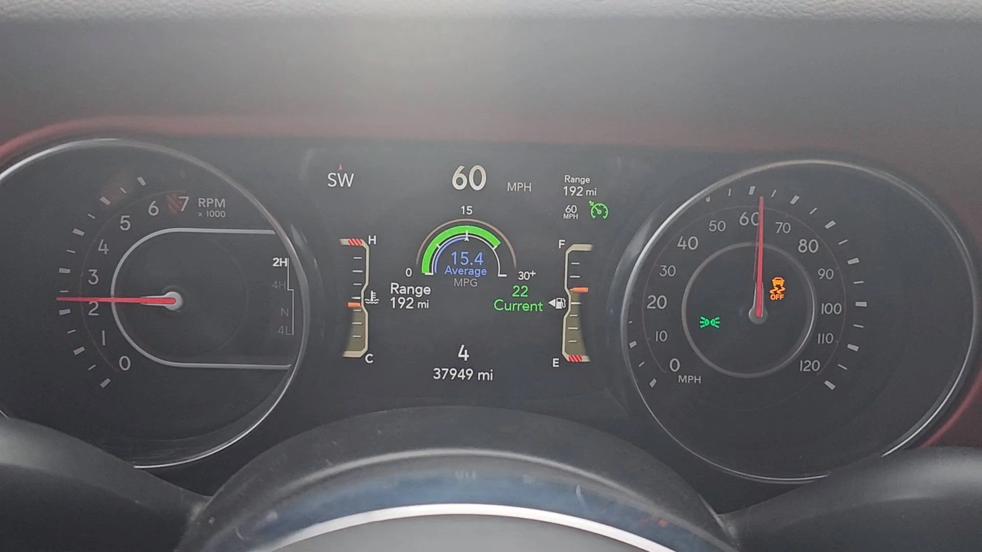

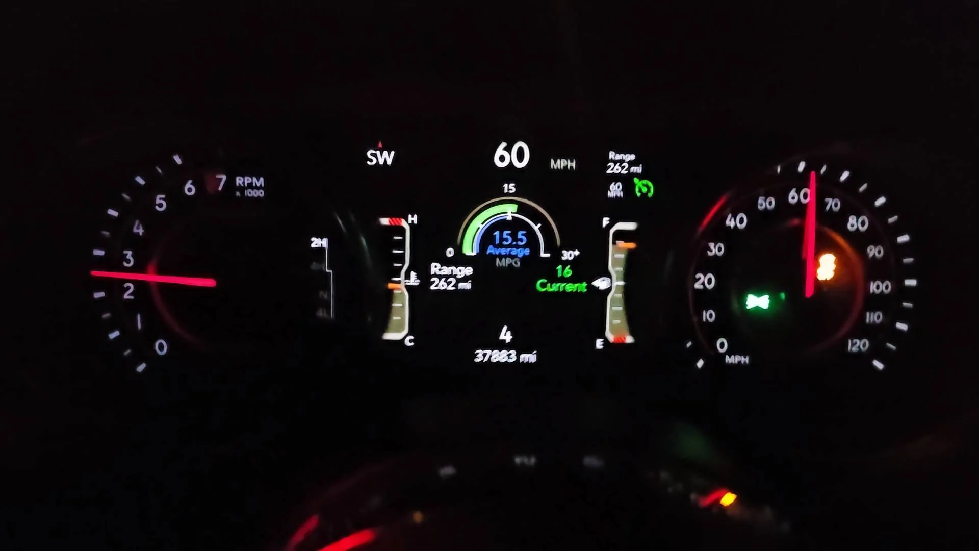

The data is in, and I'm blown away.
Same speed on cruise control. Same stretch of road. Very similar conditions (winds 9-12 mph, left quarter headwind). Both data points appropriately programmed to correct tire size by Tazer. Same Jeep loadout. Here's what I've got:
35s:
Jeep Gladiator I Finally Did It (37s on the way) VideoCapture_20231106-160401
37s:
Jeep Gladiator I Finally Did It (37s on the way) VideoCapture_20231106-160423
The two pictures are taken from video clips of a run between the same two signs on a stretch of highway going in the same direction. 35s returned a range of 14 - 16 mpg. 37s returned a range of 19 - 22 mpg. This was by no means done in a controlled environment, but it's about as good as I could get. Science is undefeated.
I will say that I'm...very surprised by this. And sure, there may be 1-2 mpg of error, but 6 mpg gain? Wow. Even if real-world ultimately translates to just 1 or 2 mpg of gain, I'd still be ecstatic about that.
At 11 pounds lighter per tire, I can feel the reduced stress on the driveline. Takeoffs and braking are smoother. The Jeep starts rolling with less effort. Shifts feel more leisurely. With the same driving habits I continuously found myself driving several mph faster than usual at identical points on my commute across a couple of days. Also, notice the roughly 200 rpm reduction while holding the same speed on 37s (I know this is a result of tire size and not weight, just pointing it out). Finally, the ride is MUCH more plush. I ran 32 psi on 35s, and have 30 psi in the 37s. My only regret is that I didn't make this change sooner.
While I likely will regear in the future when budget allows, I can confidently say that the Jeep drives better now than it did before. We'll see how it is after I run a few tanks of fuel through it. Can't wait to get it off road to test out that side of things.
