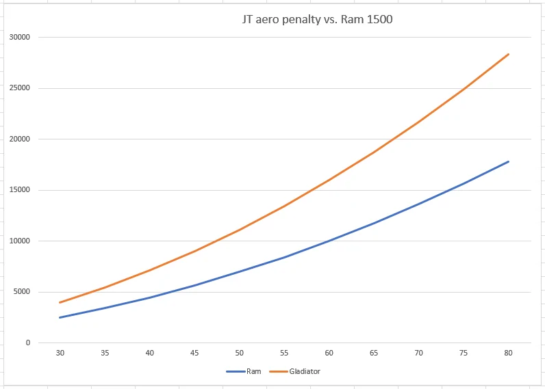

I should’ve said in a low aerodynamic vehicle, not low aero dynamic situations.
I was broadly assuming the aerodynamic penalty the Gladiator imposes on different engines is a linear relationship. It probably isn’t, but for wild ass guesses, it’s the best I got.
Trusting AI, it's a quadratic relationship; faster you go, the penalty increases, but slightly. A smaller engine will work harder (actual output vs. total output) at higher speeds to overcome the aero penalty. The 3.6L "makes" 285hp, and mild Gladiator builds such as mine seem to use every bit of it at speed.
First - Coefficient of Drag (Cd) change
At 30mph, a change in Cd of .04 would be equivalent to adding 150# to the vehicle, but at 65mph it would be 800#. At 80mph it'd be almost 1750#. And this is all things equal, only the coefficient of drag changing from .32 to .36 for an average vehicle.
Jeep Gladiator If Wrangler and Gladiator are the same from the cab forward ......? 1769699946403-bx
Gladiator vs. Ram
If the Ram 1500 Cd=.36, the estimates of the JT fall around .52-.58, depending upon the accoutrements we add. If I'm directing AI correctly (75% confidence I am), the jump between a Cd=.36 and Cd=.58 adds a lot more resistance.
Adding in the JT's frontal area (approx 3.4m^2) and going from Cd=3.6 to Cd=.58, the graph looks the same, but the values are *just* a little different. I know it's 2 variables changing, but if we're comparing a 1500 to a JT, might as well.
Jeep Gladiator If Wrangler and Gladiator are the same from the cab forward ......? 1769706541611-uf
So, roughly speaking and if I'm doing this right (letting AI do the maths I can't, I'll end up pulling a Michael Bolton), compared to a Ram 1500, the JT would have approx. 10,000# worth of weight to equal the aero penalty at 80mph; only ~7000# at 65mph. It would feel like you're towing a heavy-ass trailer or have your emotional baggage in the bed. :LOL:
Air Resistance
Overall, the actual force from air resistance (sea level average assumptions) at 80mph is ~340#. Dropping just the Cd to .36 drops air resistance to ~211#. The frontal areas are similar between the JT and Ram 1500 (~3.4m^2 to ~3.44m^2), but the Cd really shines for the Ram here.
The JT is pushing an extra 130# at 80mph, or an extra 70# at 60mph than the 1500.
Worst Current Aero Vehicles in the USA
The 5-6 worst aero vehicles (based on Cd) in the USA are:
JT & JL (pretty similar, but the JT bed adds about .02-.03 'worseness')
M-B G-Wagen (.54; AMG is .56-.57)
Ford Bronco (estimated, no published #s)
Land Rover Defender (estimated at .38-.42)
Toyota Land Cruiser (estimated at .34-.36)
Even M-B's AMG V8TT has a lackluster 14-16mpg estimate. It only puts out 577hp/627tq, so no one here would be interested in something like that, right? Regardless of the $200k price tag. :LOL:
Just for Funsies
And because I was curious, and have no idea if it's correct, with the published 0-60 times and 1/4 mile times, I ran some numbers for my JT. It takes an additional ~250hp (at the crank) to move a modded JT (lift & tires) from 60-80mph in under 8 seconds. The JT is using roughly 40hp to maintain speed at 60mph, so those calculations don't seem out of line with the 3.6L hp rating compared to real-world experience. Getting up to 80mph is not very effortless (compared to our older BMW w/ 325hp), usually dropping to 5th/6th gear and a good amount of dino juice application. The numbers would indicate I'm using 90%+ capacity of the powertrain at higher speeds with my setup. Again... if this guy - who hated maths in school but tries to find solutions using maths and logic all the frickin' time - is mostly on the right track with estimates and loose assumptions.
