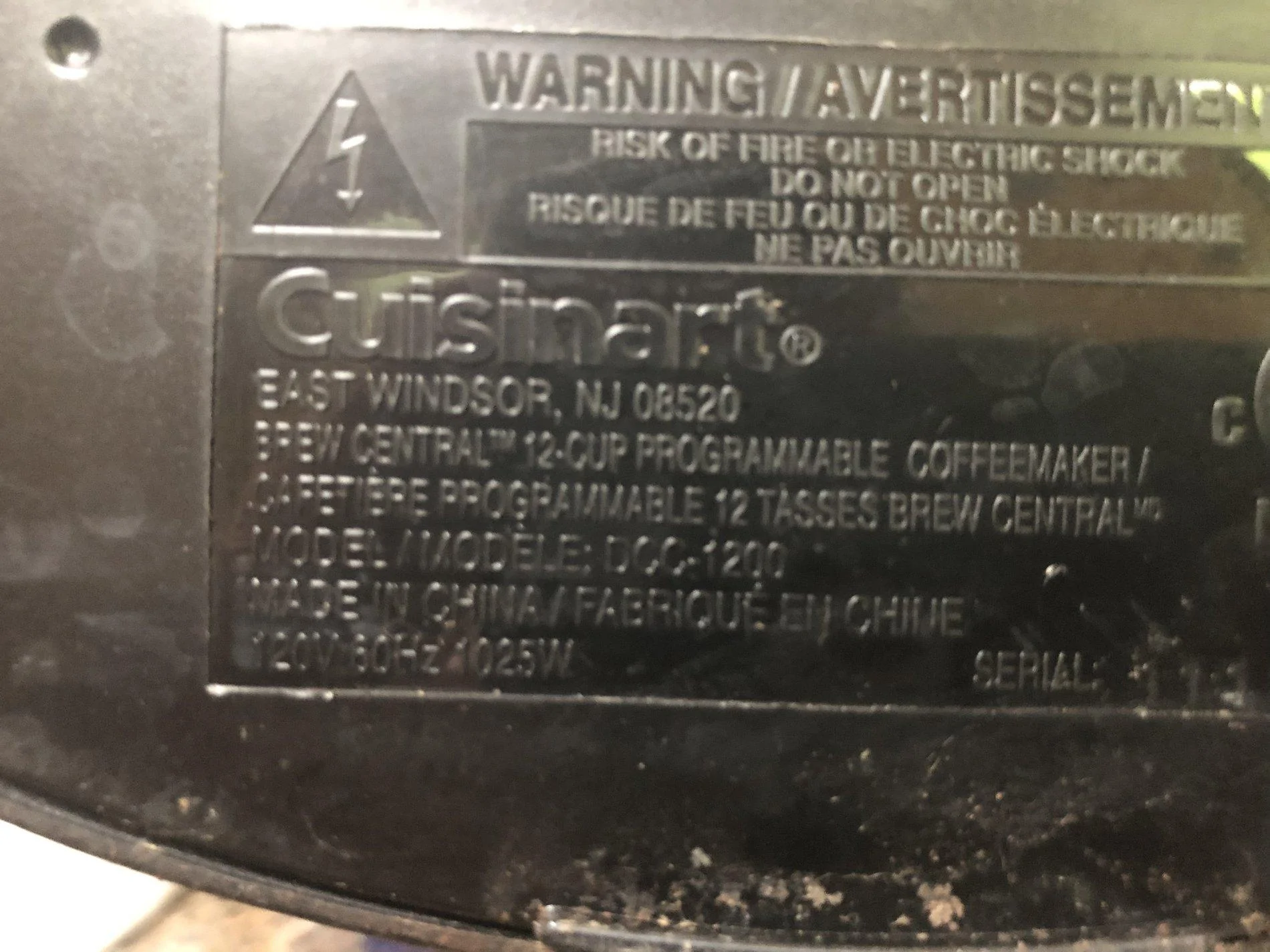

A 1000/2000w inverter would serve to provide serious overland power and the cost per unit is laughable on an industrial scale. Nope, 400w fore AND aft is all you get. I remember TFLT did a review of the JKU Rubicon and their idea of being prepared was to bring an electric hedge clipper to trip back offending branches, too bad they never trialed it before shooting because it flopped. It’s nice that I can charge a camera or laptop but what if I needed to run some serious equipment?
My coffee maker requires 1025w.
I can’t think of a piece of electrical equipment more important than that in the field.
