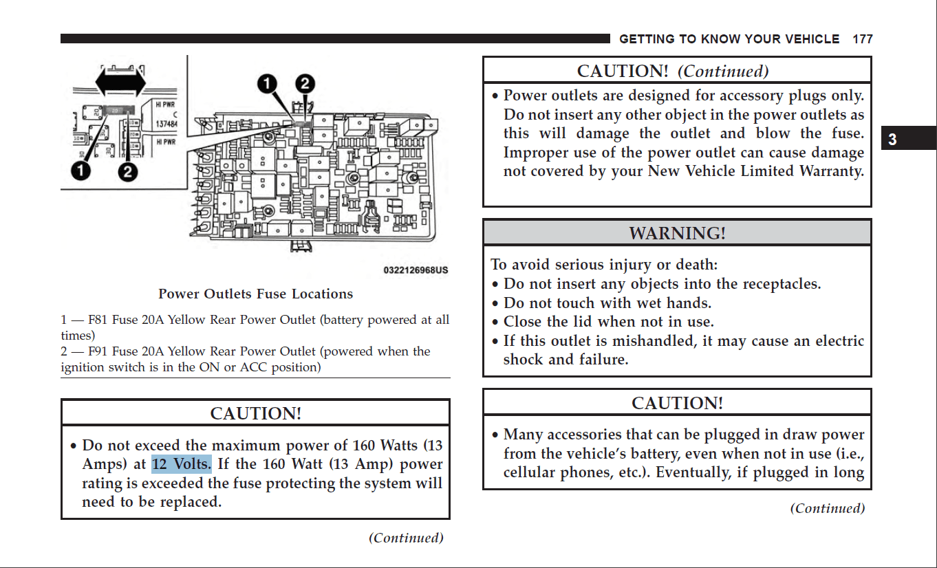

I couldn't find anything in the Owners Manual about the 110v outlet on the back of the center console other than the typical warnings about the potential for battery drain, # of devices connected to both outlets (in bed also), etc. There's no mention of the outlet being switched but obviously it is.
It's interesting to note that according to the JL Jeep owners they have a fuse that can be moved to power their outlet even when the ignition is off. From the JL Jeep manual...
(Link to their thread: https://www.jlwranglerforums.com/forum/threads/12-volt-or-usb-always-on.8688/)

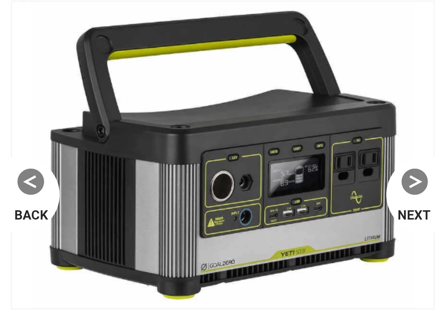

I just use a Goal Zero Battery/inverter, it charges off the Jeep 12VDC outlet, and it is portable!
