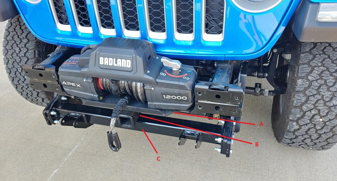

Anywho - my comment was because:
Some people figure they'll get a receiver winch mount and run a winch from a front receiver.
Don't waste your money on the biggest winch since the receiver isn't rated for a massive pull during a recovery. You should only ever do a straight pull with a receiver, not at an angle (good luck with that)
The receiver is where the rating is - not a bumper. Bumper rating doesn't matter (unless the receiver is made into the bumper - not common)
A - Bulldog winch plate. I could put the bolts in the front and winch the rating of the winch without any bumper at all if I had a bracket on the plate to hold the rope guide.
B - Curt receiver - never use for heavy winching or angles over a few degrees
C - snow plow mount - marked that so people know it's not part of the hitch/receiver or winch.
Winch plate is where the strength is - winching doesn't pull on the bumper unless you have one of the few bumpers that is made to hold the winch directly. Not my cup of tea but some love 'em and that's cool. Sure makes it EASY.
Jeep Gladiator Is a winch really necessary? no-bumper
