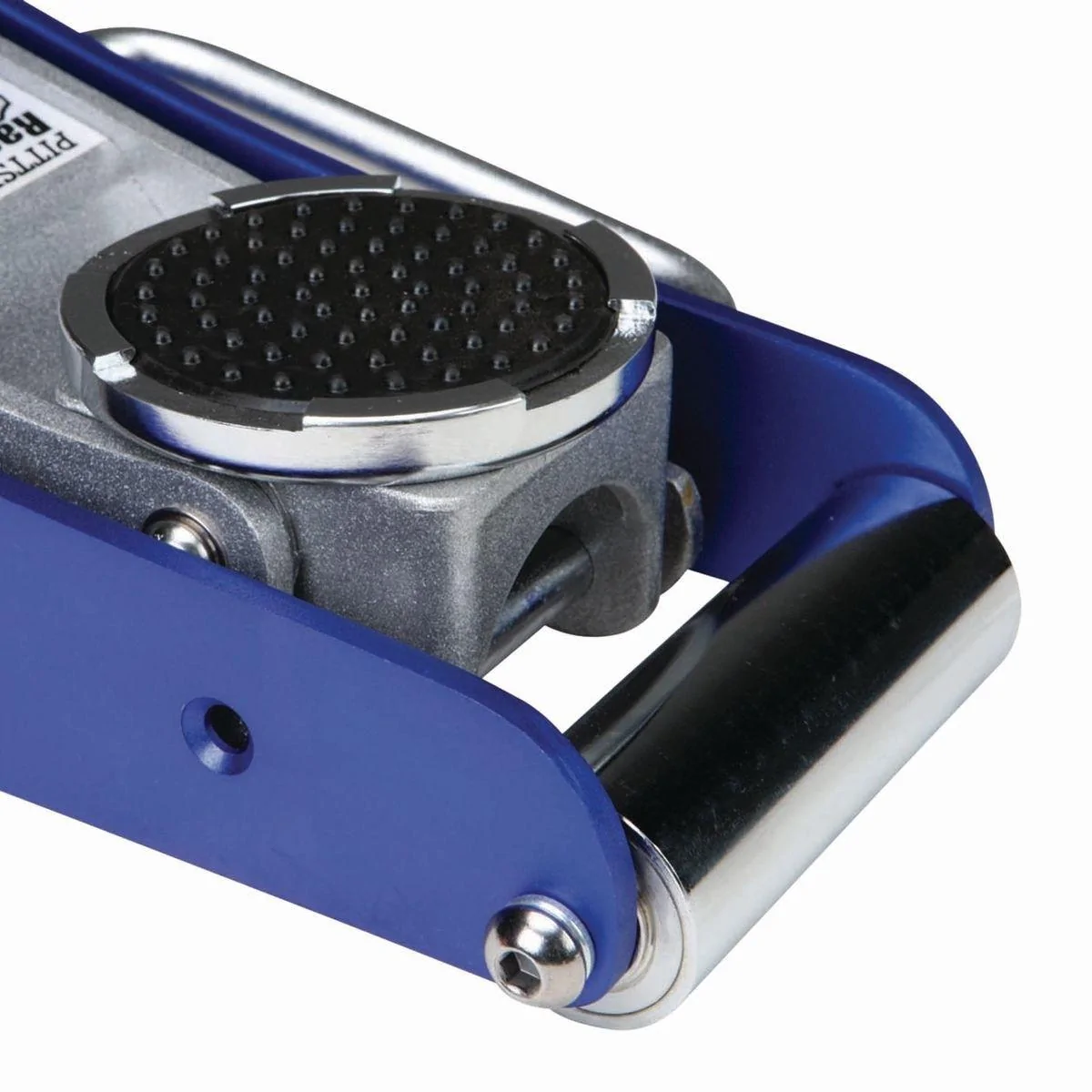

I have one of the HF aluminum floor jacks, and have found that their 1.5 ton is marginal for lifting the Jeep.

Yeah i think at the minimum, I'd want something rated for at least the maximum GAWR so I could jack at the pumpkin fully loaded and realistically, 1.5x for safety margin. This is largely why I'm an advocate of bottle jacks because they're easily the most lift you can get for your dollar and they're comparatively small and light compared to something else at even half the capacity. Mine is a $50 6T jack that weighs maybe 15lbs and fits anywhere I'd want to store it in the cab. Definitely can't do that with a floor jack.
Not to mention that if you have an OBA setup, you can get an air-actuated bottle jack so you aren't pumping on the side of the road. If/when I replace or supplement mine, that's going to be my next move.
