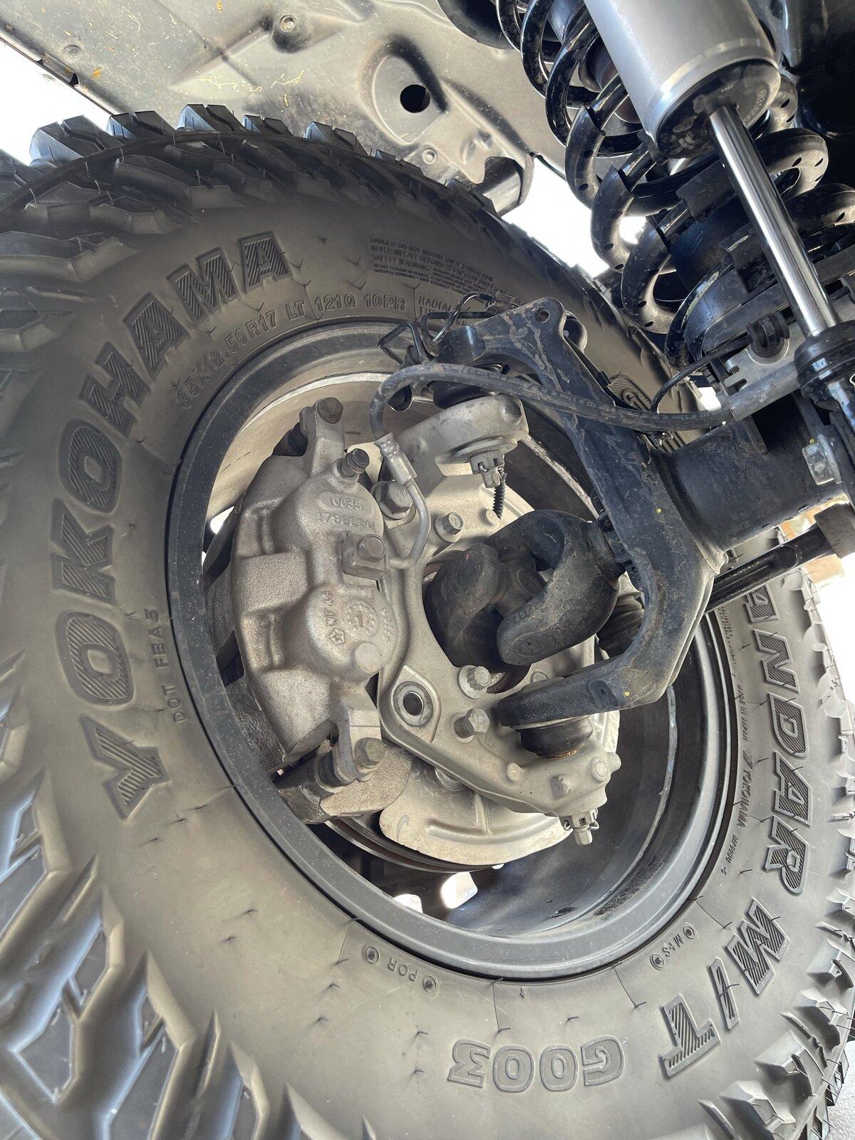

I had a problem with my front brake that turned out to be a loose caliper bolt. It was making a knocking sound till it finally fell out. The knocking comes from the entire caliper pivoting because the bolt is loose.
I strongly advise they check to make sure those bolts are tight. It happened to me a million miles from nowhere in the middle of the desert. Not a good situation.
The upshot to this is that it is a very easy fix. Just tighten the bolt to specs. You can see in this picture the gaping hole where the bolt should be. Also notice the gouge the mechanism put on the inside of the rim. Caused by the caliper swinging out and rubbing against it whenever the brakes were applied.
I wish it was that simple, that was one of the first things I checked, thanks for your advice though.
