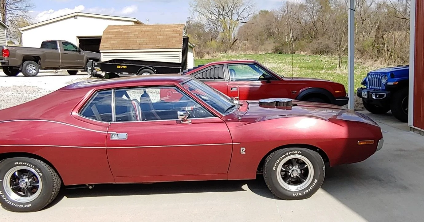

There, it's in the foreground now - much better LOL
(The little SX4 is the car with the 4.0 in it)
Jeep Gladiator Jeep Straight 6 Long Block in a JT 20200425_162330_HDR
