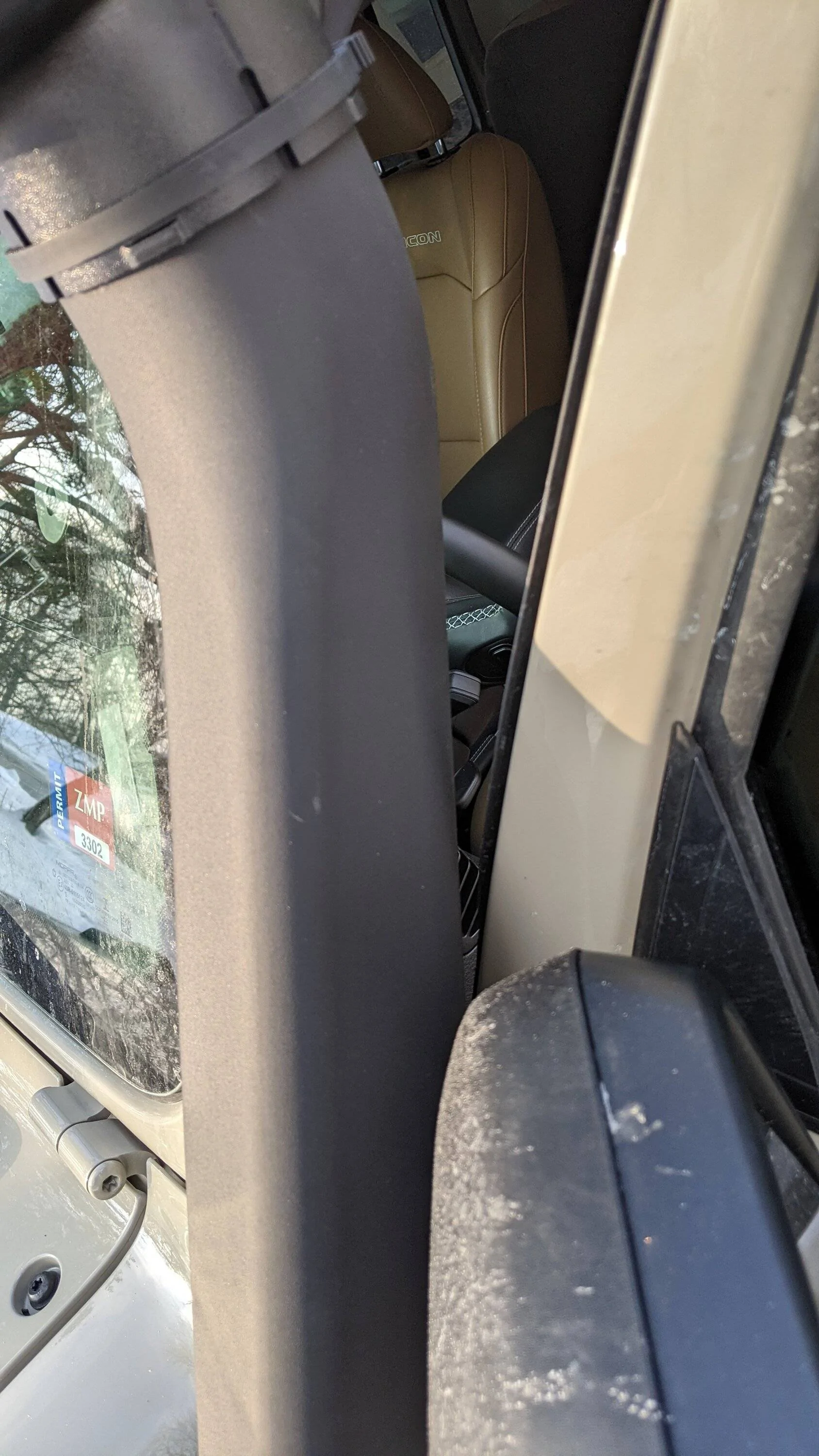

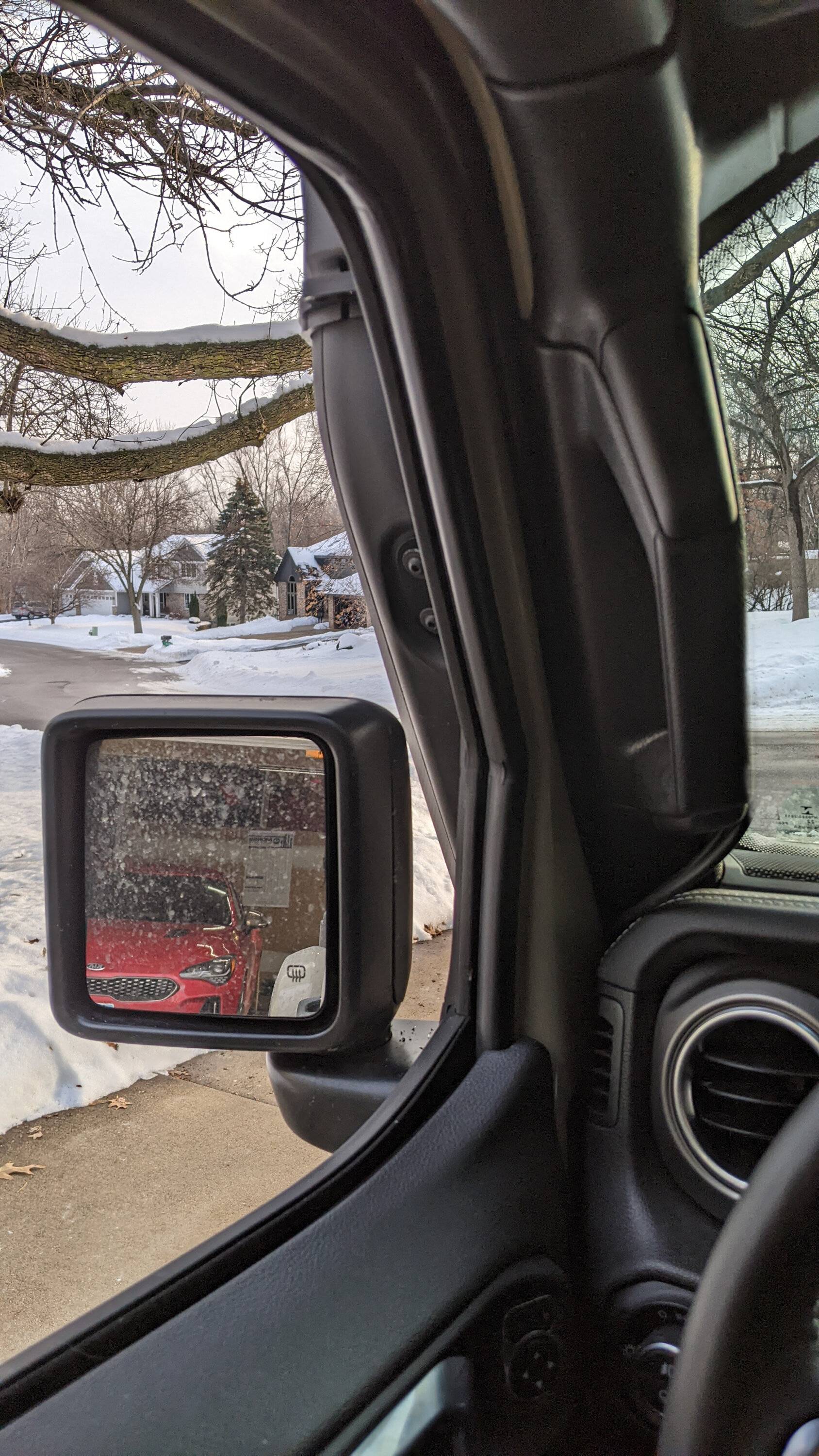

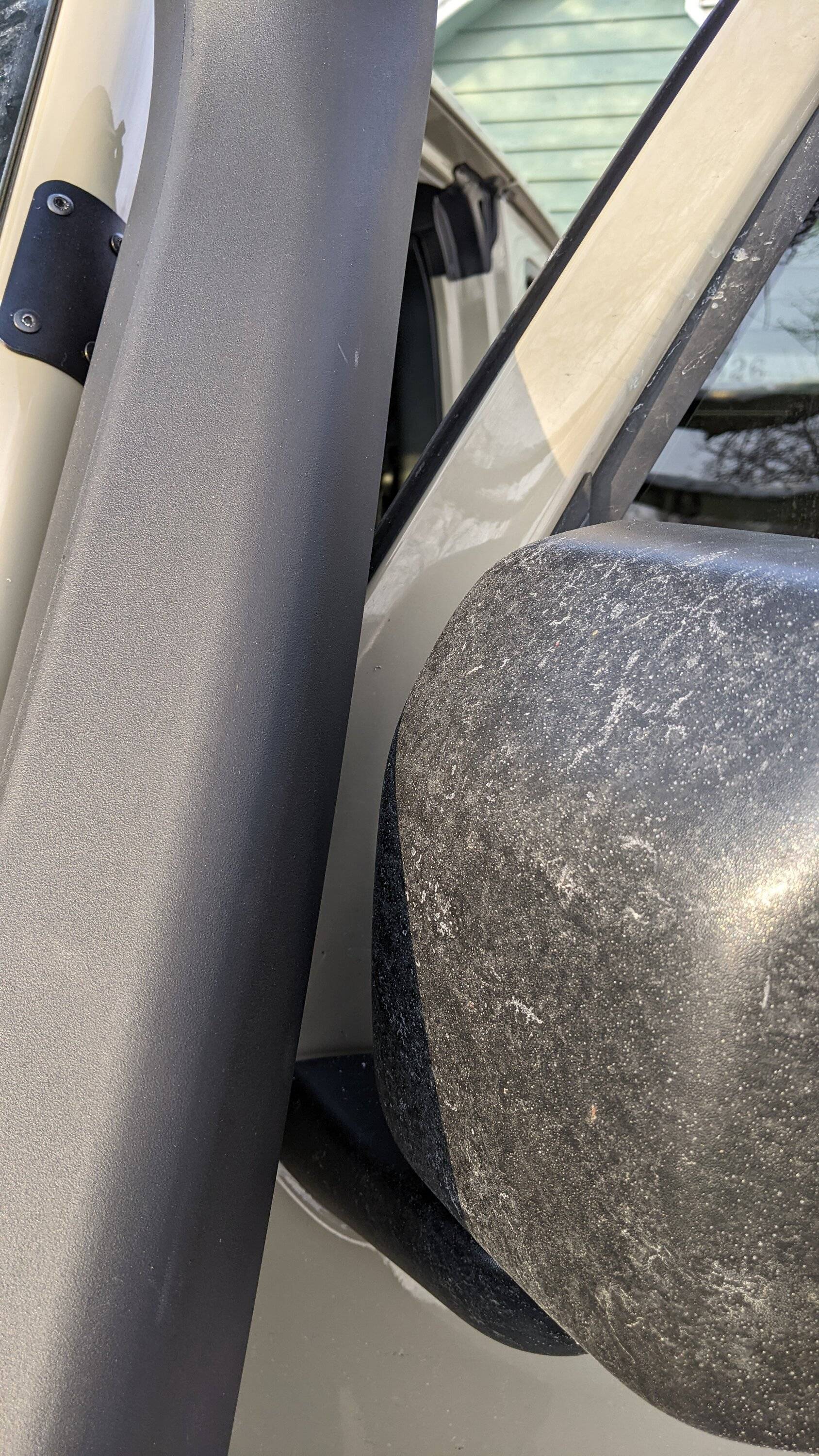

A couple more pictures showing some clearances to the mirror and door, and visibility from my seating position. I'm 5' 11". Don't mind the salt.
I ordered a Sy-Klone 9001R as well to test it out. Will report

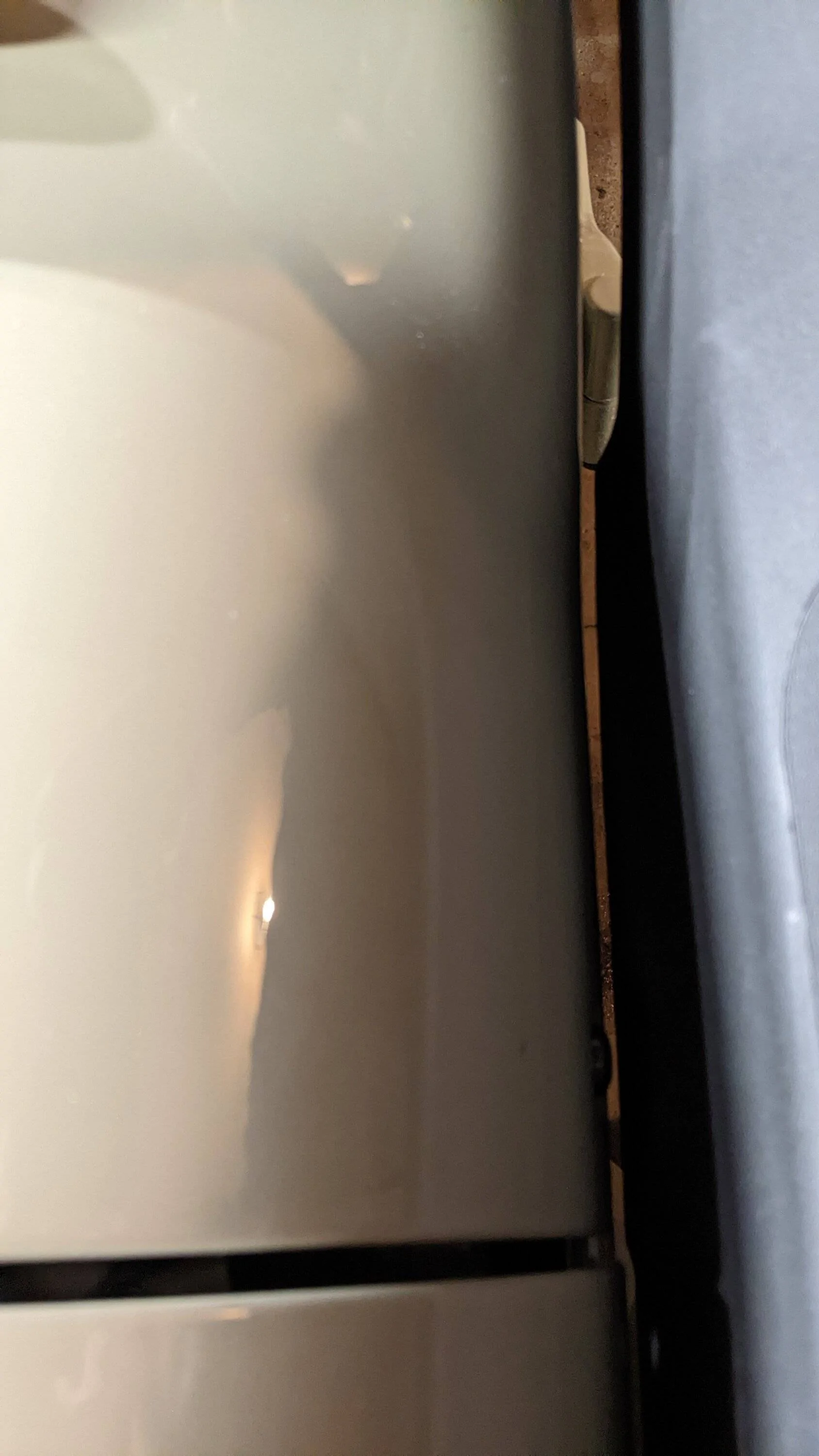

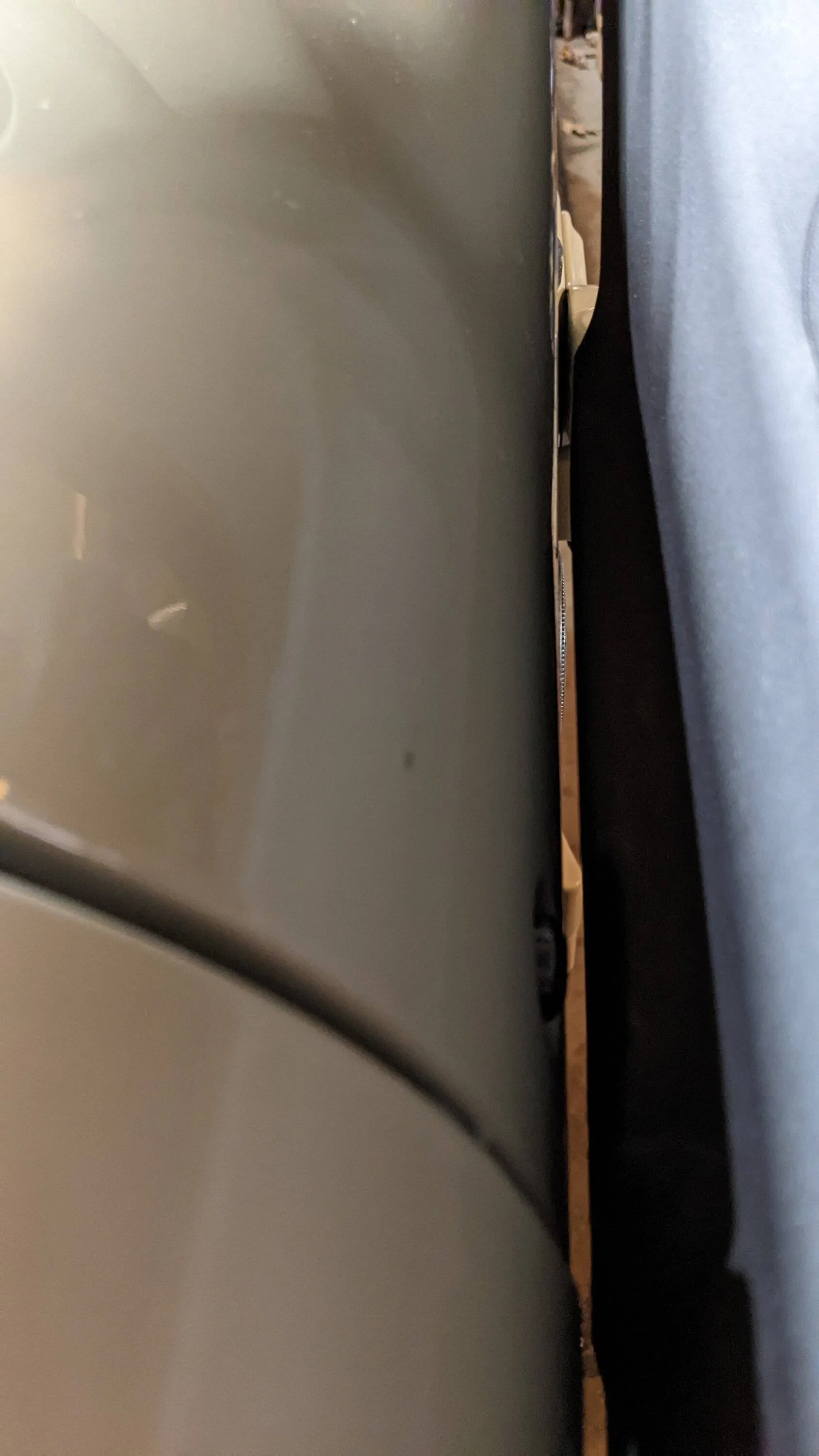

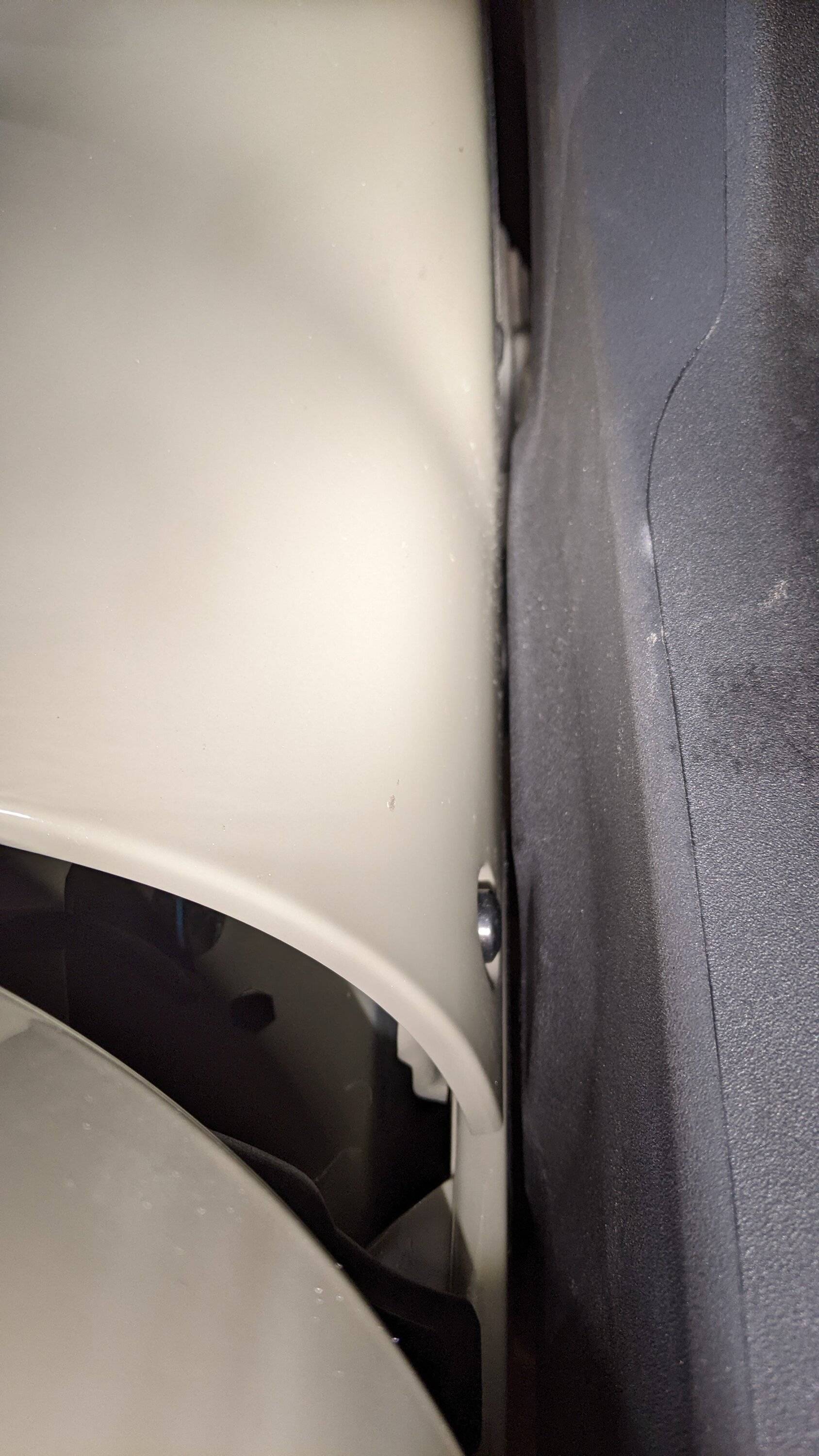

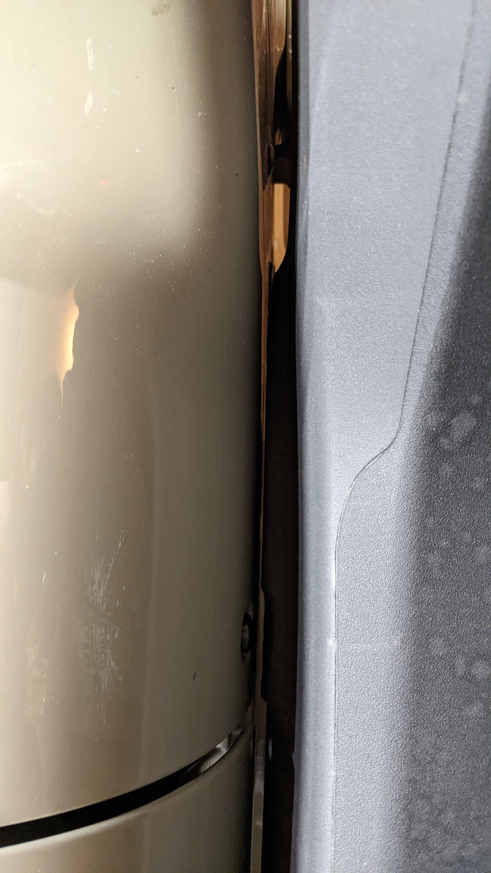

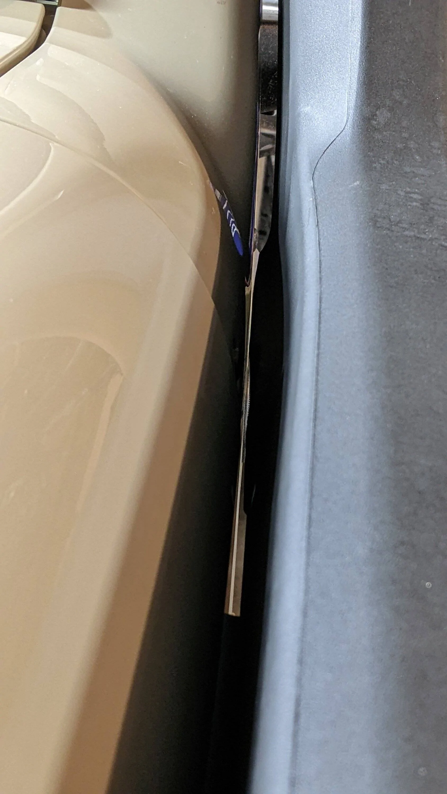

@BlueScapegoat do you think you can make some clearance photos near the driver cowl where people usually install turn signals, light mounts for ditch lights etc?
I’d really like to install something like that
https://www.bamwholesaleparts.com/o...-off-road-lower-a-pillar-oem-mopar-82215427ab
Looks like it’ll fit , but if you have a minute..
Thanks!
Boy that's tricky but it looks to me like it would work. There's a wider squared off spot on the snorkel, for whatever reason, just between those two screws on the cowl. The snorkel is then recessed in front of those screws, steps inward (away from the cowl) just above the screws, then tapers outward. If any of that makes sense.
Between the screws I could just snugly slip in a piece of cardboard, by my best estimate with the cardboard and some calipers that gap is a smidge over 1/8th inch. I think AEV has a close working relationship with Mopar, I'm wondering if the spacing and tapering of the snorkel is specifically intended to work with those brackets? I'd contact AEV and inquire. A fellow named Matt with AEV seems very responsive on the AEV Worldwide Facebook group.
Even if they made contact, the snorkel is very rigid, I think it would only serve to better brace the snorkel. Put a thin strip of rubber between them.

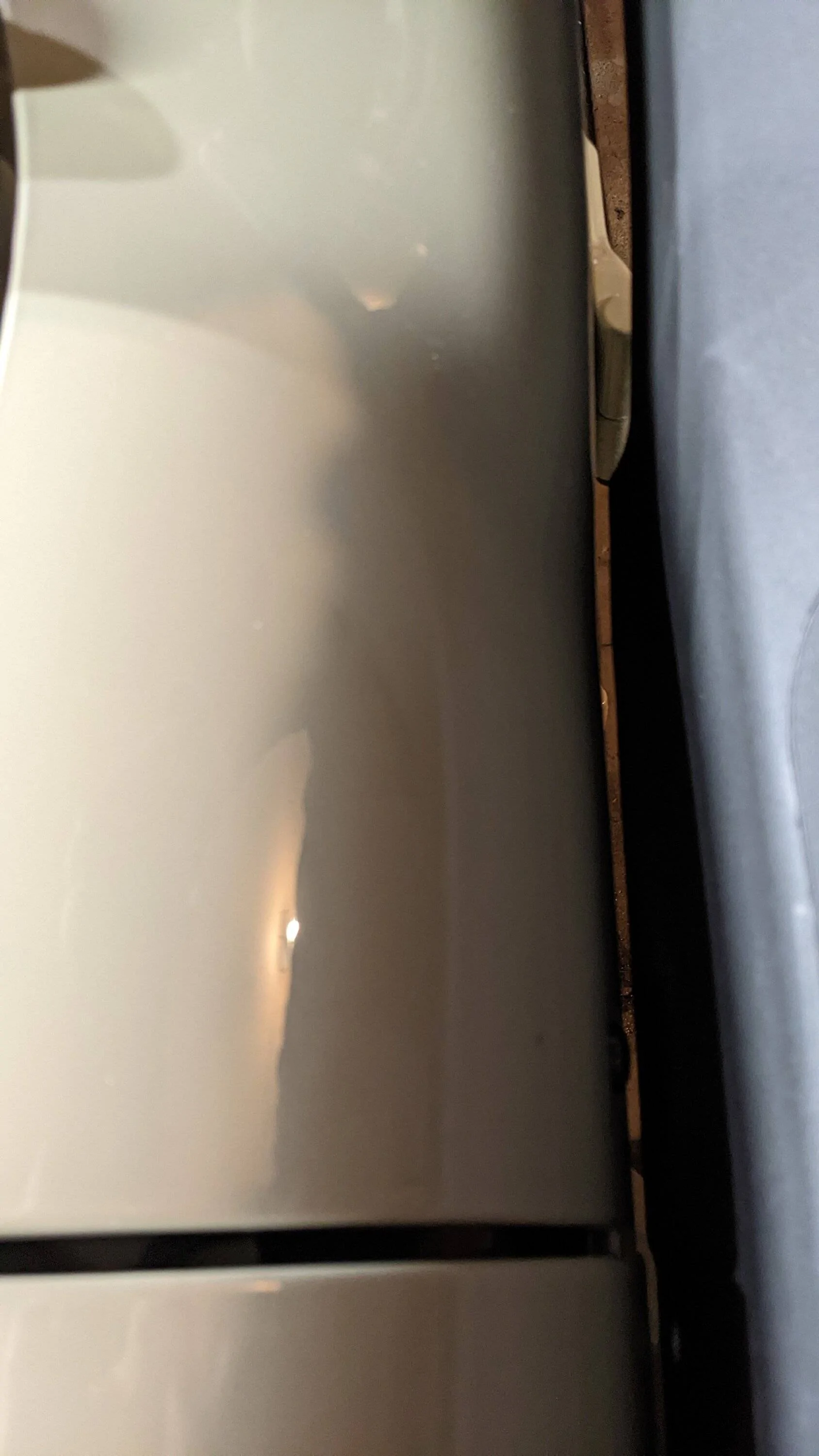

I'm just going to upload each of the pictures I took, hopefully they can kind of paint the picture. The windshield is to the top of all these photos

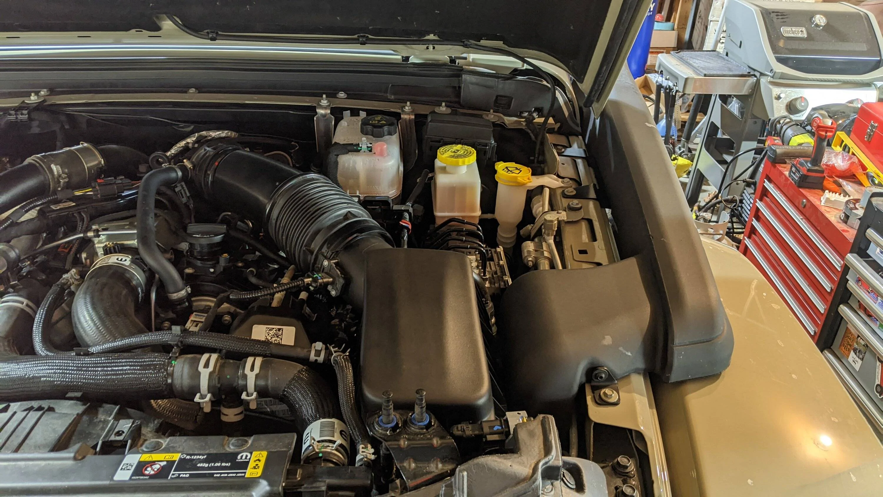

I don't want this thread to just become me screwing around with the snorkel and intake combos, but my CCV CEL came back after clearing everything and ensuring it was all connected up properly. I did discover that I was missing a piece with the AFE intake I had overlooked during installation because it was missing from the packaging and I chalked it up to outdated instructions. So while I'm waiting to hear from AFE I temporarily swapped back to the factory intake. I've got a 600 mile drive coming up this week and I want to be absolutely sure that the source of the code isn't the snorkel itself before I go on with swapping the AFE intake back on and ultimately the 9001R prefilter.
