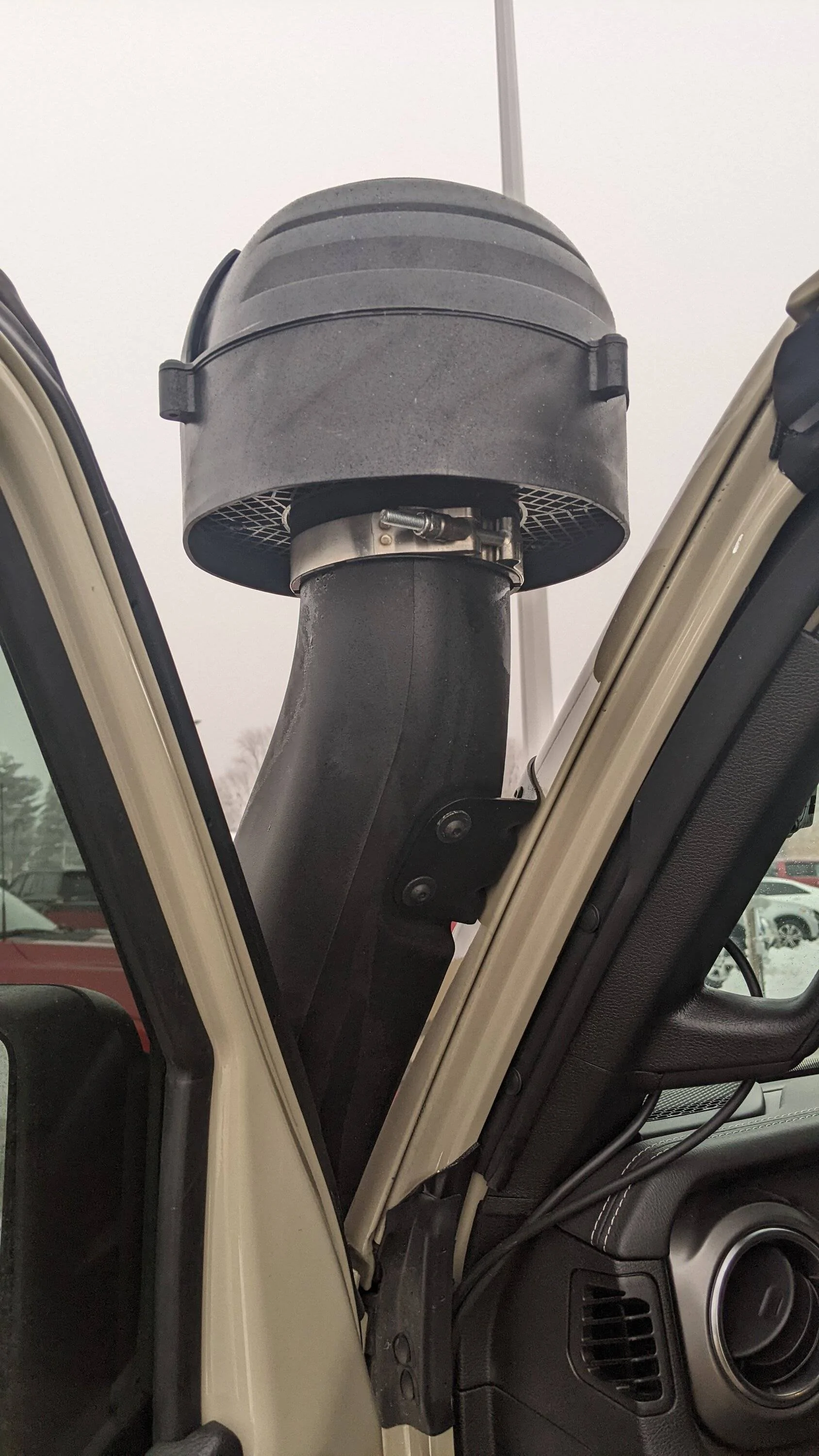

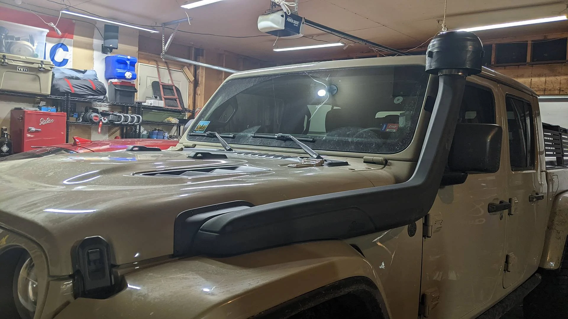

Stock intake setup with OEM panel filter and ram scoop pointed backwards, drove about 100 miles including some highway driving. No codes.
Sy-Klone 9001R prefilter with stock OEM intake and panel filter with 8000 miles on it. Only drove about 85 miles so far, including some at highway speed, no codes. Verified with scanner. OAT 0-25°f
I also don't recommend trying to take off the AEV supplied ram scoop band clamp when it's 20° out. It'll just shatter.
Knock on wood the pre-filter keeps up the good work, that would be great news!

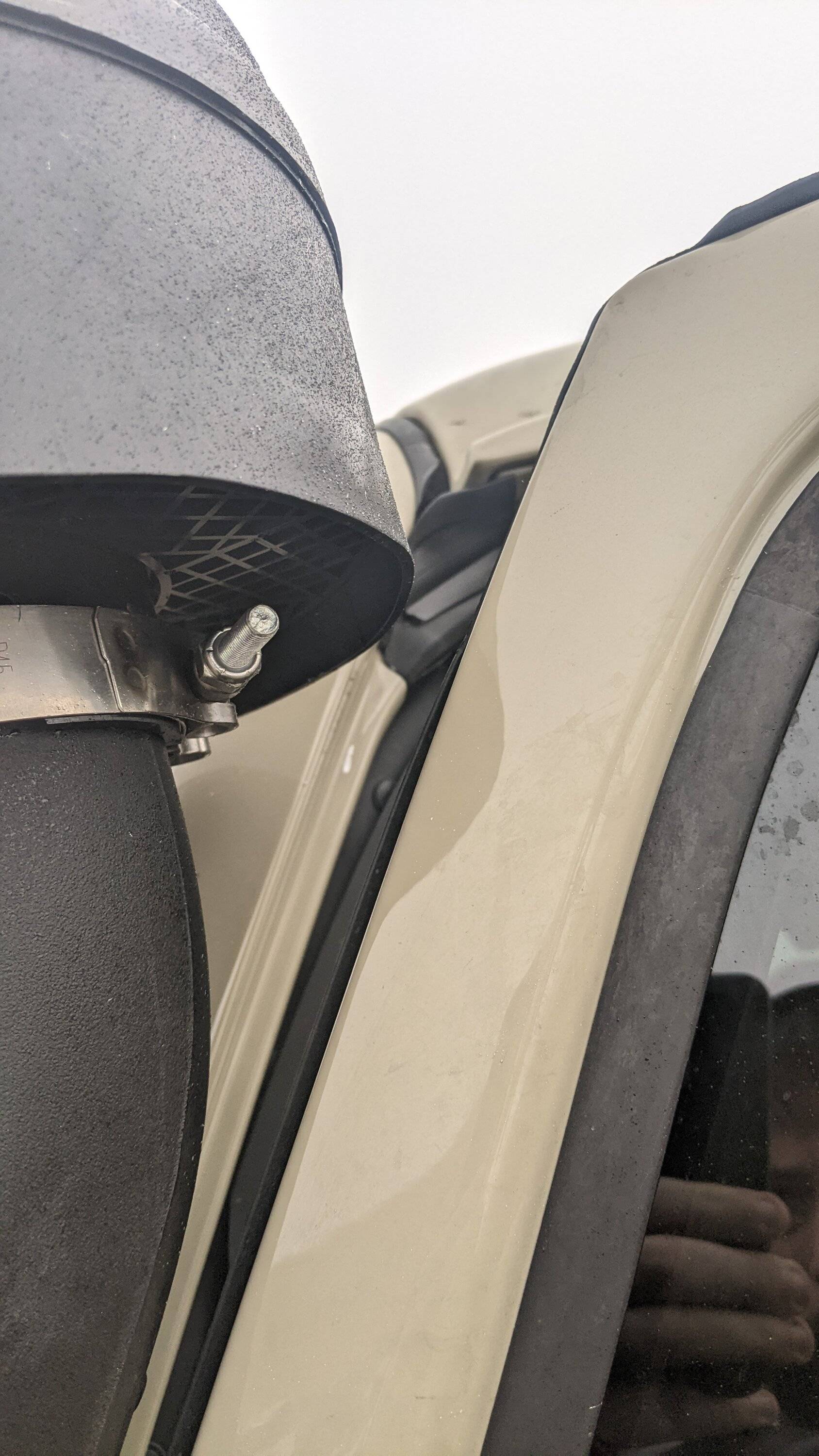

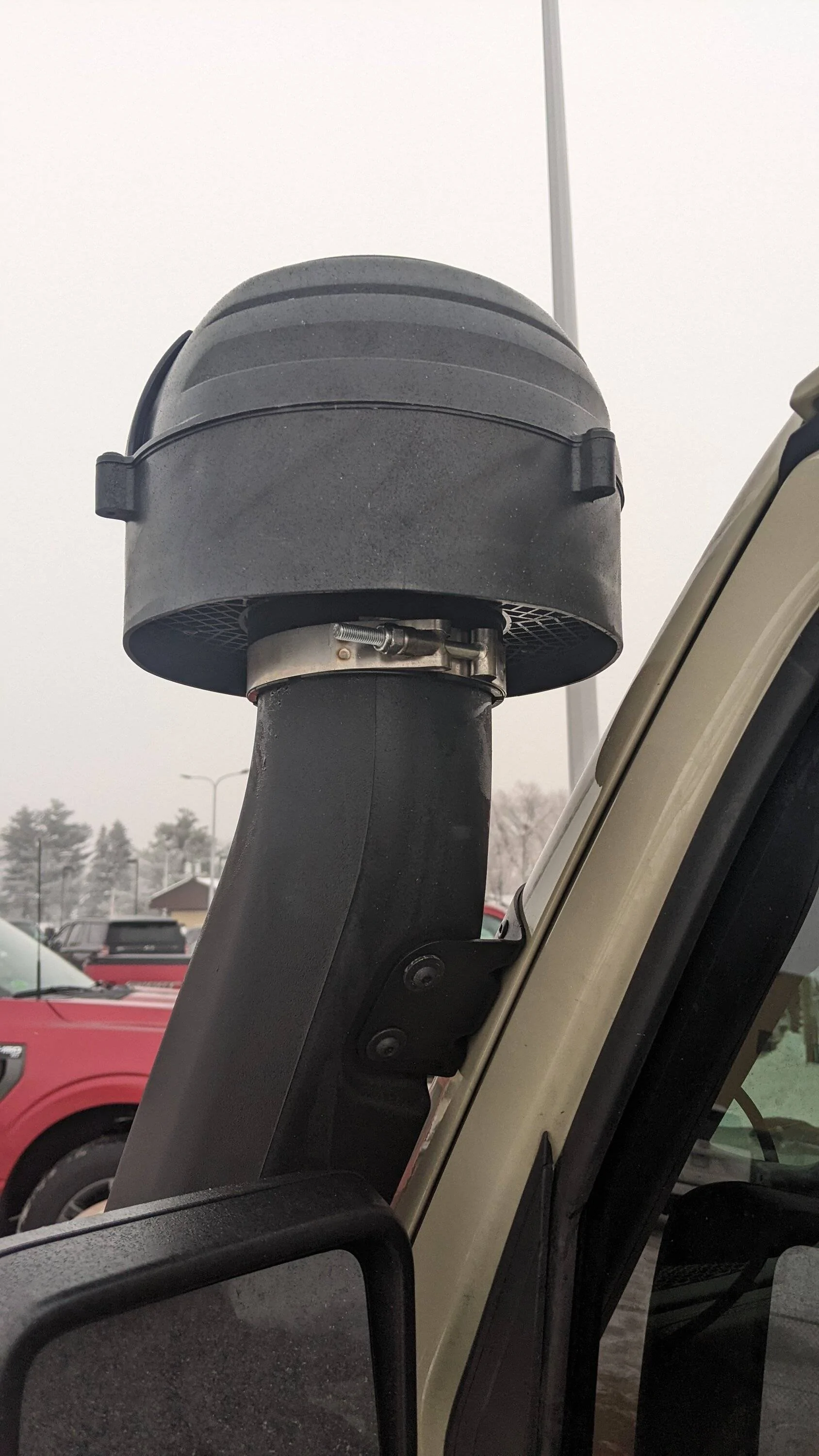

This looks sweet. No clearance issues ?
Clearances are all good, it's a tidy package for the size of it. I definitely think the larger Sy-Klone would look goofy, this one nearly does on it's own. These pictures are with the filter fitted all the way down onto the snorkel tube, so if you had for whatever reason an installation that tucked in closer to the windshield frame, or an A pillar bar for lights or something, or even if you wanted to run the bigger filter, you could move the filter up a couple inches to get some more space. There's a part of me that is tempted to actually trim the snorkel tube a bit to move it down some more. I haven't measured, but my guess is if you had a perfectly leveled truck, the Sy-Klone probably sits higher than the roof.
The Sy-Klone also fits looser than the scoop. It would probably tighten up just fine but to ensure a better seal I wrapped the intake tube in a couple layers of electrical tape to snug it up before tightening the clamp down.

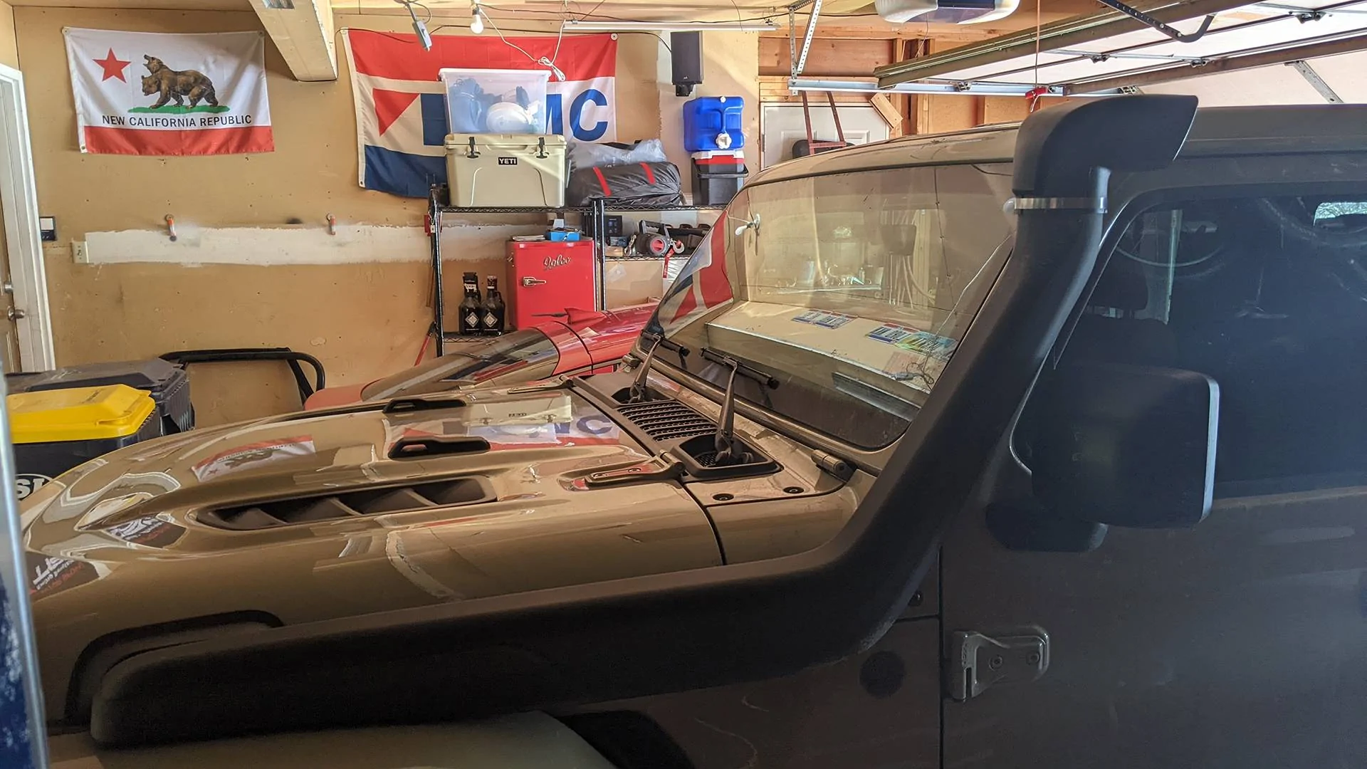

So has anyone ordered/installed one that has the low fender flares? AEV said it will fit, you will just have a gap between the fender and snorkel body.

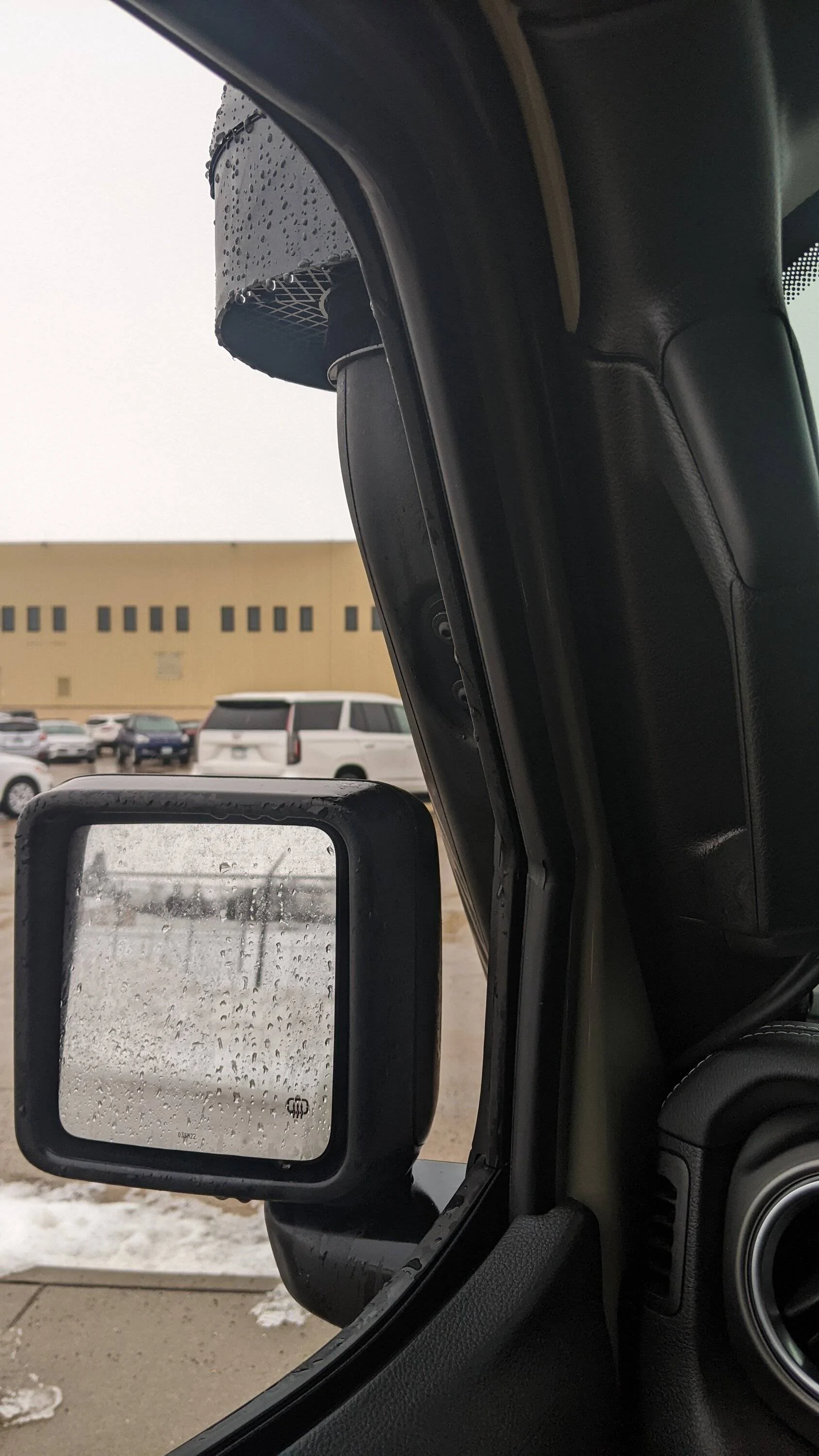

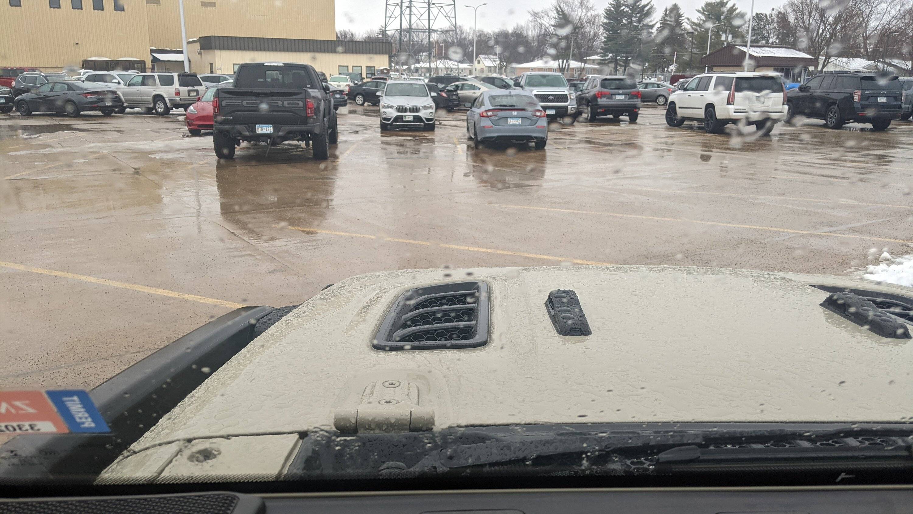

is the snorkel / Sy-Klone in any way distracting or in your field of vision when driving?
Field of vision, yes. Distracting, no, not for me anyway. It does block my view of the front left fender when trying to pull up close to something like the card reader at the gate at work, but not a big deal.
