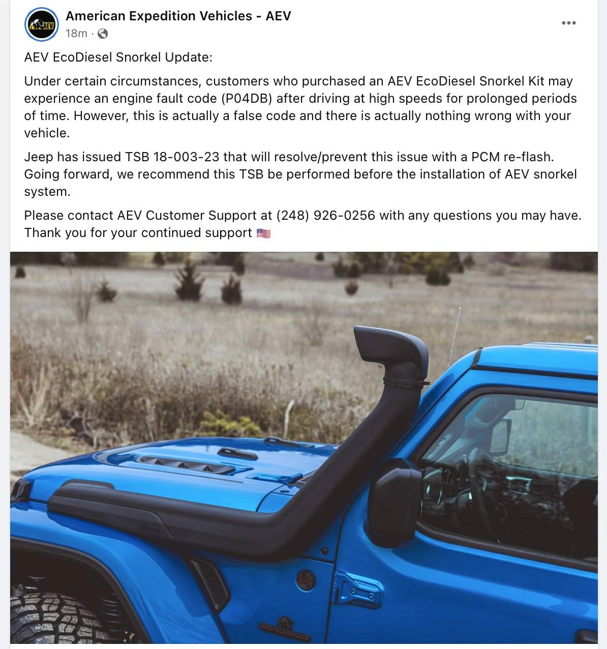

So I have had the same error as others here P04DB, hope I copied that down right. Anyhow we all knew AEV was working on it. Patrick just informed me Jeep issued a new TSB 18-003-23 that should take care of this issue. Apparently the CCV system was just a bit too sensitive. I plan to give it a couple weeks, then I'll hit up the dealer for the update. In the mean time, just turning the snorkel around has prevented the CEL. Great job following up AEV; excellent customer service.

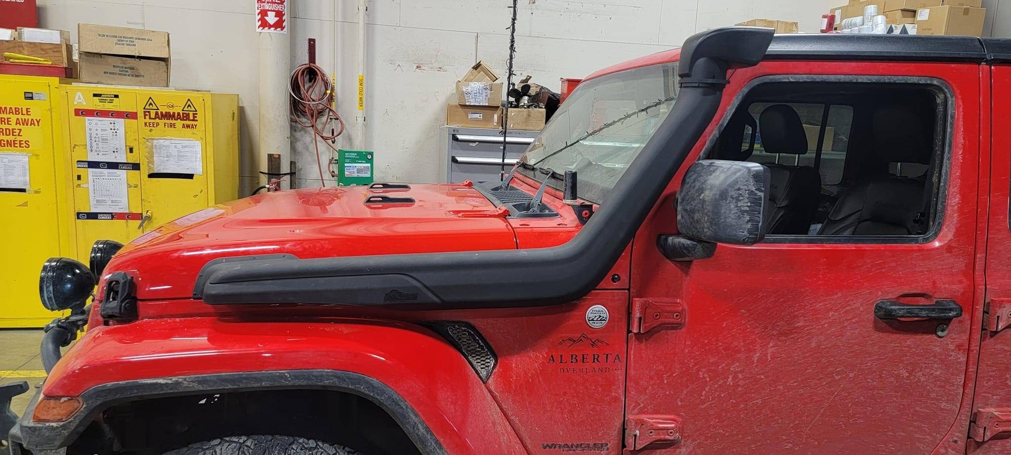

I’m still waiting for someone to install one with non-high fenders. ?

Someone posted on the AEV Facebook page.
Perfect, its even firecracker red like mine. Defiantly a gap, but not too bad. Hmmm.

Pretty solid solution. I've had my snorkel waiting to install to see how this played out.
Do you think AEV was the one with the pull to get Jeep to offer the TSB? Pretty nice partnership if so.

For sure. AEV employs a few former Jeep people. So there's defiantly a strong connection.
Not bad at all. If I wasn't aware that the intended design application didn't have a gap I would have thought they designed the gap intentionally so that pebbles, mud and sticks could still easily be cleared off the fender come clean-up time.

If anyone gets TSB 18-023-23 done post your PCM software version they applied, it will be on your service work order. Eg. 68353396AH is what mine was updated to 2 weeks ago when my service dept updated my PCM for another issue.
