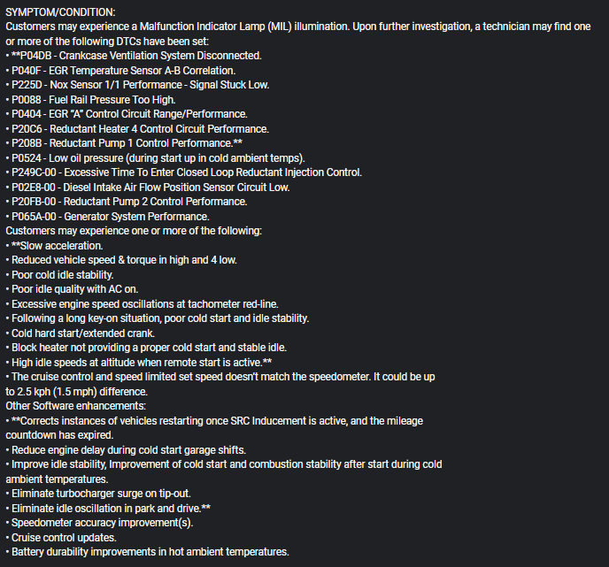

Tell your dealer you have these issues as I just had my 2021 Gladiator diesel PCM updated to version 68353396AH from 68353396AG a month ago on warranty.
Complain about: Low battery voltage issues when putting the car in ACC mode (ie engine not running), as well as auto stop start working intermittently if at all.
My service order shows:
Cause: customer concern on battery low voltages found bulletin number: 18-002-22 Rev A related to a PCM software update for Battery improvements. Will need to update PCM to latest software.
18-19-04-TE
So far I am seeing less battery drain, very consistent voltage at 12.6ish where before it was constantly being dragged down in a couple of days, start stop is working consistently, I am pretty sure my mileage has improved (need to monitor this further). I am pretty sure my adaptive cruise control is not near as jerky (touchy) when it needs to slow down as it applies the brakes now.
BTW no idea if whatever the fix is for the snorkel is part of 68353396AH but reporting those issue might get your PCM updated to the latest version.

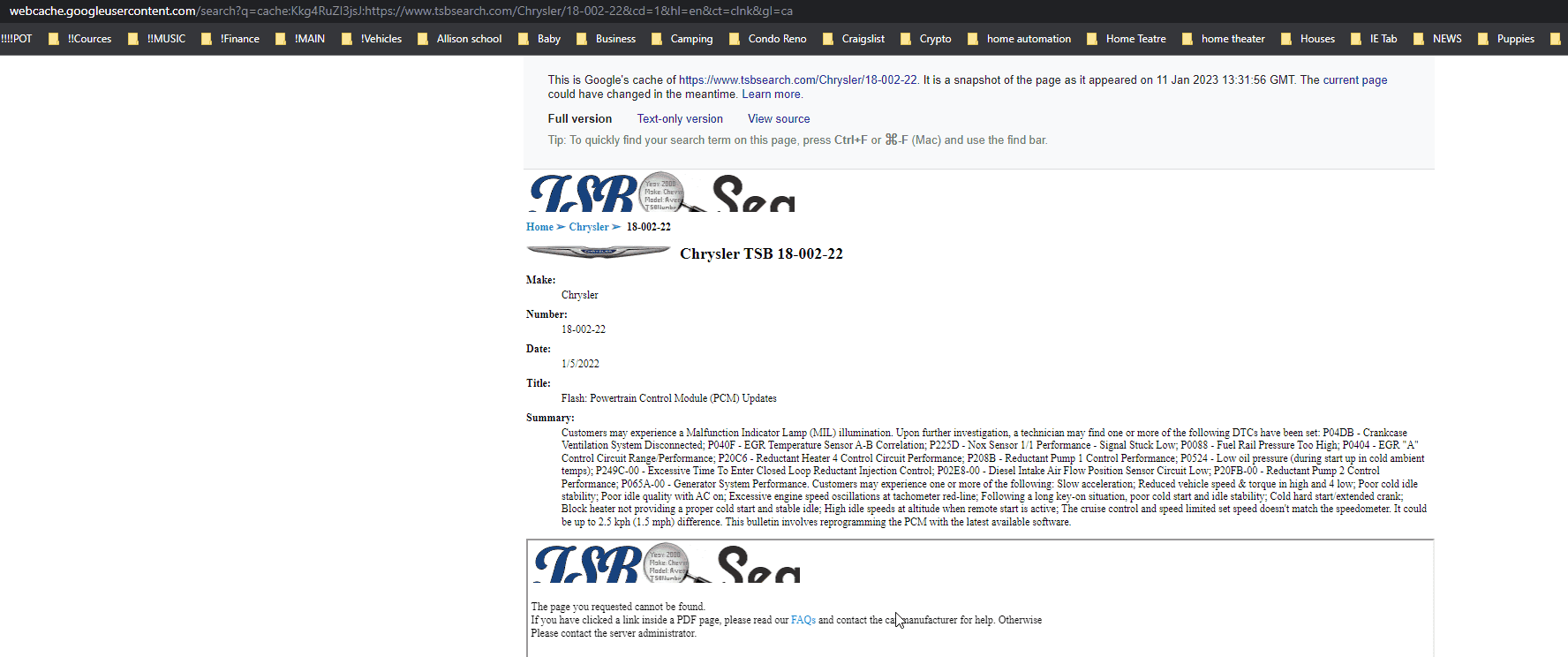

Can't find the full source I got this list from for 18-002-22 Rev A, but this is what I found a while back.
18-002-22 Rev A
Jeep Gladiator JT Diesel Snorkel 1677737991466
Partial result of the list above can be found online here:
Partial results for below on a cached google page
https://webcache.googleusercontent....m/Chrysler/18-002-22&cd=1&hl=en&ct=clnk&gl=ca
Jeep Gladiator JT Diesel Snorkel 2023-03-01 22_13_51-18-002-22 Chrysler Technical Service Bulleti

Great information, yes who knows if CCV sensitivity is part of that PCM update. I'll give AEV a chance to come up with the fix. But if takes too much longer I'll try your suggestion hopefully it works.
Of note, I just re-read the TSB 18-003-23 and on the last page it says "POLICY: Reimbursable within the provisions of the warranty" So should be a no cost to customer update. I'll have a little discussion with dealer about that.....
I would post the TSB, but document says it can't be reproduced without written permission from FCA US LLC?

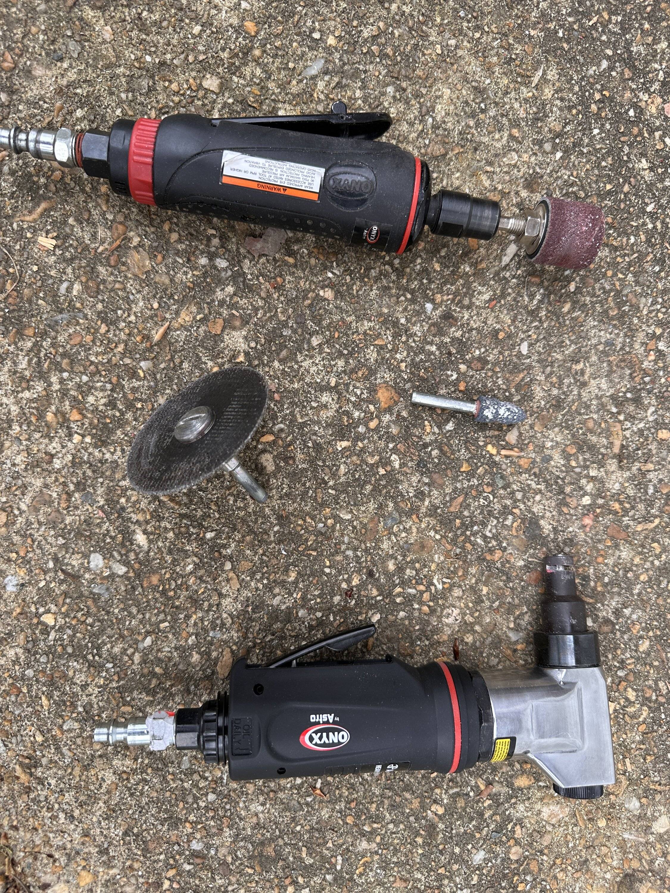

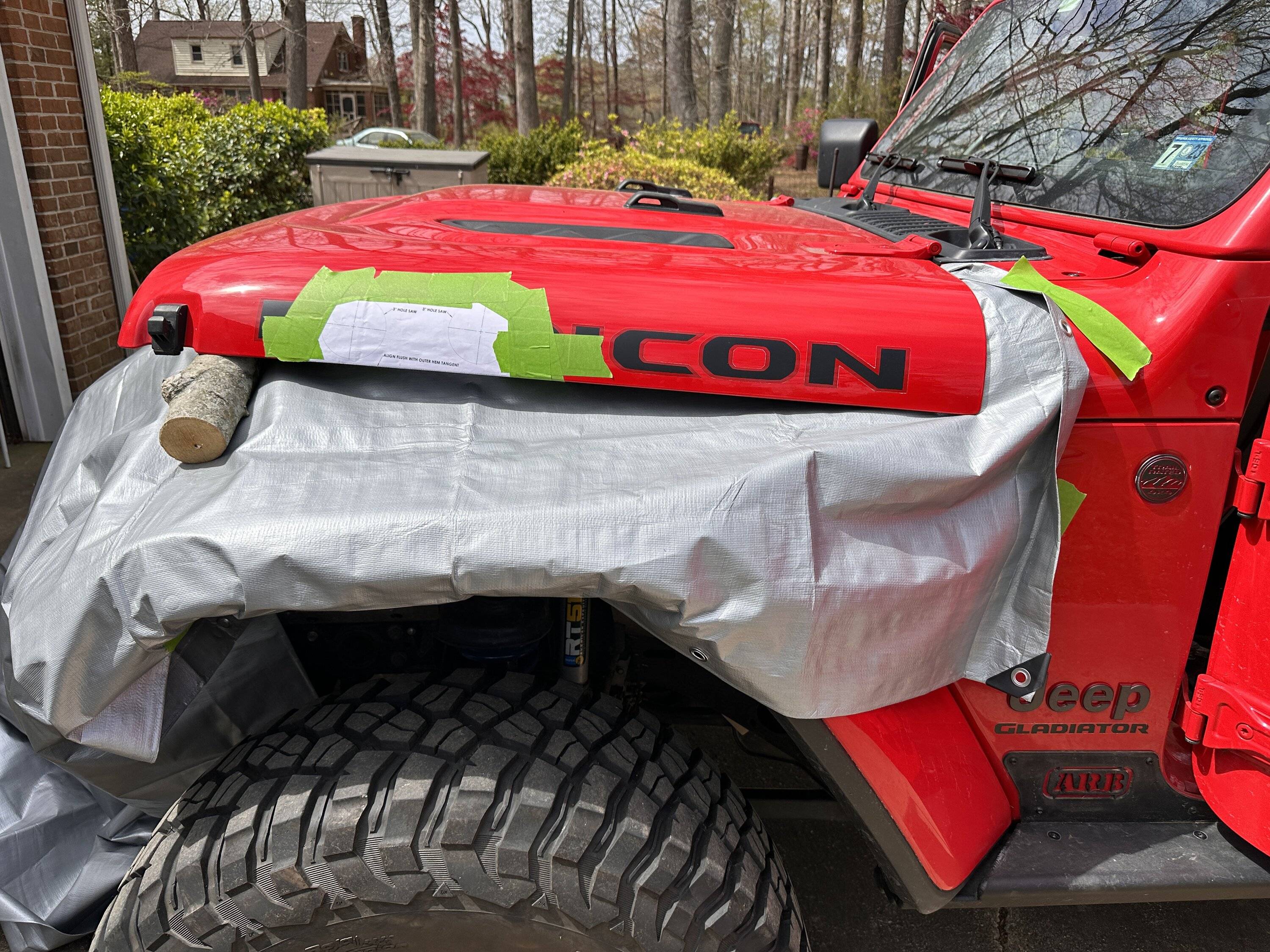

Done. Sounds like Darth Vader breathing through a cardboard shipping tube, i.e., awesome! I immediately went to a brewery and drove conspicuously around the parking lot looking cool like a guy with a right hand drive overlander, then walked up to some girls and did my best fake Australian accent. This is definitely a good snorkel setup. They did call the police but I later realize I was covered with black RTV silicone sealant. That’s probably why.
Here’s a couple of amateur tips, because pro tips cost money:
  • I used an air nibbler to make many of the cuts, mostly because I like the idea of using a tool called a “nibbler.” It makes nice clean straight cuts as a side bonus. Astro Pneumatic Tool 727 ONYX Heavy Duty Air Nibbler https://www.amazon.com/dp/B01JBO3G2O/ref=cm_sw_r_cp_apip_u3UE6GyzxMYVW
  • Use a spring punch and pre-drill any holes. The hole saw center bit will walk on aluminum.
  • Use a quality hole saw like a Bosch, not some rando Higggarrrr knockoff from Amazon
  • I covered the whole engine bay with a cheap $5 tarp from Ollie’s
  • I used a die grinder with 3” disk for most of the rest of the cutting. IMO, a larger angle grinder is too much
  • You can smooth the metal down with a small sanding drum. These aren’t just for wood.
  • Toss your grinding points when done. Aluminum contamination can cause them to fail/explode later when grinding steel or tungsten.
  • I used a little deburring tool on my rivet holes. MAVAST Deburring Tool with 11... https://www.amazon.com/dp/B087644YQH?ref=ppx_pop_mob_ap_share
  • Pre-fit and leave in all the rivets before securing the first one. I used this tool which is okay with some tcl, oil, etc. Astro Pneumatic Tool 1423 1/4" Heavy Duty 13" Hand Riveter https://www.amazon.com/dp/B0039697ME/ref=cm_sw_r_cp_apip_9lCnSOWdmXeES
  • Don’t attempt this if you live in South East Virginia or make any plans at all really, because it WILL rain as soon as you do (if you can fit the Jeep in a garage, you don’t have enough cool stuff.)
