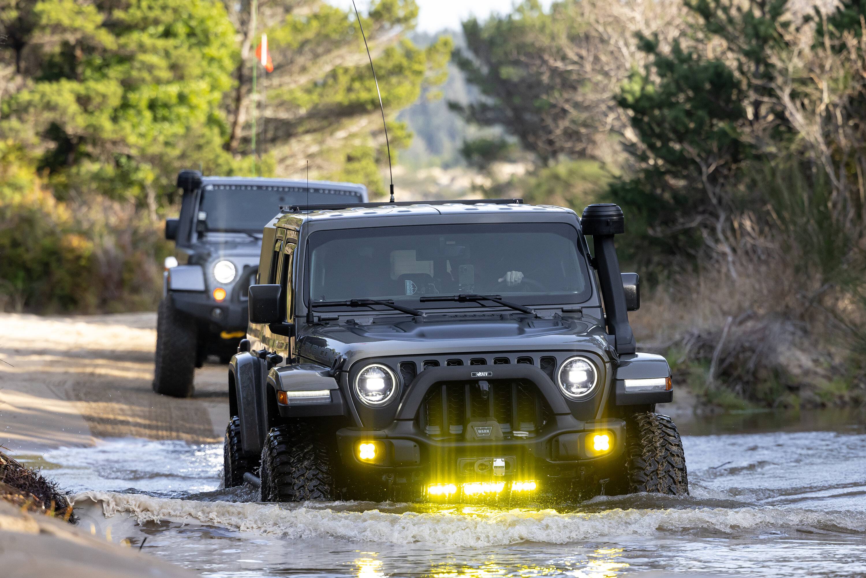

Extremely disappointed with how AEV is handling this. I ordered the snorkel the day they were available on the website. I received it within a week and had it on within 2 weeks of ordering it. Of all the companies that make aftermarket items I thought they would have tested this item. If they had at all they would have seen the CEL issue from this. I got it on my first drive over 35 MPH. Contacted them multiple times with updates. Have been told they would contact me back and haven't received a phone call from them yet. It's a shame you have to cut your hood for this product because if I hadn't had cut it this would already be removed.

Same boat as you except I waited to install and I'm glad I did. The cutting into the hood and more importantly drilling into the a pillar made me hesitate. I guess now I'll just sell it.

So they're not going to fix it? @Zach32 are you also running the sy-klone thing?
Could be that the amount they sold already offset the R&D & part cost, and they will kill the product and call it a day. Or they play the long game and do more R&D, fix the flow issue, or just ship the snorkel with the sy-klone and drop their pricing a bit since the sy-klone adds more than $200 on a $600+ snorkel, which is already pricey.

I have had to call multiple times and they haven't said anything about fixing it, also not sure what they would do, maybe add baffles somewhere and send a new product to everyone that already has it. Apparently you can add the sy-klone and it fixes the issue, just a bit of a bummer I have to spend $250 more to fix AEV's product they are selling and knowing it is causing issues. I will probably avoid buying anything from them again for a couple reasons. One is they aren't doing a great job trying to remedy the issue, two that fact that I have to keep reaching out to him because the representatives are "busy". Its like once they sold they product and got the money they don't care about supporting it.

Sorry to ask , but I am really lost. what it is really the issue. And how to fix it.

the issue is that that normal Ram air top on the snorkel is causing people to throw a code for I think too much air flow? I think the code is supposed to alert you to your air filter missing if you forgot to put it back in. The Ram air effect causes the airflow to trigger this code. You can solve this by turning the ram air scoop 180 degrees so it draws rear facing, or get the pre filter which eliminates the Ram air effect entirely.
Honestly not sure why some of y’all are getting so bent out of shape over this, there are three known fixes now between turning the ram around, using a cy-clone, and getting the computer flash from Jeep.

Seriously. They’ve already issued the fix and people are still on here crying about it. If you haven’t installed it and don’t want it, sell it. If you have, there’s a fix. I’ve had it for a while and have had zero issues with it and have driven it thousands of miles on multiple terrains in multiple weather conditions. But people will buy an overly priced lightbar that they’ll use once a year at most.

The flash doesn't always fix it plus only for certain years so for some you have to pay for that flash.
Turning the intake around can cause engine damage in certain circumstances. Improperly setting it up is not a fix, it's a band-Aid.
Having to buy another expensive part to make an already expensive piece is also unacceptable. Plus I personally don't like the mushroom look.
On top of all of this, none of it was advertised of needing anything else. I thought higher of AEV...learned my lesson.
Glad you aren't having problems but many others are.
