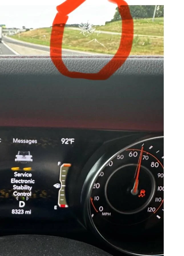

I had that code pop up at 83 miles on the the way home from Santa Fe, truck ran fine and made it all the way home. I pulled the code when I got home and cleared it. It was snowing to beat the band when it threw the code and the code definition is

Thanks Greg good to know that you made it home, im half way pissed off at myself at the time it happened and where it happened than jumped the gun taking it in. Haha damn Jeep windshields love to have stars!!
