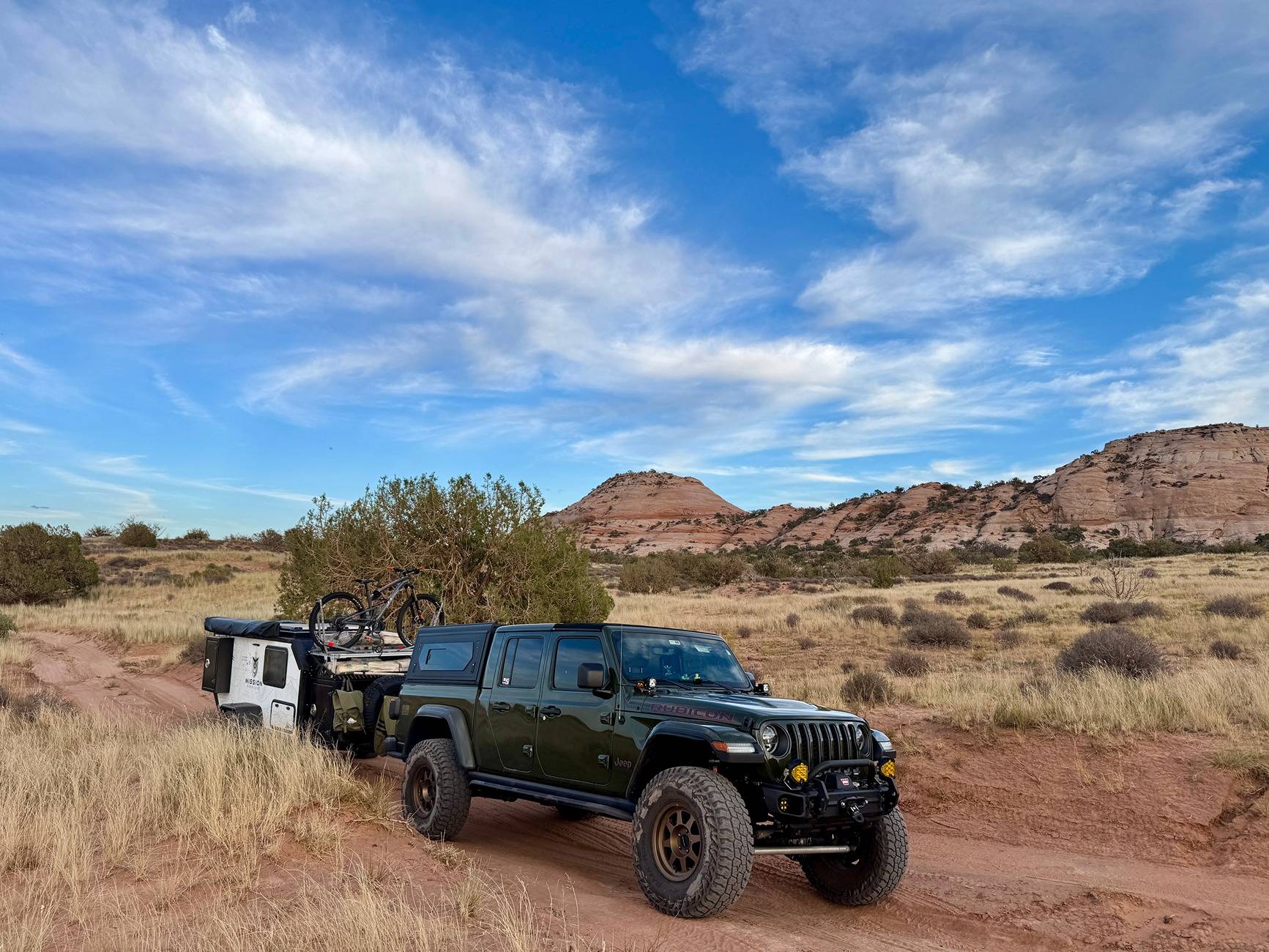

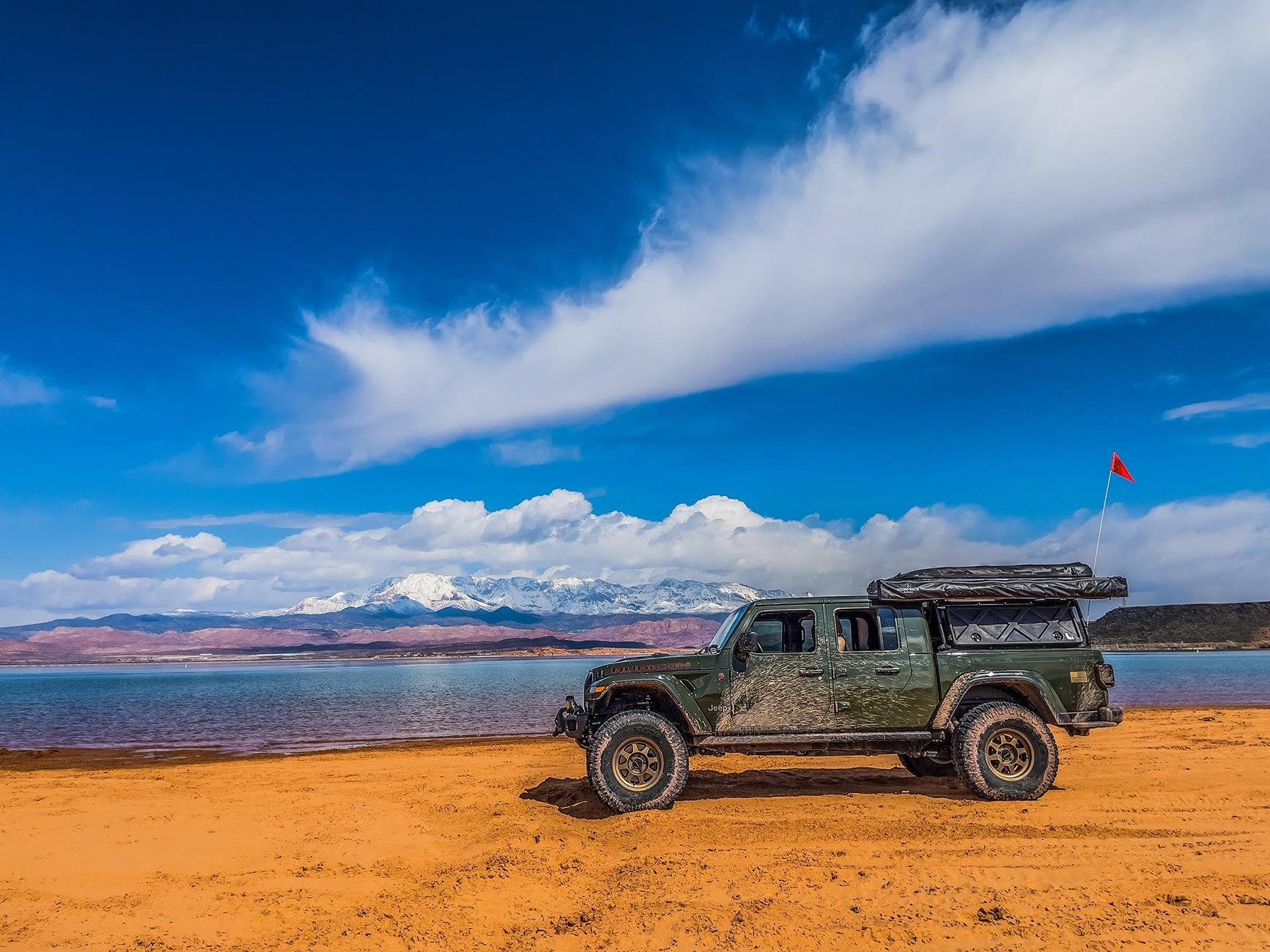

Just hit 63K miles on my ’22 JTRD. Lifted it at 3K miles, originally on 38s, now running 37s. Still on stock gearing, but I do have a Pedal Monster. I live in Denver, so all my driving is at elevation with plenty of elevation changes.
Originally, I ran a bed rack with an RTT, but I’ve since switched to an Alu-Cab canopy and tow an overland camper. The only time I de-rated was while towing (~3,500 lbs) over Vail Pass in the summer. That was partially my fault—I was pushing it too hard speed-wise. Naturally, diesels run hot over mountain passes when towing, but if I take it easy and lower my speed, she cools right off and does just fine.
As for re-gearing, 4.10s are the closest to factory ratios for a diesel on 37s. I don’t plan on going any taller tire-wise, and honestly, as many have pointed out, going from 3.73s to 4.11s is such a small change that I question whether the cost is worth it. That said, AEV runs 4.56s on their diesel package builds.
My advice? Drive your rig and see how it performs. The Pedal Monster made a huge difference in drivability—it completely eliminated the low-RPM lag that's programmed into the throttle map. Highly recommend it.
Ultimately, with the weight of your camper and how often you tow, 4.56s might be the best option for you. There are also multiple threads with small hacks to help the diesel run cooler. Some popular suggestions include removing the engine cover and opening up the hood vents to improve airflow.
