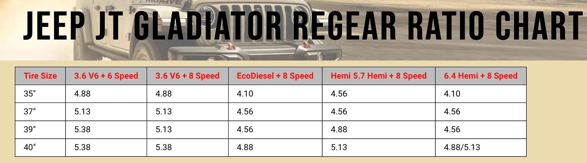

Jeep Gladiator JTRD on 37" what ratio 4:56 or 4:88 1735003749729-ga
This is from Exodus...
https://exodus4x4.com/jeep-regear
They have good videos and info regarding regears. Bubba’s other videos are a great watch too.
I had them give my diesel 4.56 gears after the lift and 37’s. Runs like a champ. Average around 19mpg and pulls a flatbed trailer no problem. I see all 8 gears.
You definitely have me beat on the mpg as I only average 14, on stock 4.10s and 37s from the gasser in the mojave. Still pulls a trailer just fine too. Personally I wouldn't bother regearing the diesel for 37s, and the people selling you the gears and install probably have a bit more motivation to tell everyone they need gears. I mean they recommend a regear for 35s in the diesel. I still see all 8 gears too.
Based on everything I have seen this chart is a little overkill unless you’re not planning to drive on the road maybe.
