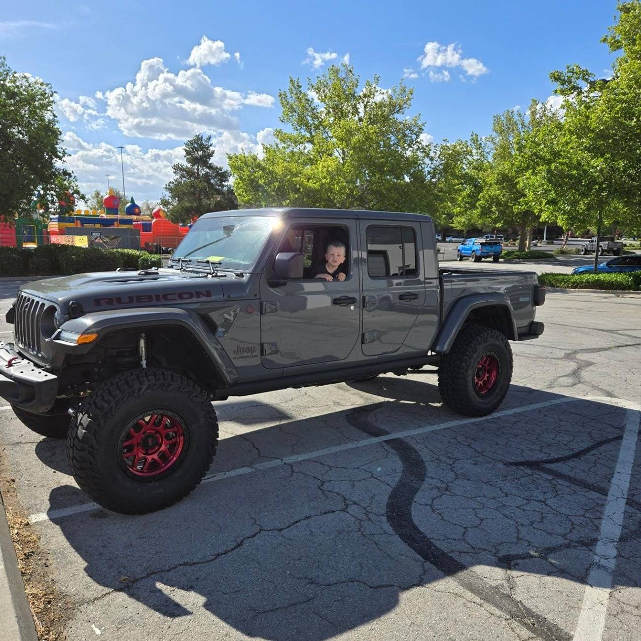

I have a 22' JTRD, running a 4.5" M.C. with 38's, stock 3.73 gearing. Yes, you do have to be easy "off the line" but I can still get it into 8th gear if i try. I maintain anywhere between 18.4- 20.3 mpg.
May regear to 4.56 someday, but that won't prob be till I go to 40's.
If anyone is concerned about "off the line" performance, prob should've bought a TrackHawk. ;)
Once you go bigger tires, I would focus on Steering & Braking improvement. They will suffer for sure.
It's still a great platform, once you deal with the HPFP.

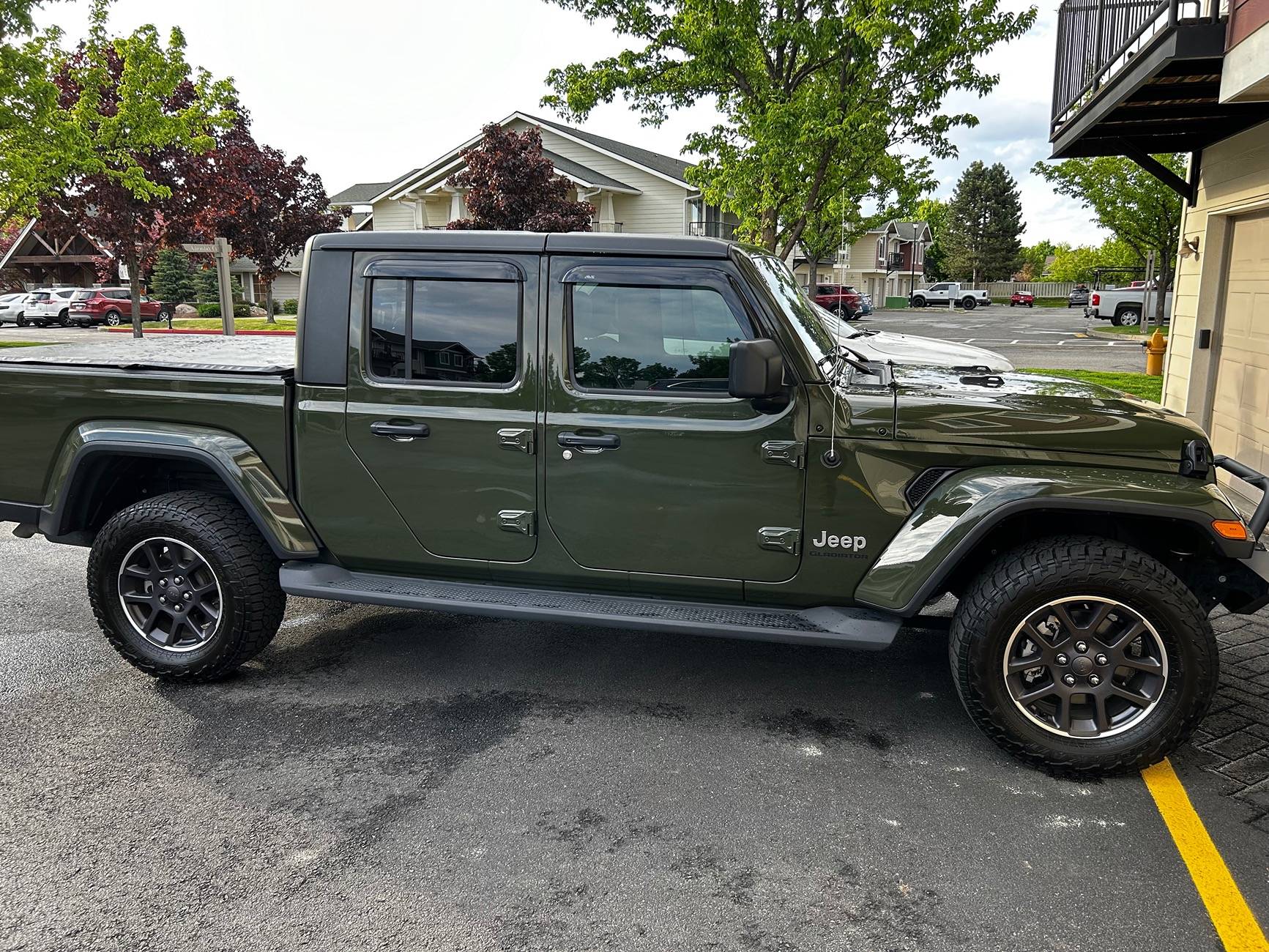

Yall think i can fit 37/12.5 on 4.5 front 3 inch rear lift on jtd Overland non rubi so not high fender

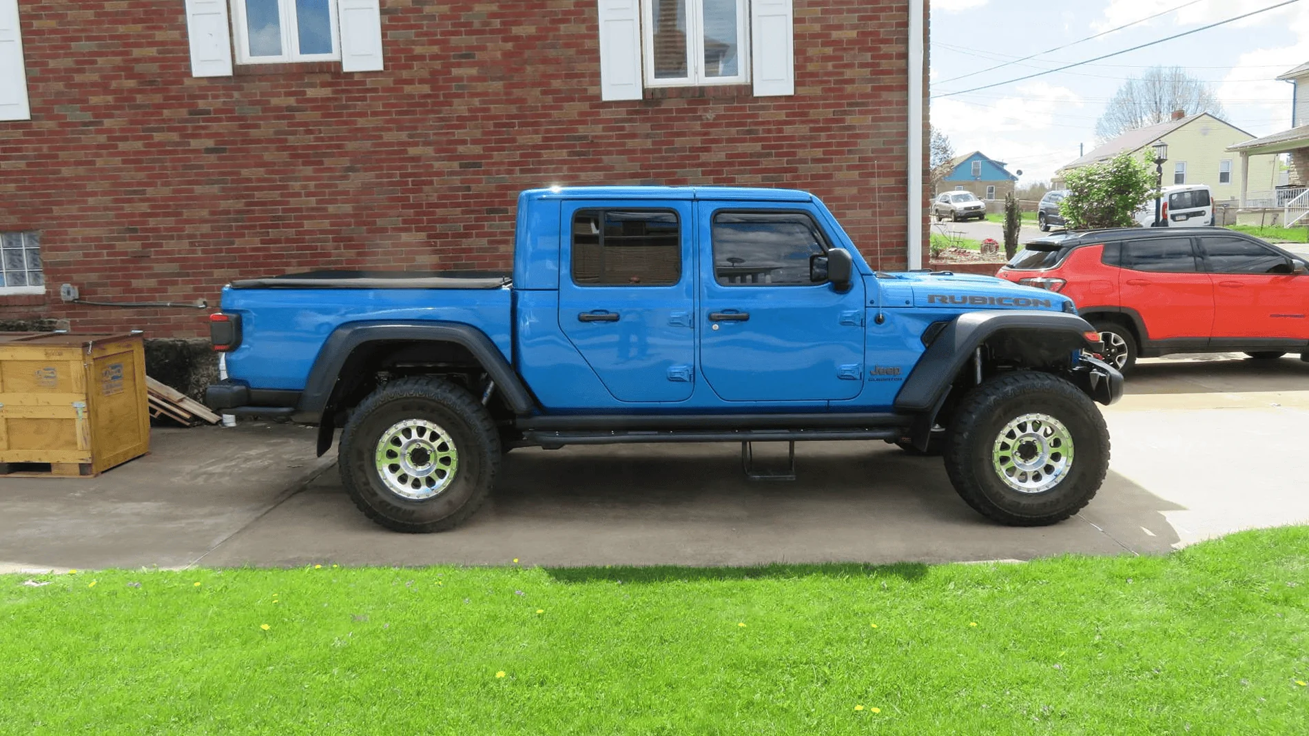

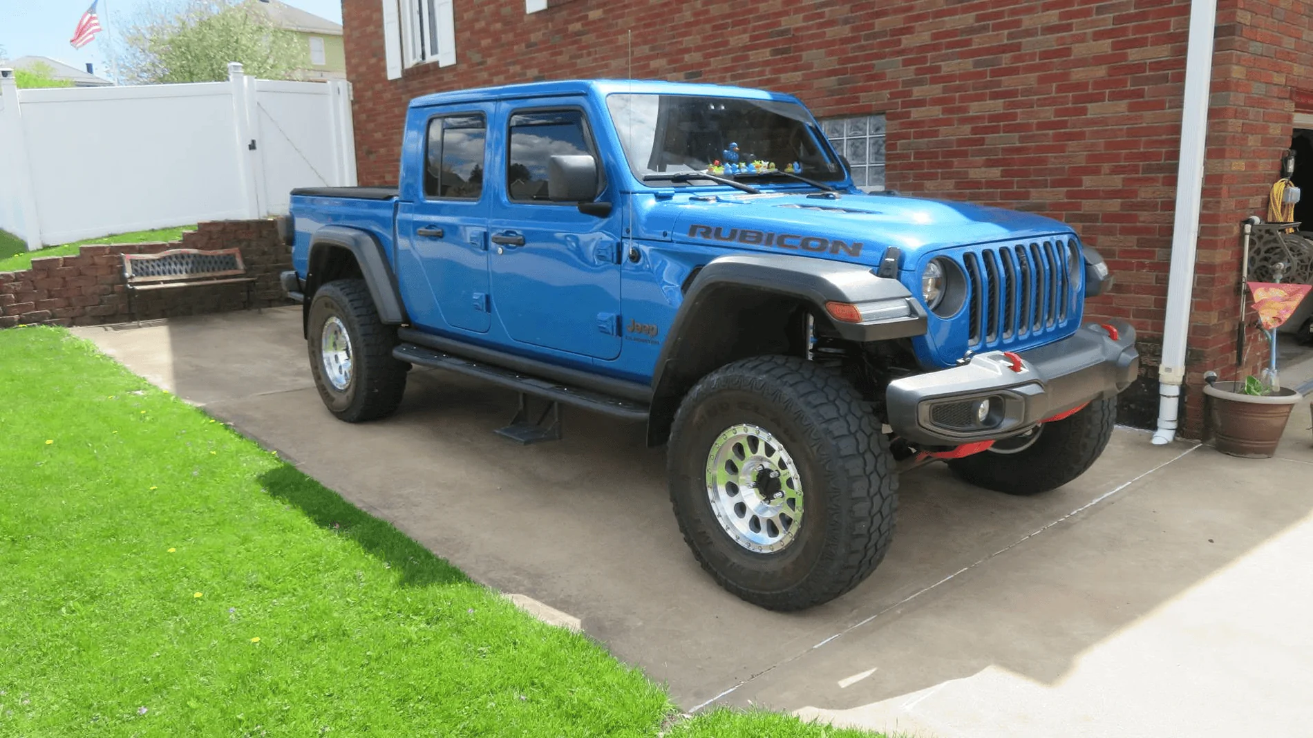

I am pretty sure you can. with that much of a lift. Stock rubi I slapped on 37's with no issues. so with your lift I would imagine you'll be good. I am now sitting 3.5 Clayton Springs.

Yeah....no problem. I have about 4.5" lift in the front and 3.5" lift in the rear. with plenty of room. You will need 2" bump stops. If you want a good ride. I would recommend geo brackets in the front and a track bar relocation kit in the rear. I went with Teraflex for both.
