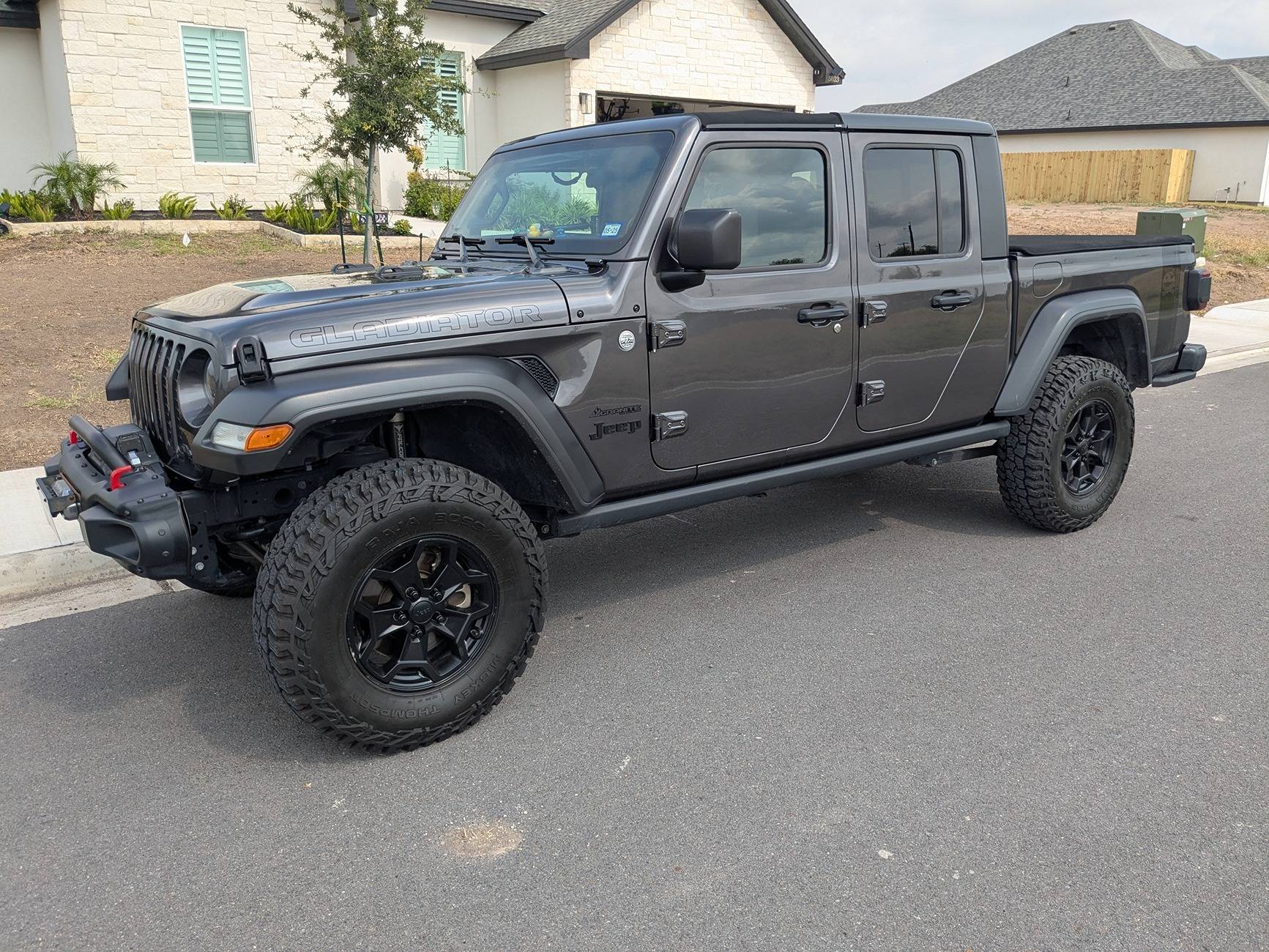

35" Mickey Thompson Baja Boss AT 255/85R17 pizza cutters fit nicely on stock rims. I am, however, running a 3.5" lift. Mine is a Sport S, no max tow, so regular width axles.

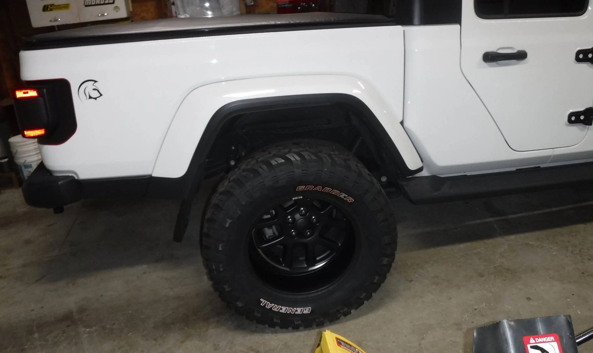

I'll be running some "Pizza Cutters" on stock rims, 275-70-18 in the winter.

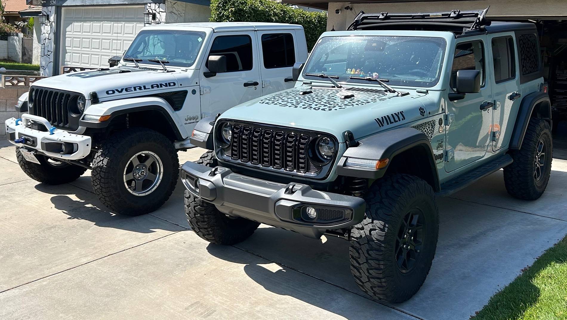

Yeah… just like the internet says, you can’t run a 12.5” tire on a stock 7.5” wheel 🤦‍♂️
