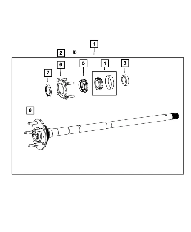

Has no one just pulled the stupid leaking axle shaft to see for themselves what the issues is? Burs on the seal surface, bend shaft, poor seal install ect ect.....
Replacing a seal is not rocket science, your telling me a place like parts plus or a bearing house can't find a replacement seal for these axles and it has to be a mopar part?
The hardest part of the operation is getting the bearing lock ring off.
