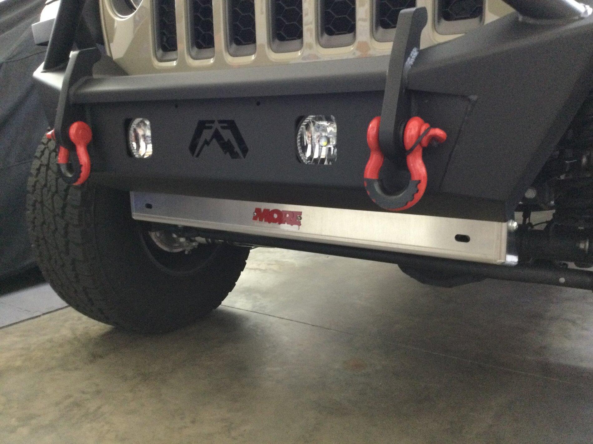

For those of you running an aftermarket bumper without front skid plate you may have noticed, as we have, that there are sections of exposed frame that protrude down past the bumper and almost looks like something is missing. We have been looking into a solution to fill this space and would like to get some feedback on this concept we are working on.
Here you can see an example of a JL with an aftermarket front bumper.

The position of the light is optimal for lighting the road. For instance, a roof mounted (A-pillar mounted, hood mounted, etc) bar needs to point downward in order to light the road. Because it is pointing downward the projection distance is overall limited. The projection distance from this lower position is optimized so it can be a fixed mount which projects directly down the road for optimal distance and functionality.
Jeep Gladiator LED Aux Light Integrated Front Skid Plate Concept 7831258D-FEBD-471D-929D-3468D650F050
Installation would be very easy for this design. Mounting involves simply bolting the skid plate into the existing threaded inserts in the frame. Wiring would also be simplified with a wiring harness designed for the Wrangler/ Gladiator which would be very close to a plug and play solution which would include a switch module and can work with the factory AUX switches.
The LED light modules would be made up of individual 30W 2" LED emitters. These ORACLE exclusive LED emitters are extremely powerful and have a very nice blacked-out appearance. The benefit of individual modules opposed to a single light bar is:
1) Preserved more steel plate for increased durability and functionality of the skid plate.
2) Modules can be replaced if damage (rock chip, etc) were to happen opposed to a full light bar which would ruin the entire unit.
These 30W LED modules produce approximately 2,200Lm each giving the setup a total of 15,500 Lumens.
