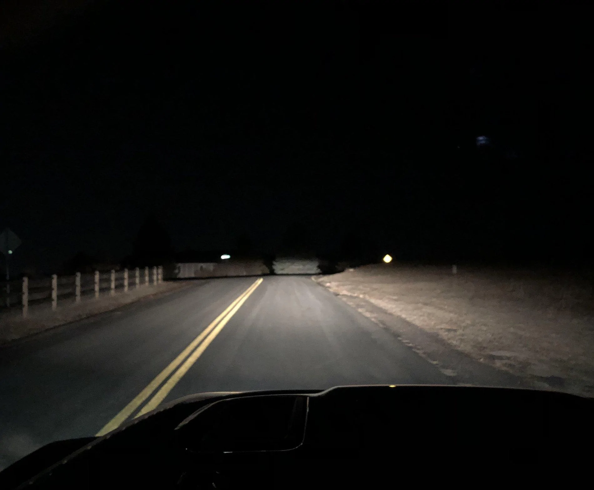

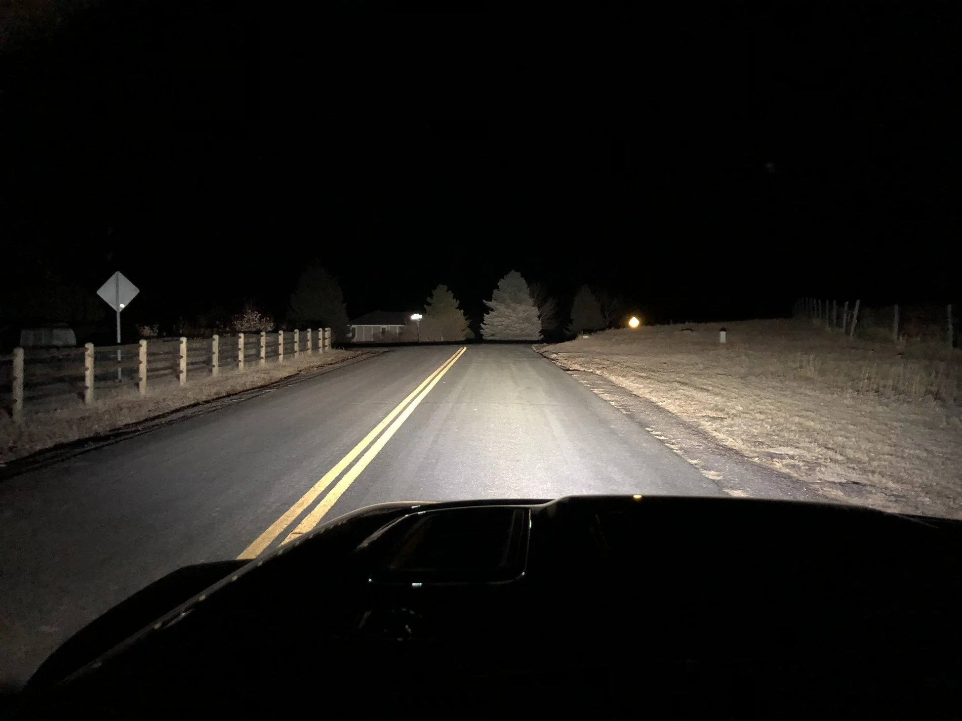

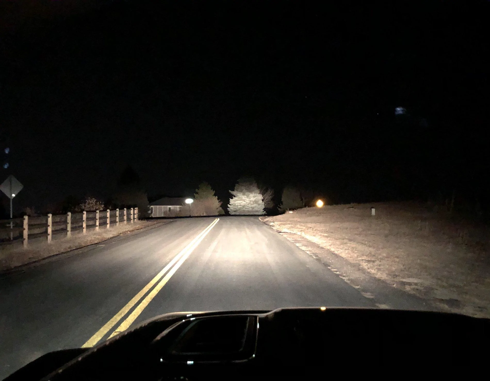

You got any pictures of the bulbs you mentioned, night shots?
On a rural road near my house with no streetlights. Pointing up a hill. (These are the Halogen Sylvania Silverstar Ultra for context, not LED.). Low beam:
Hi beam, you can see further up the pine tree:
I don't have a "before" of crap stock halogens. But here are my 6" Rigid 360's with driving pattern pointing at the same terrain:
I could never find a lumen rating for the Silverstar Ultra, it comes up as "1000" but that is the same rating as the Sylvania stocker replacement standard bulb. Can't be correct. It's quite usable light, around 4100 color temp.

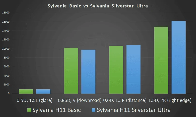

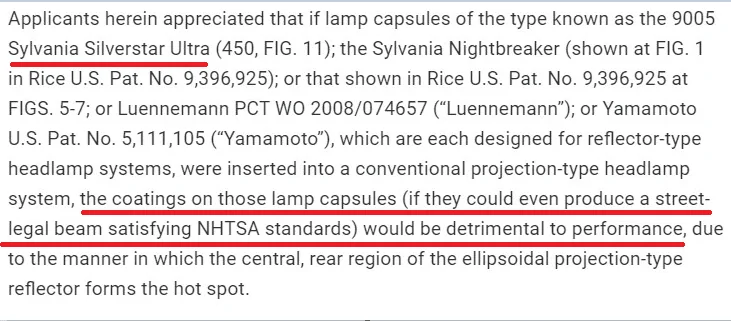

The "1000" lumens is a nominal figure that all H13 bulbs' low beam filaments are supposed to roughly meet, give or take a few percentage points.
Sylvania knows very well the actual number of lumens, but won't publish it because it's not flattering.
Silverstar Ultra bulbs are not much better than their Sylvania Basic bulbs.
For one, Sylvania itself says that its Silverstar bulbs could cause headlamps to fail minimum legal standards.
Here's some independent testing on the Silverstar bulbs compared to the cheaper, basic bulbs.
There's a reason the Silverstar bulbs seem brighter--it's because they emit slightly bluer/cooler white light than standard bulbs, and our eyes at night have a heightened sensitivity to blue. We perceive light with larger components of blue as "brighter." That's why a lot of people complain about glare from LEDs or HIDs--those are two pretty blue light sources. In fact, studies found that HID headlamps generally produce less glare than halogen headlamps, but the bluer nature of HIDs made people think they were getting hit by a stronger, brighter light.
I don't know what your point is dude, I drove with them and they are nice and bright. And regarding your 'alarming' red-underlined paragraph, yeah, Jeep Halogen headlights are very conventional reflector housings, not projectors. So not relevant and way out of context.
Very good observation!
The point is that Sylvania is willing to charge $40+ for the privilege of bulbs that may cause many peoples' cars to fail minimum legal standards. No where on the package does it say "not for projectors."
I prefer patronizing more honest companies, that's all. Not sure about you.
Also, perhaps the next person who read this thread will be able to save some $$ by sticking with the Basic bulbs instead of the "upgraded" Silverstar bulbs if they have projectors on another car.
Just trying to provide useful, money-saving information :).

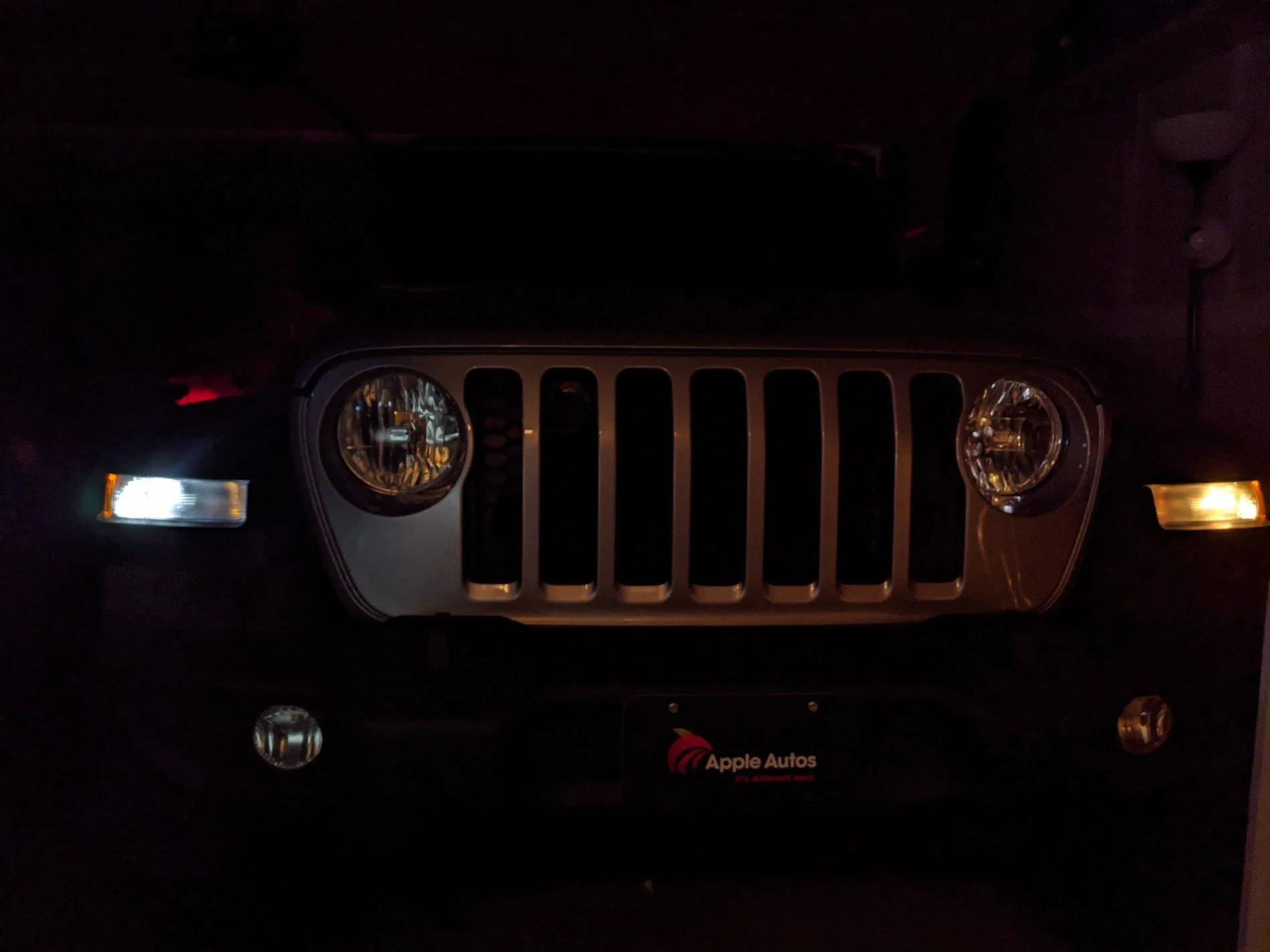

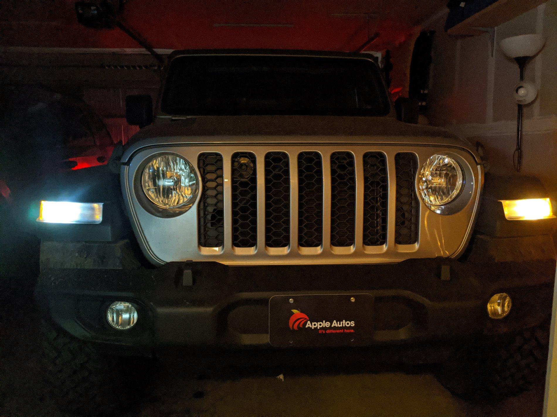

I read through this thread and decided to go the LED route. I didn’t use the lights listed by OP, but I’ll share my findings. I went with Sylvania Zevo White LED in the DRL and reverse lights. Cost $50 for all four.
First off was the reverse. They were plug and play. That simple. Zero issues. They were an obviously brighter white light, but I haven’t seen them at night, so output is TBD. Bulb number for my Sport S was 921. First photo shows LED left and halogen right. Second is LED in both.
Next is the DRL. I do have a Sport S, but a package my Gladiator came with added the upgraded DRL assembly. I have one bulb for blinker and another bulb for DRL. There is a side marker that is separate as well. The bulb number for the DRL was 7443. These bulbs were plug and play as well. They worked EXACTLY as the halogen bulbs did. They come on when AUTO is selected when headlights are on or off, when lights are turned to ON, when lights are turned to DRL only, when fog lights are on, etc. EXACTLY like the halogen lights. I say all that because when doing research I read that some LED bulbs that replaced halogen would only work on AUTO. These work just like they were factory except they look MUCH better.
Good luck to anyone who goes for this. You’ll not be disappointed. Now for headlights and fog lights!!:rock:
Thanks for providing the bulb #'s for the Sylvanias @Moe_Fugga, installed the same on mine and the fronts are much better. I wasn't able to get pics of the backup lights, but they do seem brighter and much whiter as well.
Pics of the front are below, shows a better comparison than pics I've seen on this thread. First pic is with the darkness slider on the phone adjusted a bit for more detail, second is more of what you can expect at night. You can see the light is brighter, and much more white in color. Hopefully it's evident the passenger side is the LED bulb.
