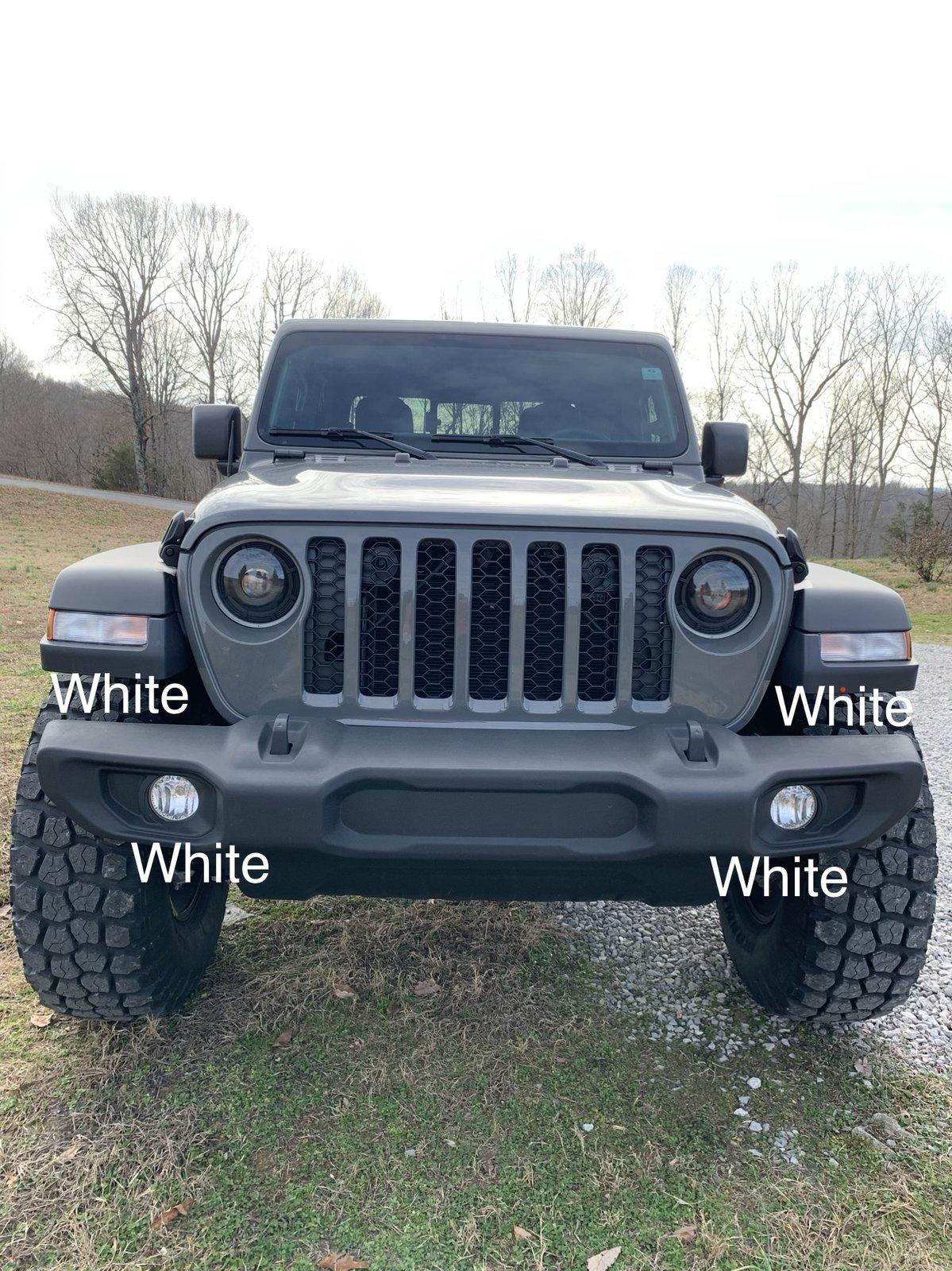

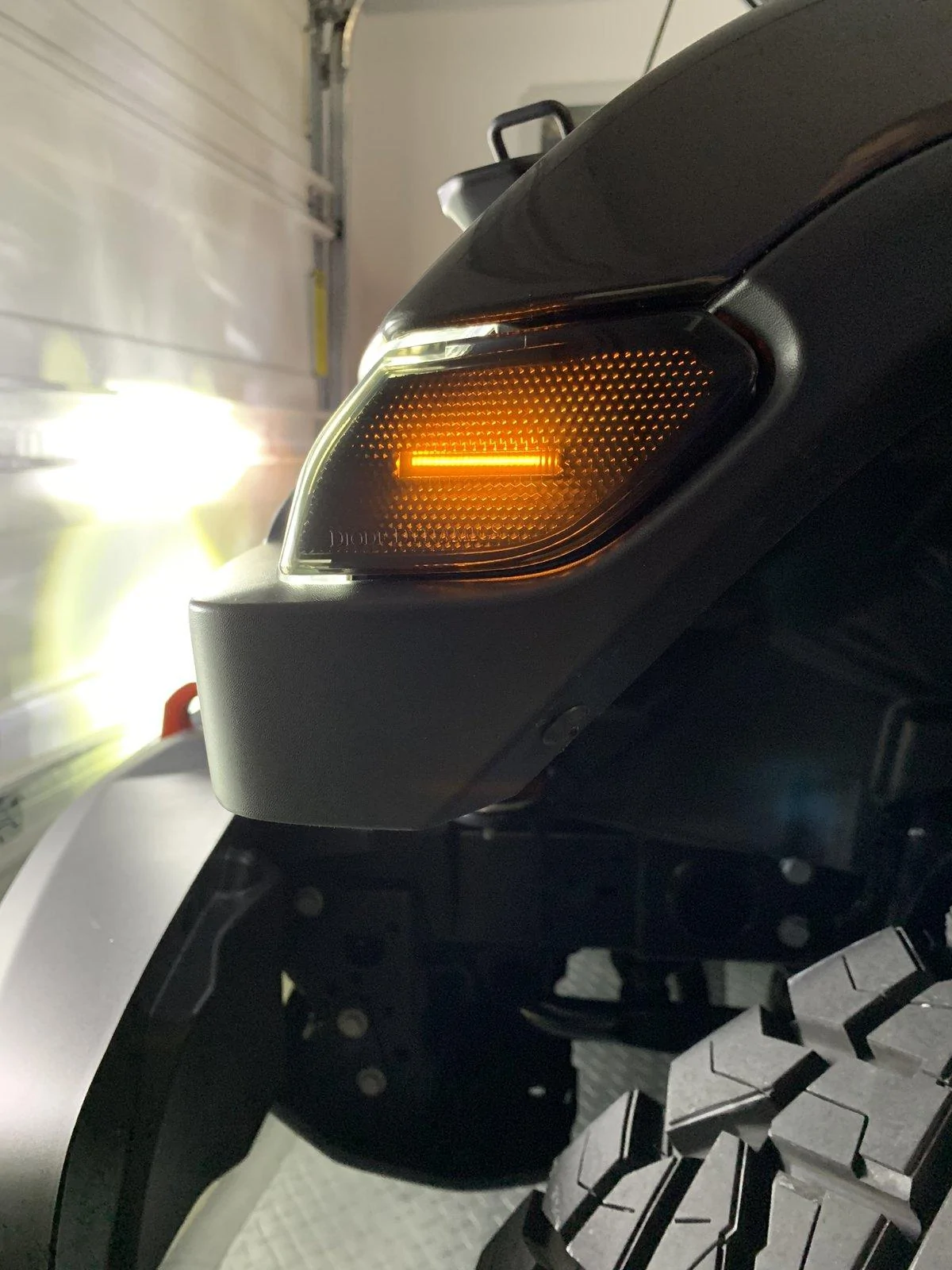

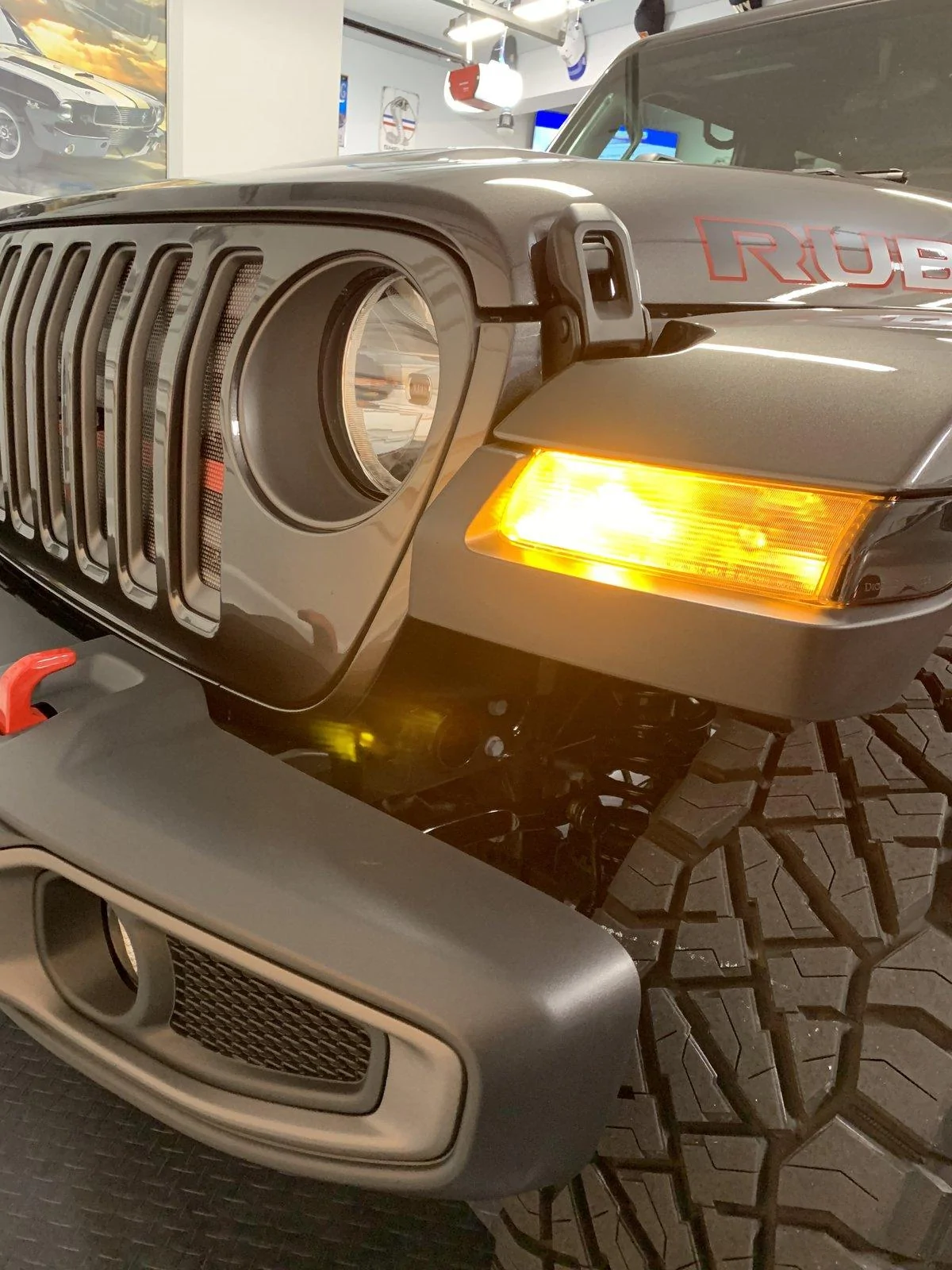

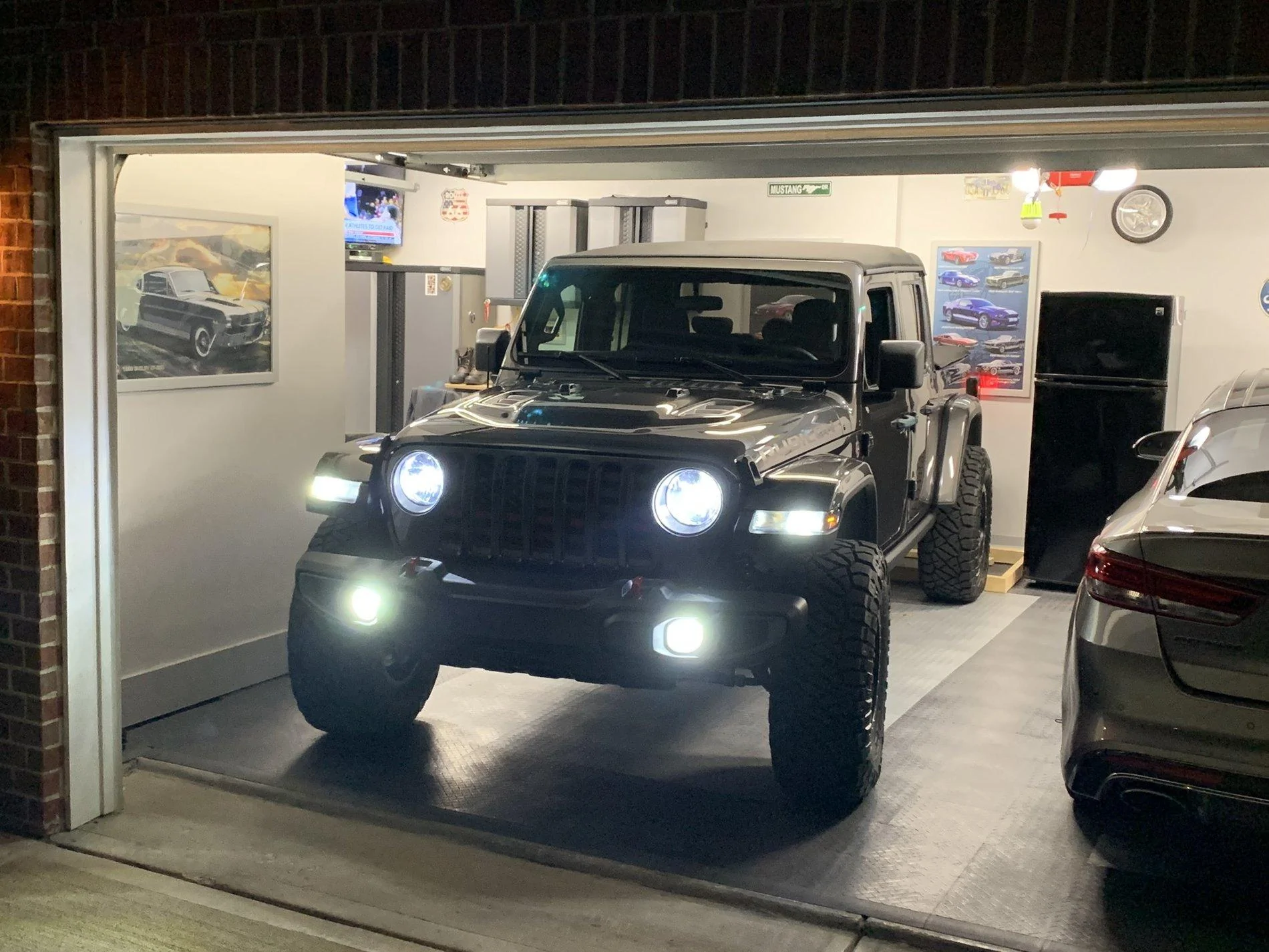

I’m lit, finally got around to installing them plus I added the Diode Dynamics side markers. These are awesome, so damn bright.
looks great... did you get the ones from the original post?
Do they change to amber? Judging by that one pic or is it just out of order and that was before...?
How is the diode dynamics working out? I am planning to do those as well and want to do it all at the same time. These will complement my Oracle oculus much better.

Yes, these are the ones from the original post. Not sure I understand your question but the turn signal is only Amber when activated otherwise it’s off and the DRL is on. DD side marker lights are fine, that pic is probably brighter than what they actually are.

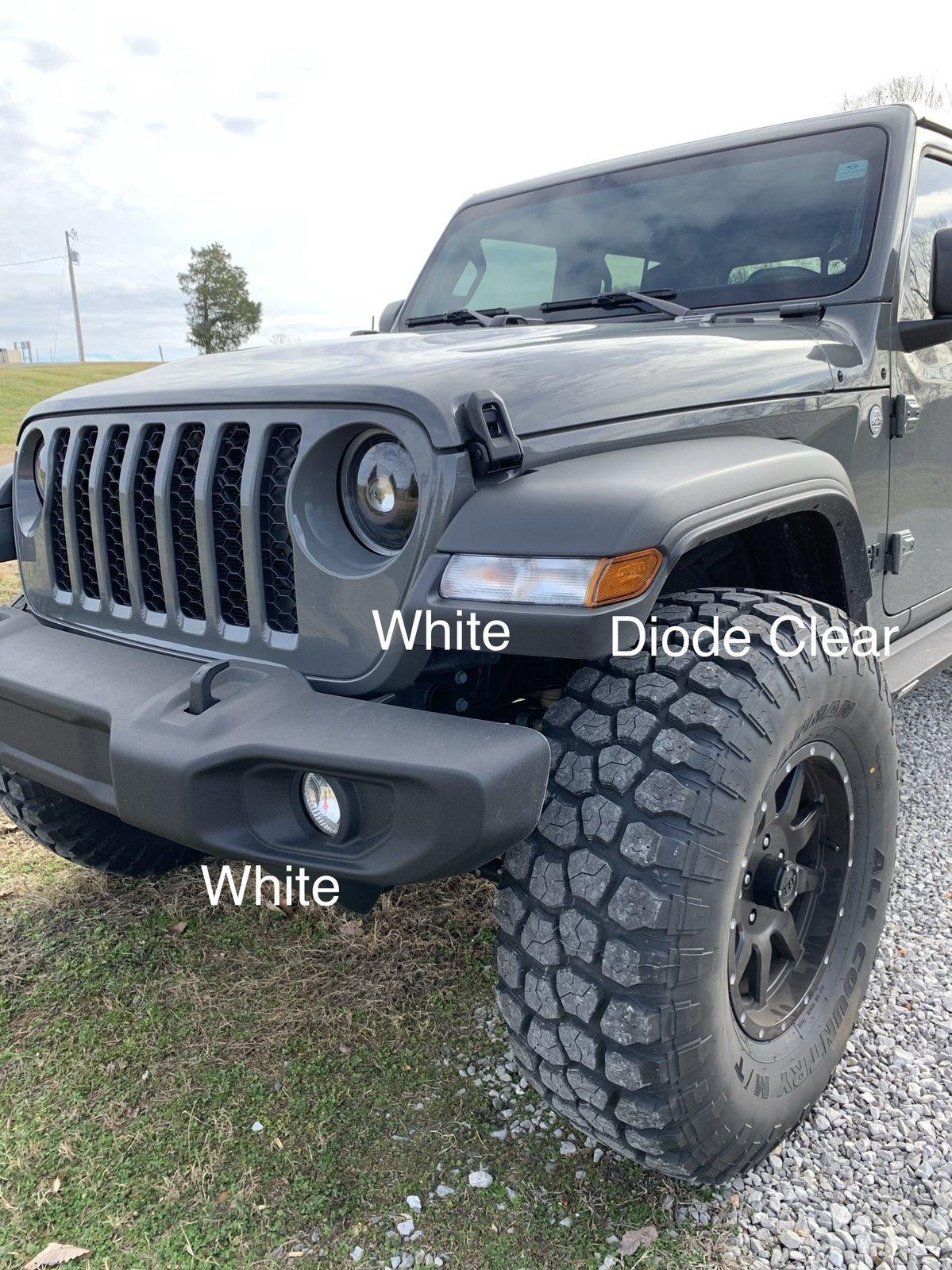

I was just wanting to do this... clear or amber diode and when I say white that could mean LED white... just considering the most economical way of doing this because I may change my fenders all together later on. I am curious about the daytime running lights on the max tow as well just trying to get everything to look appropriate to match the oculus headlights I have.
