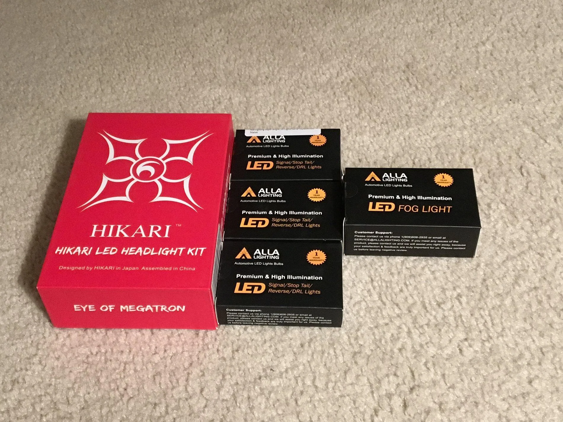

Did you guys do the original post ones or the Headlight Revolution ones. If I got to go the HR route I may just do whole replacements. If I can stay around a $100 it would well worth keeping the stock look on the jeep. Dealership is crazy for wanting what they want for the stock led ones. Money gimmick if you ask me.

original post
Jeep Gladiator LED Bulb Replacement - IT WORKS! 7BA668AE-A6B5-48F9-8115-1C5EAC73519F

As I mentioned I’ve had no issues, if that changes I will be going the HR route
