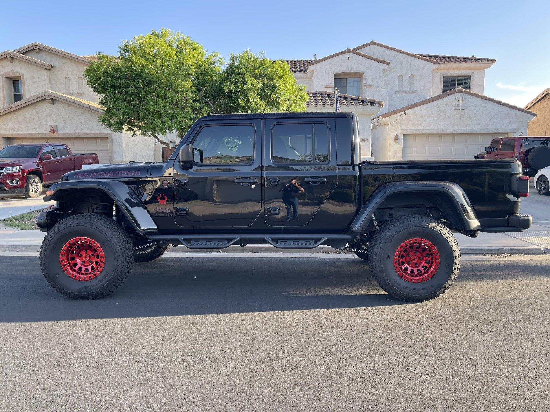

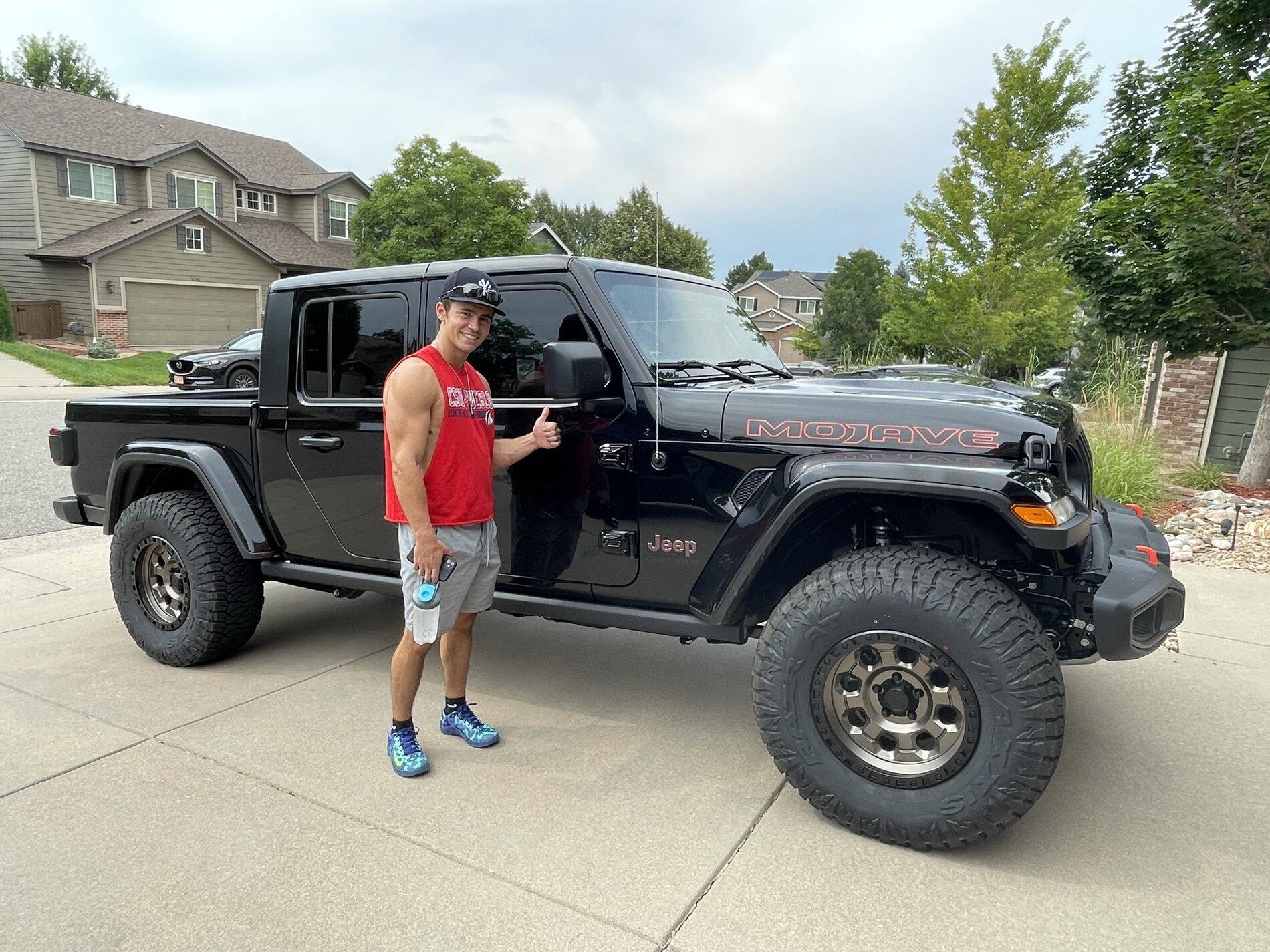

Got a shot from straight on down the side? I'm really curious to see how much tire poke you have. Thanks!
Sure thing! This is the best I got. I should get some looking down from the top because they do stick out a little more than what appears here.
Jeep Gladiator Lets see all those Gladiators with lifts and bigger tires! 20210827_065316

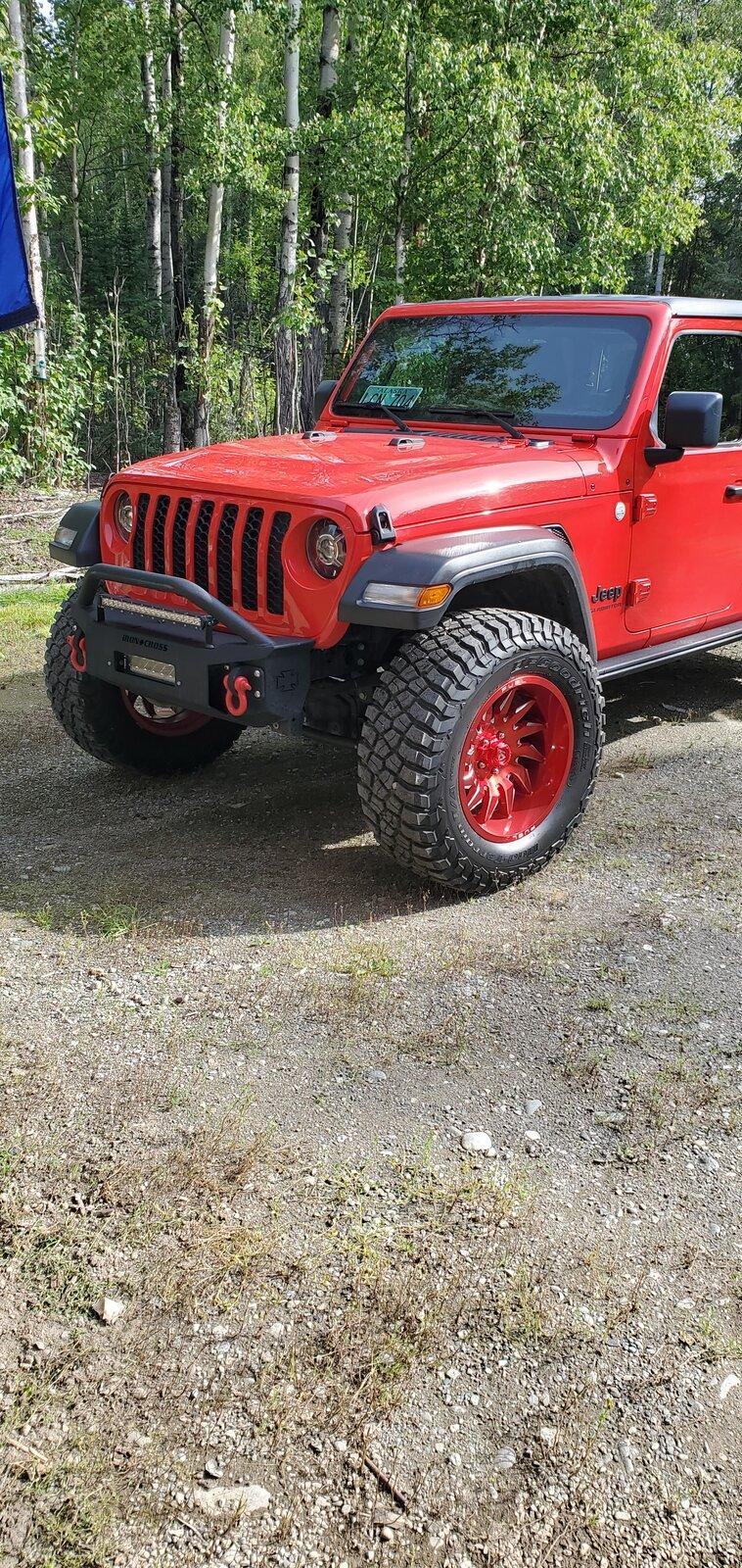

Did you regear? New axles? New drive shafts? New RCV shafts? Thanks! Looks. Awesome.

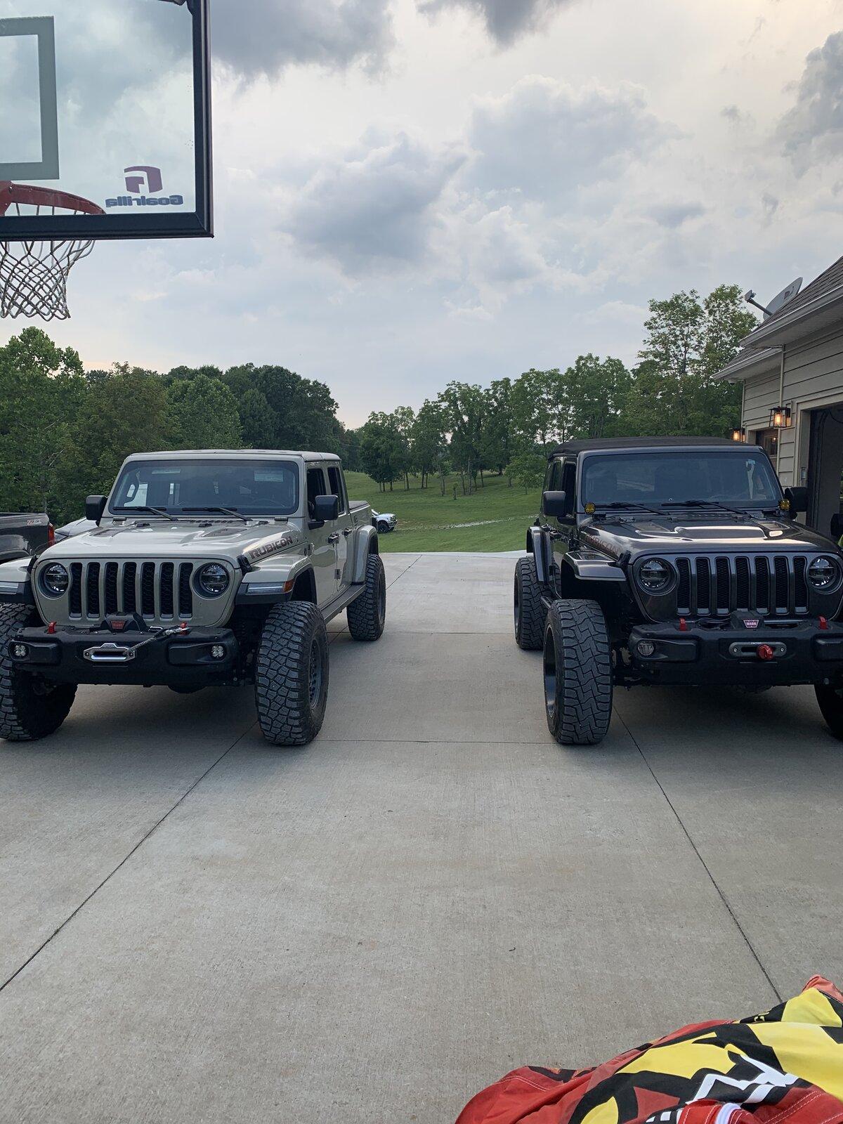

2020 Gladiator

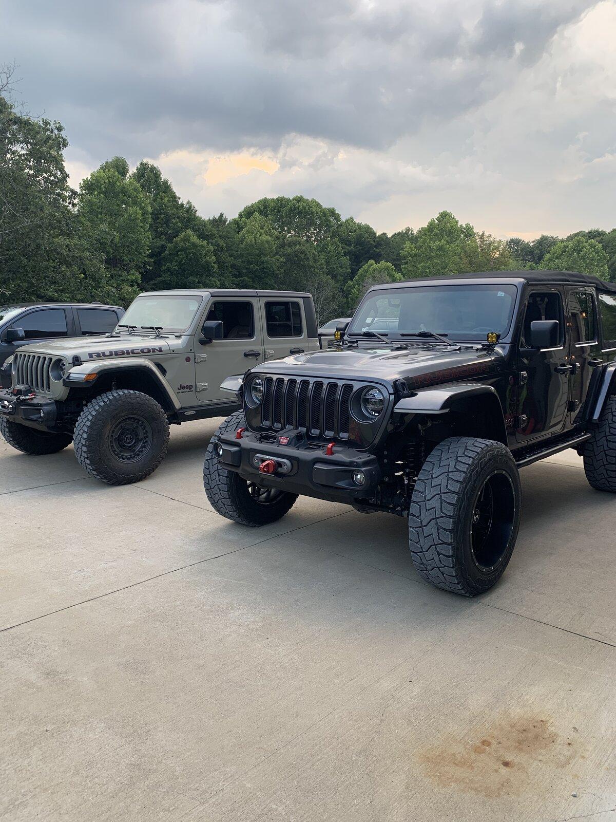

Mounted the Teraflex "Mojave Special" 2.5" lift and NITTO 37" (37X13.50R17) Ridge Grapplers (emphasizing 13.50 as opposed to 12.50 for extra burly). So, total lift is approaching the 4" mark (not accounting for tire size) due to the Mojave rolling off the line about 1" higher than a Rubicon.
Jeep Gladiator Lets see all those Gladiators with lifts and bigger tires! thumbnail_57827A39-DC03-4F74-9624-A81614F7BDEA
You have any rub issues with that setup at full stuff/turn?

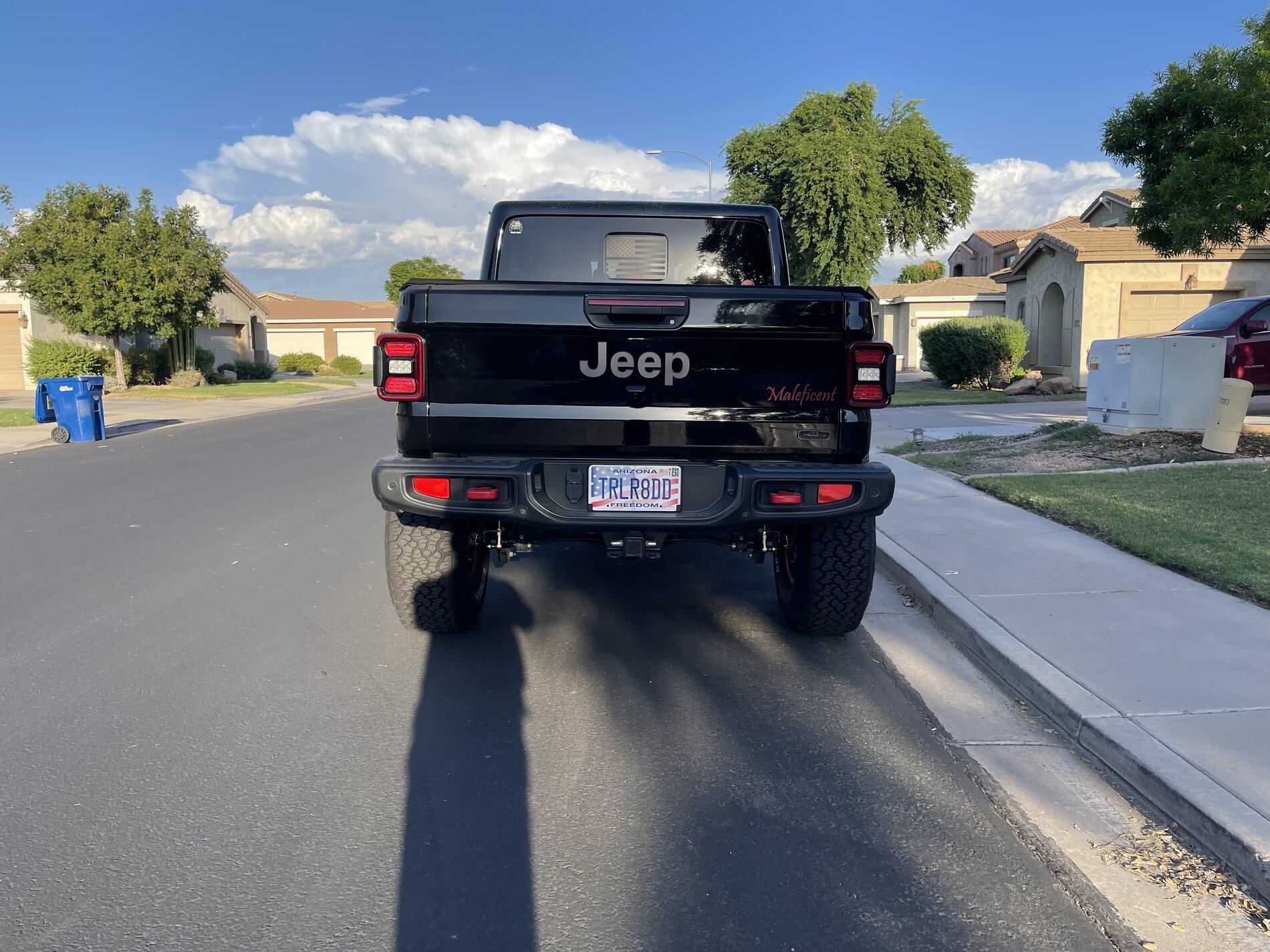

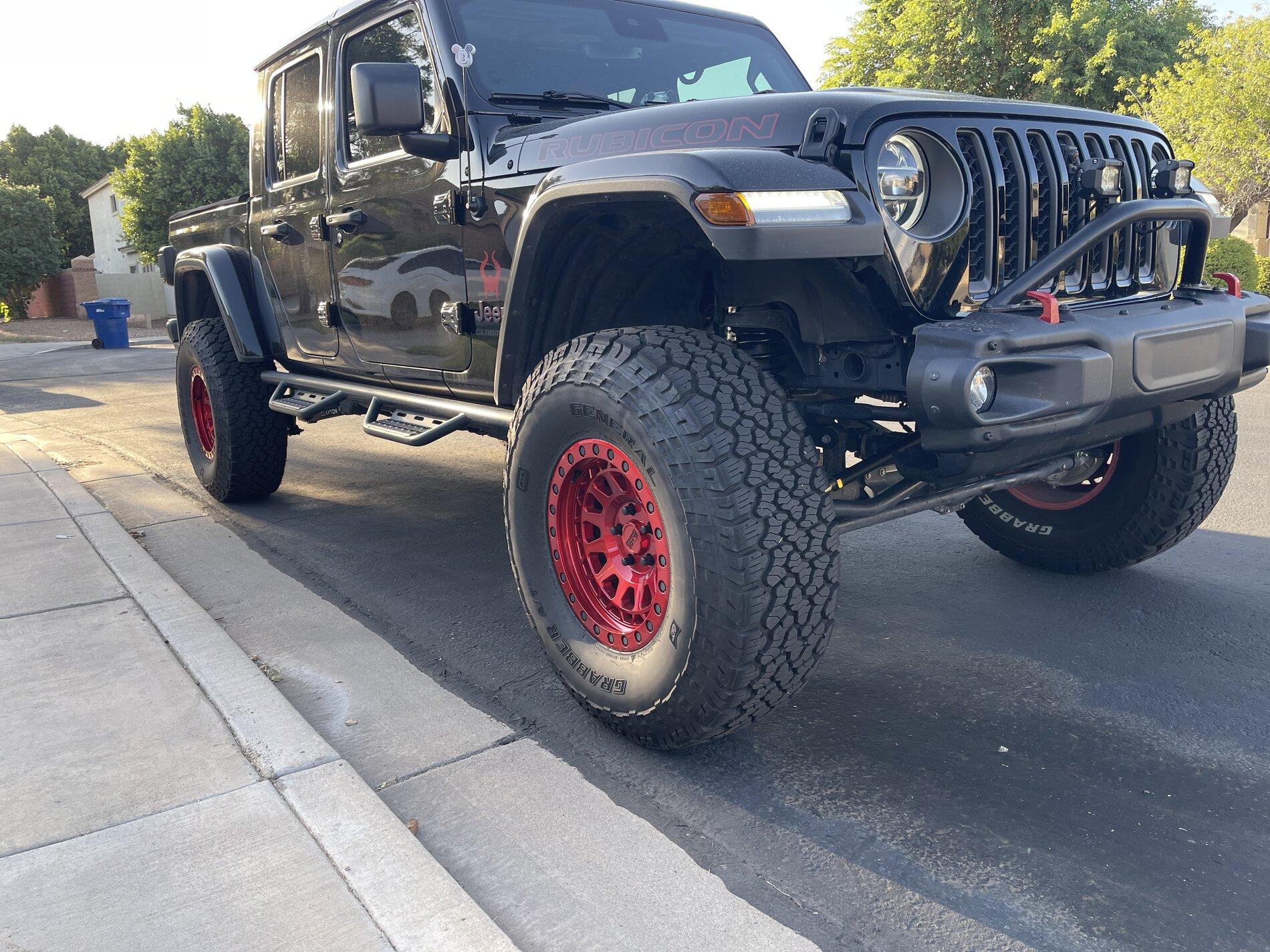

2020 Launch, 37.12.5.17 general ATx Black Rhino Primm 9” with 0 offset. Clayton 3.5” Offroad + with 1” Teraflex spacers up front. 4.10 gears run Great with 37’s
Jeep Gladiator Lets see all those Gladiators with lifts and bigger tires! C94FB706-66CF-4636-A858-F1FC9874B99F

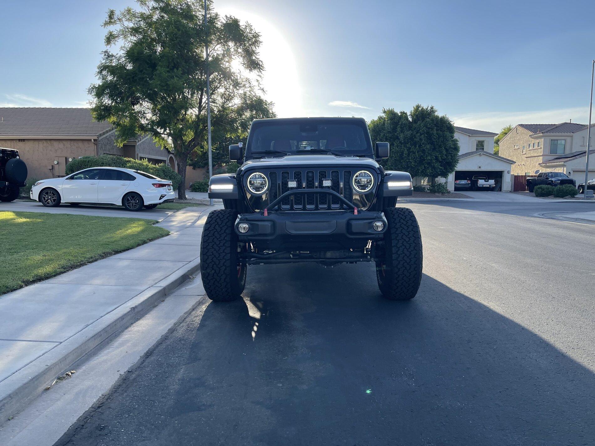

Before:
After:
I was told the Gladiator cant have any wheel smaller than 17s? Does a spacer solve this?
