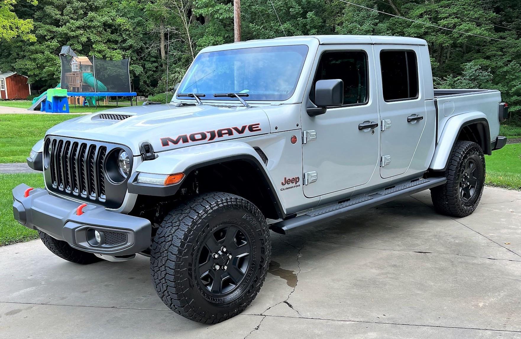

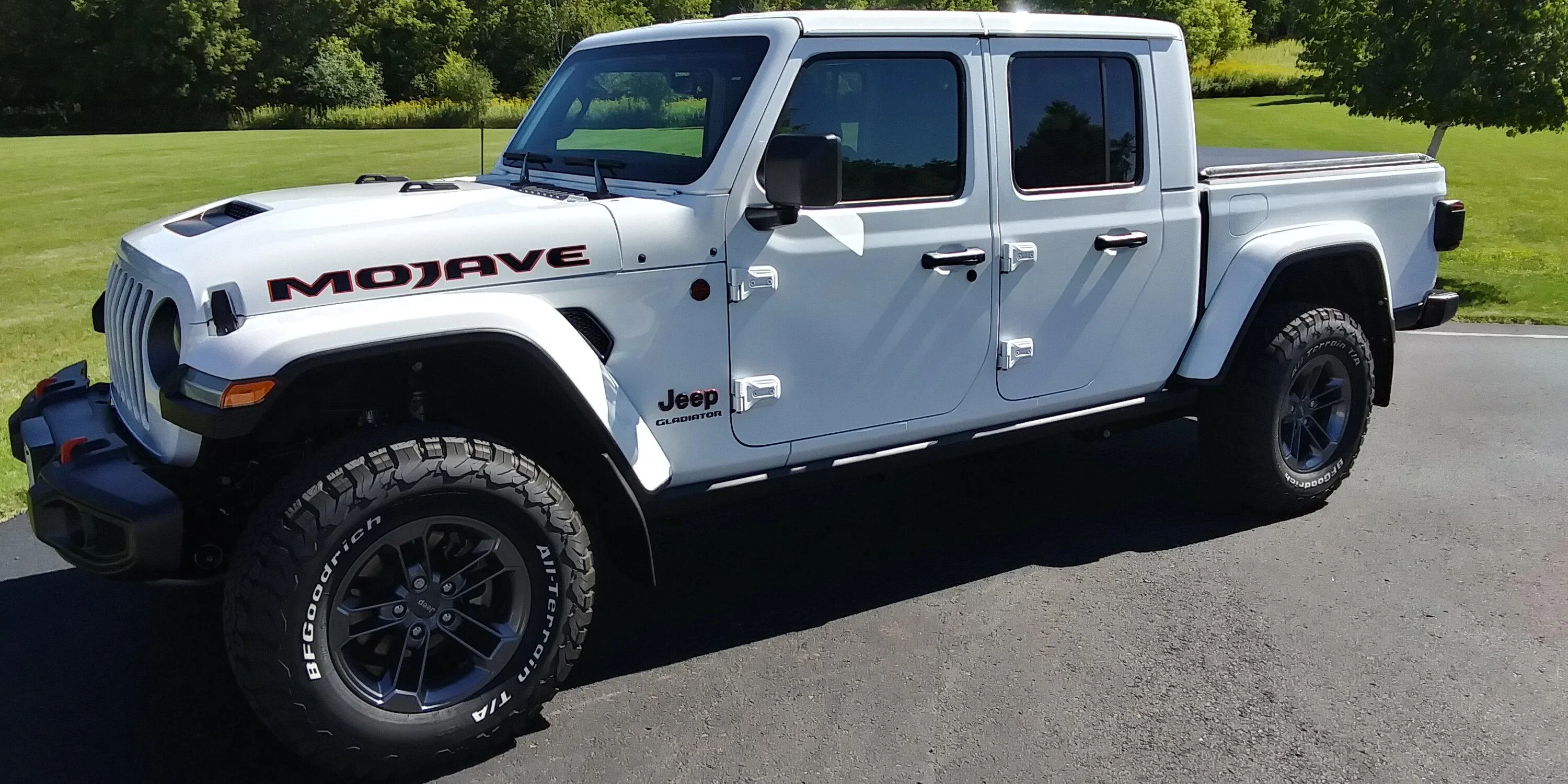

Also Factory Falken MT 285/70/17

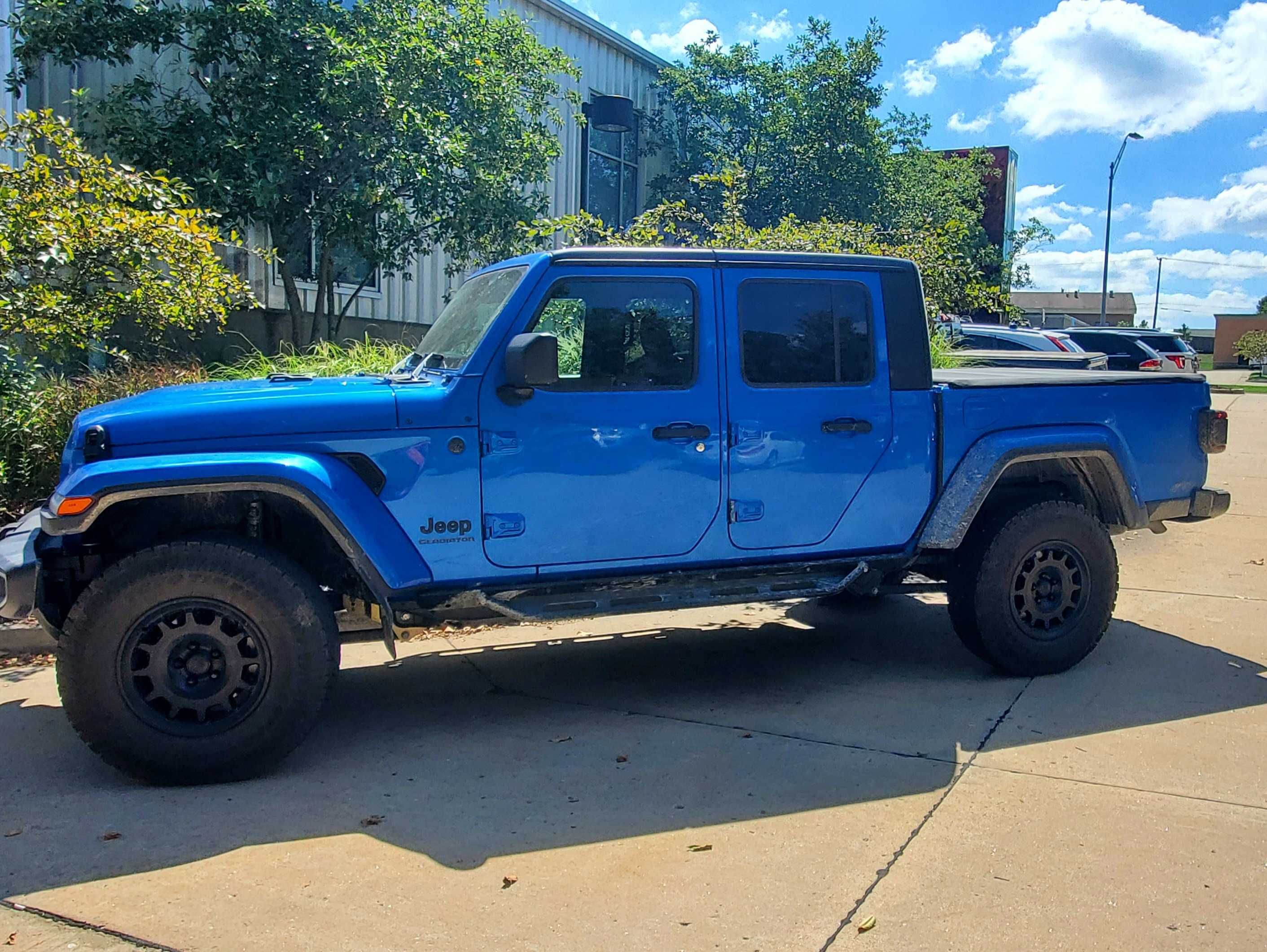

285/75 17 on AEV Saltas w/ 2" Mopar
This looks sick and just what I needed. I am trying to think about the long game. In the future i would like to put a 2" lift on and i wondered if the 34's would be lost in the wheel well. But this looks really good.

Thanks! I tried hard to find my ideal perfect combo. I didn't want to go with a lift larger than 3" or move up to a 35"/E rated tire. This was the right balance for me and should do everything I need it to do.
There should be more pics in my build thread if you want different angles.

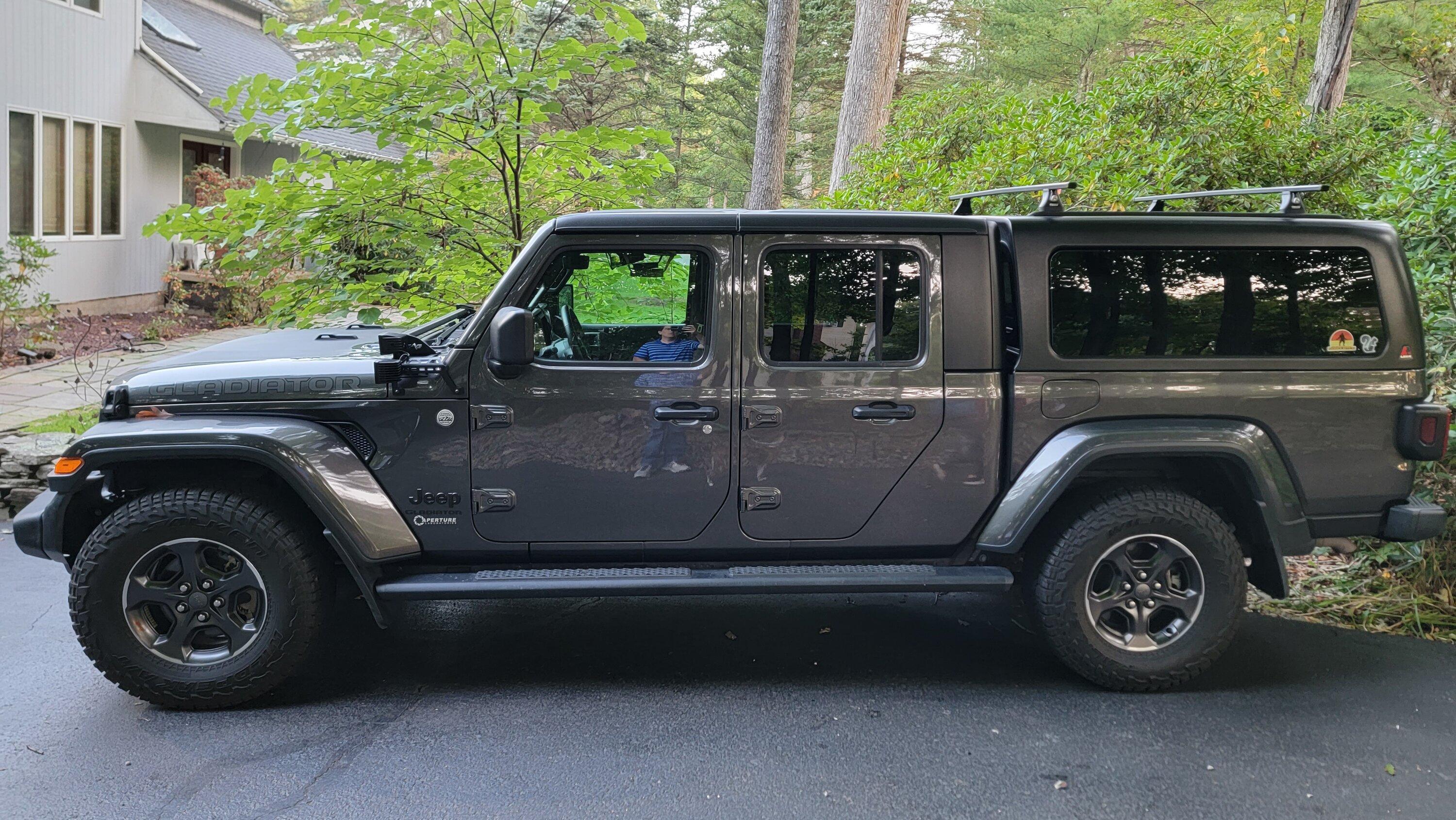

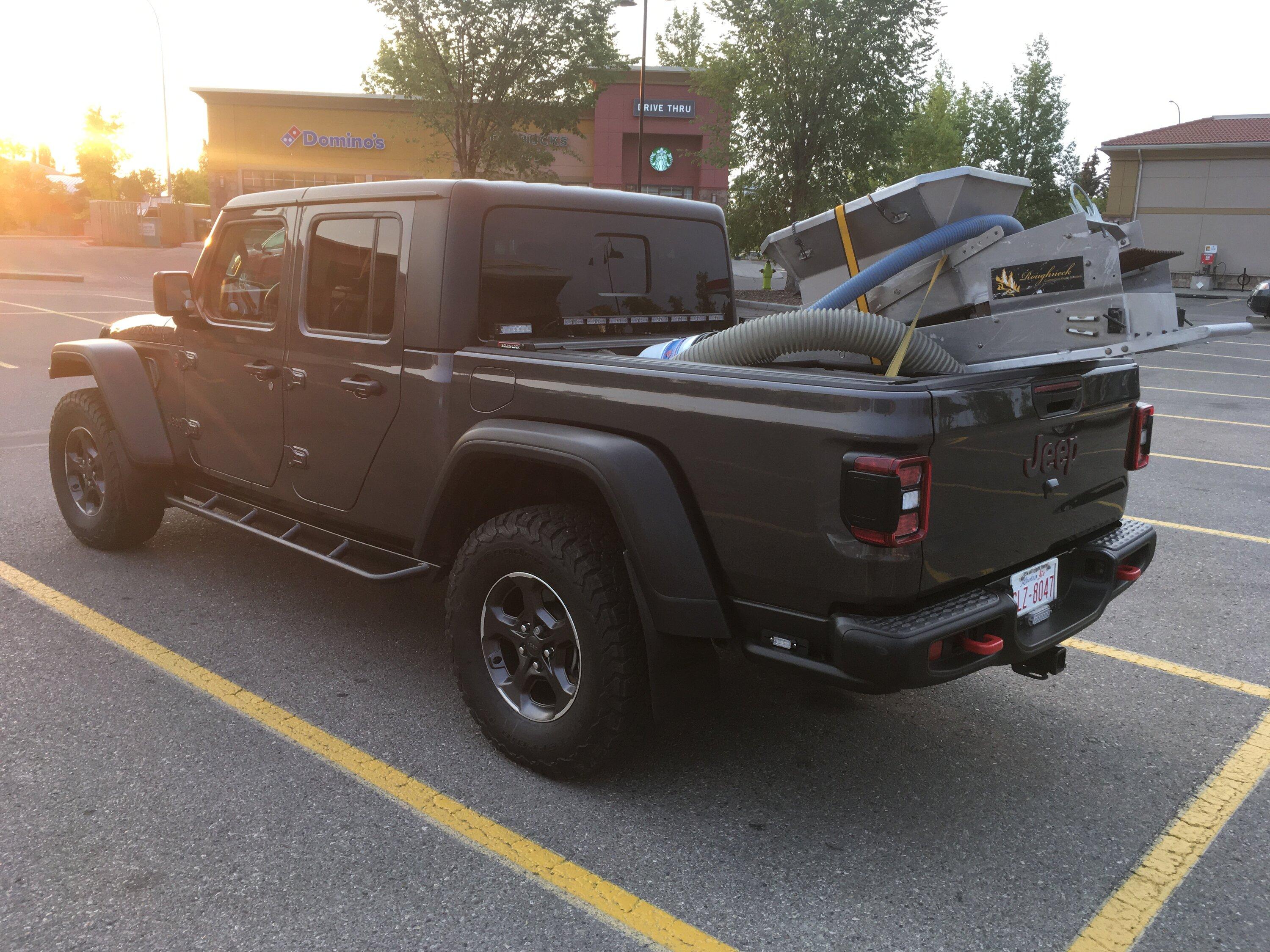

Any rubbing
Negative. None whatsoever. Certainly changes the vehicles dynamics, floats more, gets about 2mpg worse. You'll also want to to the size reprogram with a tazer , etc. ABS gets confused otherwise.
