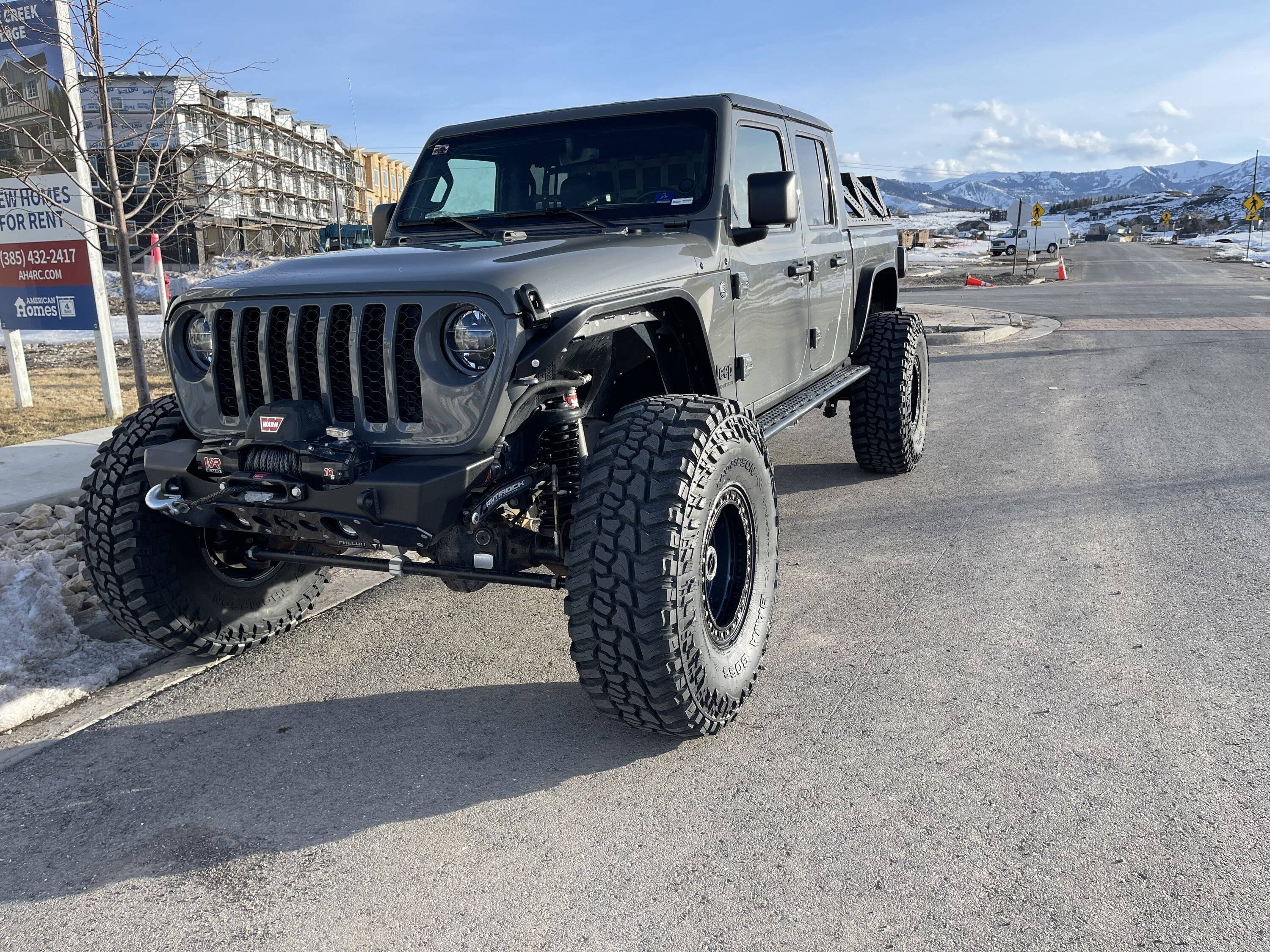

40s look killer. But now I have 315s and thinking about 37s. Looking at all the downs of going any bigger. Reprogram, gears, ram assist steering, performance and mpg, wear and stress on everything . From what I hear 315's is the limit without falling down the rabbit hole.
All true probably. If I had to daily drive this the truck would not be this big.

Man your truck just looks "TOUGH". It's crazy that even huge tires look at home on some Gladiators! I just went up to 37's and my truck looks badass, but there's something about the 40's!!
I've been noticing other lifted trucks lately (like Ford and Chevy/GMCs) and they look ridiculous to me because they have so much lift with small tires it looks just stupid. They can only fit like 35's at best "in" the wheel well, but most lift the truck so high the bigger tire isnt in the wheel well and the truck sits well above the frame looking stupid.
Thanks lovin the look too. I know what you mean about new trucks. Before the Jeep I had a Tundra with 12“of lift and a 3“ body lift on 40’s was definitely a big truck !

I wish my wife wasn't so short. I'd hate to see a side by side of those 40's next to my OEM tires on the Rubicon.
Not that you don't know, but a 40 from a 37 will only net +/- 1.5 inch step in height increase... Not trying to push you since 40's open the door for additional mods for reliability. If I lived on the west coast, which isn't going to happen, I may consider it, but realistically, 37-38 should get me anything I need.

40's mean that I don't fit in my garage anymore, and I don't want to give that up yet...so I'll be keeping my 37's.
Maybe just a bit more lift...
Yea I was happy mine fit by 1.5 inches in the garage.
