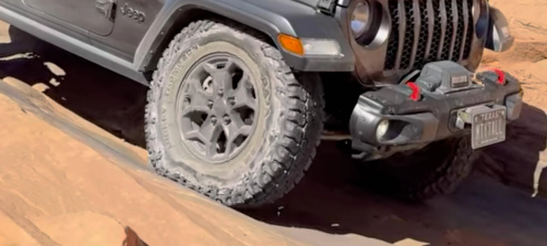

I also have a manual transmission. I went with the 255/85/R17 Mickey Thompson Baja Boss, and they feel near stock while driving around, on the stock rims. They are lighter than the 12.5 wide units by about 8lbs per tire. When I go off-road with them, I air down to 15psi, and they are super sticky, and are really good for extra traction. Daily driving, they are kept between 42-46psi, which was what Mickey Thompson recommended when I called to get optimum tire pressure. Yes it's high and the ride is a little rougher as they are E load tires. They are also really good in snow and wet conditions, zero slipping. I haven't regeared yet, but eventually will to 4:88 when I add lockers. Hope that helps
After doing more research I think this may be the tire for me. Are you on stock wheels? I thought beadlocks were required to air down that much off road. Happy to be corrected.
I have stock Launch Edition Rubicon rims, 7.5" width. Here's the video that helped me make my decision. Very informative. As you can see by my photos, those tires "caterpillar" very well on low psi. I wouldn't go lower than 15psi though, as you're more likely to pop a bead.

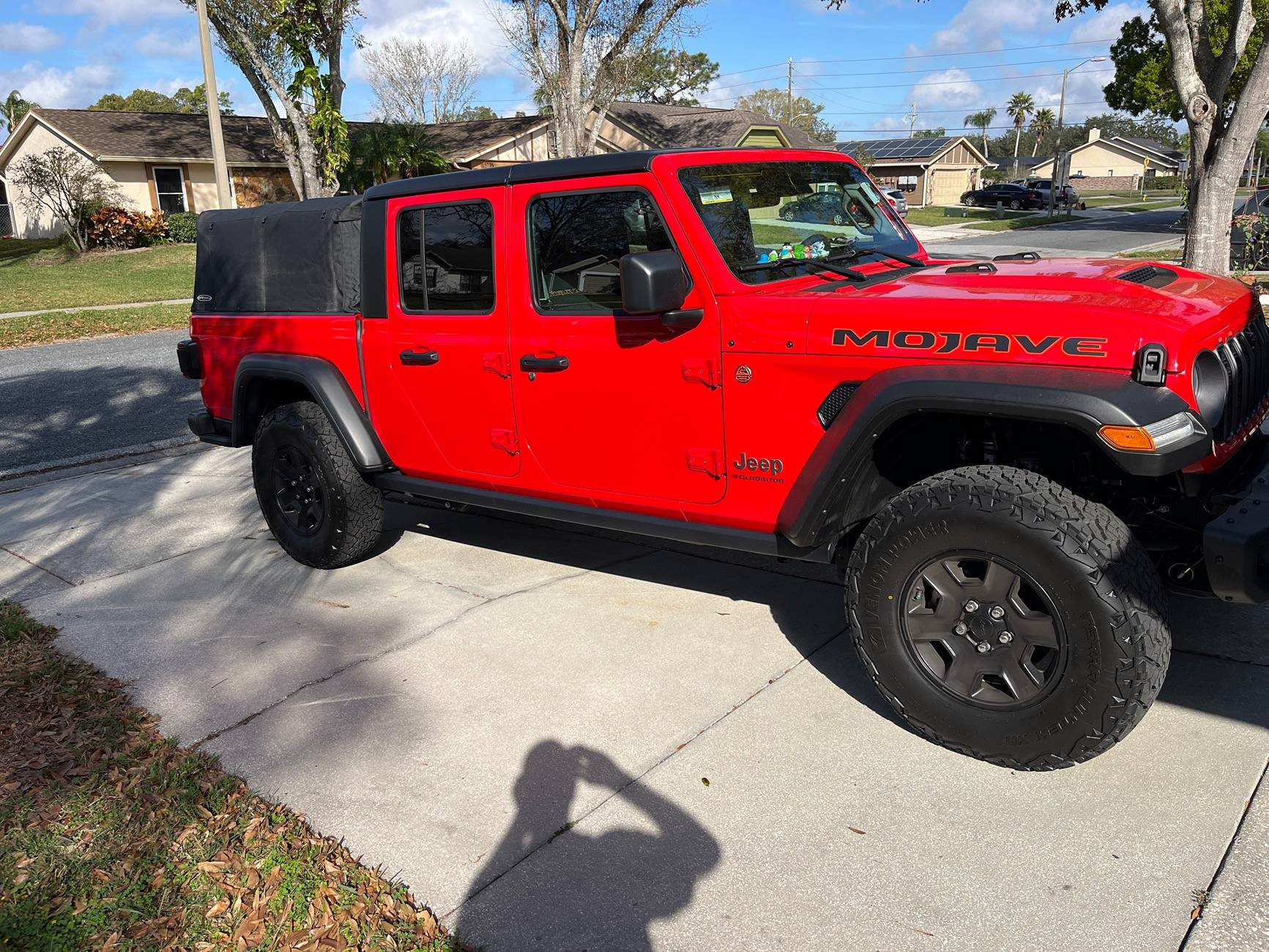

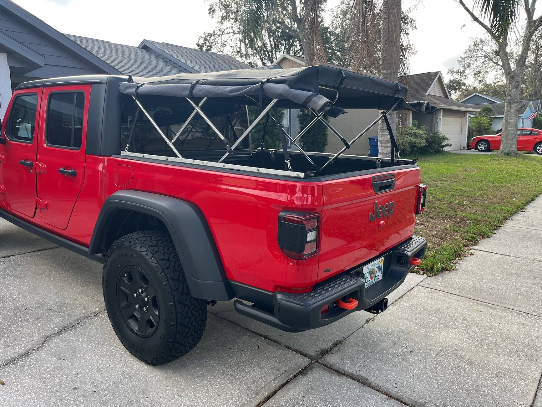

I guess model of tire isn't what I'm looking for advice for. Just size. If I'm getting a bigger tire (either the 34" 285/75/R17, or 35x11.5x17) that weighs about the same or in some cases less than my heavy mud tires, what am I realistically looking at in terms of the change to my day to day use (acceleration, gearing, mpg, torque loss etc).
I went with the Venom Power TerraHunter’s in 35x10.5x17
load range E AT’s. Way quieter than the WildPeak MT’s

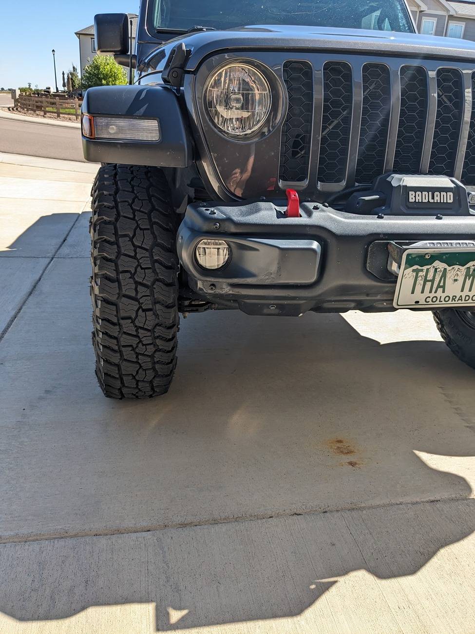

Do you notice any rubbing with stock wheels? I want to put these on my stock Rubicon wheels but I want to avoid needing to lift or regear and keep my setup as stock as possible. My planned mods are new tires, a winch on the factory steel bumper and that's it.
No rubbing, whereas the wider stock Wildpeaks did against the lower control arm at full lock. I have a Sport S, so a narrower axle than a Rubicon. A mild lift would keep it out of the fender a little more, but it flexes well at full stuff without significant rubbing. I'm running 1.5" spacer lift all around on Rubicon suspension takeoffs. I run old-school 5-tire rotations, so the spare is a matching rim. I'm running stock 3:73 gearing, and barely use 6th even with the old Wildpeaks. A throttle controller will bring back some life, and the clutch recall if you haven't done it already.
Here's some photos fitted to a stock 2024 Rubicon like yours (Post 37) - Mickey Thompson Baja Boss AT 255/85/17 (35" Pizza Cutters). | Page 3 | Jeep Gladiator (JT) News, Forum, Community - JeepGladiatorForum.com
